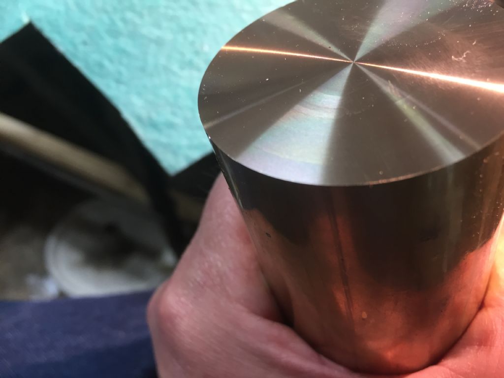

      This is a bit of an academic question really, but I am intrigued.
      Facing off a 2" brass bar this evening I noticed this pattern:
      It's not a great photo (best I can do with my 'phone) but you will perhaps be able to see five distinct 'zones' going in from the circumference to the centre. The boundaries are very well defined – it's not at all like the effect one sees with tool chatter or that sort of thing.
      I did wonder if it might be purely an optical effect – at certain angles there are diffraction patterns:
      which seem to coincide, roughly at least, with the 'zones'
      I'd be interested to hear any opinions.
      The question is academic because the part will eventually be polished, but I'd like to know what's going on.

                  #555660
                    Posted by Robin Graham on 24/07/2021 22:42:40:
                    That second photo is particularly disconcerting, because it looks like a rainbow … with the sequence of colours inverted.

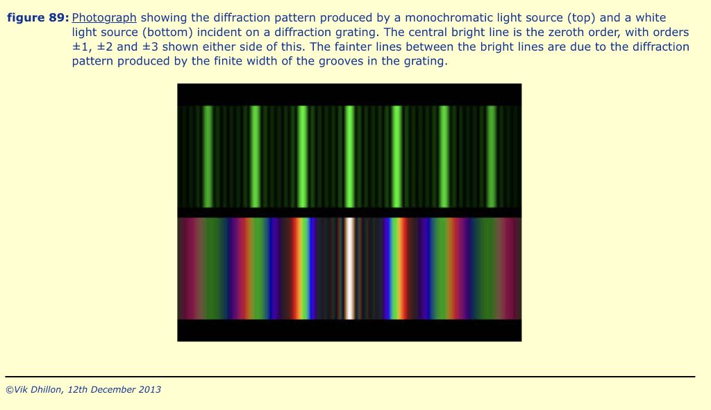

                          There is no real reason to assume that the groove size varies, Howard
                          A diffraction grating will produce the full visible spectrum from white light.
                          Ref: http://www.vikdhillon.staff.shef.ac.uk/teaching/phy217/instruments/phy217_inst_grating.html
                          The photo at the bottom of that page ^^^ is an excellent illustration.

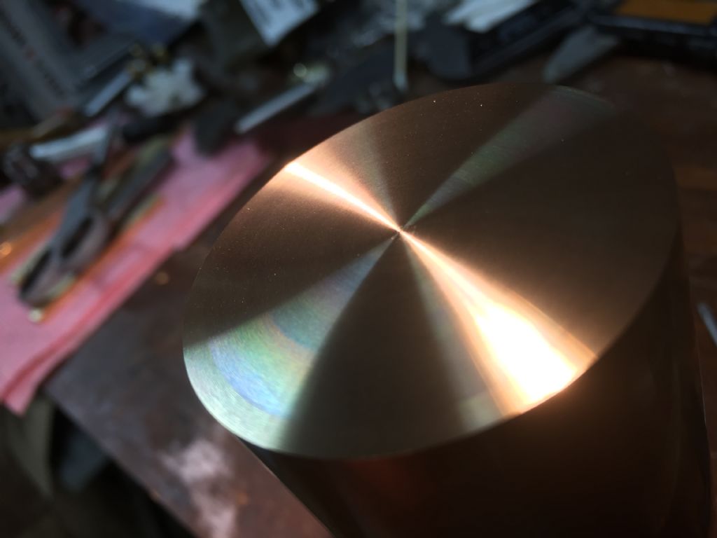

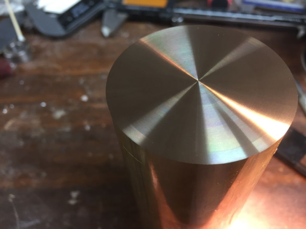

                                      Robin Graham
                                        @robingraham42208
                                        Thanks for replies, and apologies for not getting back to this sooner – my wife has taken on a foster dog so I've been in woodworking mode making stair gates. C'est la vie!
                                        William – many thanks for the info about Whitaker rings. I'm not convinced that's what going on here though – brass, very light cuts (~10 thou) slow feed. But maybe – and valuable info even if it isn't.
                                        Bob Stevenson – I was initially sceptical about 'stages of resonance', but changing the spindle speed from 550 to 700 rpm gave different 'zones':
                                        and returning to 550 gave results broadly similar to my first photo:
                                        So it's mechanical. I think I understand what's going on now.
                                        On the optical effects, I found, unsurprisingly in retrospect, that the 'spectrum' was very much dependent on camera and lighting angles. Thanks Martin.
                                        I doubt that I can get much further in understanding optical effects without specialist kit – a trichroic beam splitter would be an absolute minimum requirement I expect. Sadly , I haven't got onewink.
                                        I should just be happy that I can get this finish on a mass-market hobby lathe.
                                        Robin.

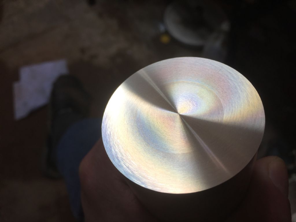

                                            Posted by Michael Gilligan on 25/07/2021 22:38:10:
                                            Ref: **LINK**
                                            For anyone who might be interested, but didn’t follow that link … here is the referenced photo:
                                            The ‘double rainbow’ group at lower-right of the picture bears [shall we say] a striking similarity to the pattern that Robin photographed.
                                            Sorry, I can’t be bothered distorting the picture to get the curvature … but it doesn’t take much imagination
