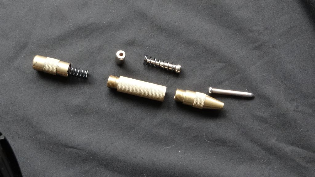

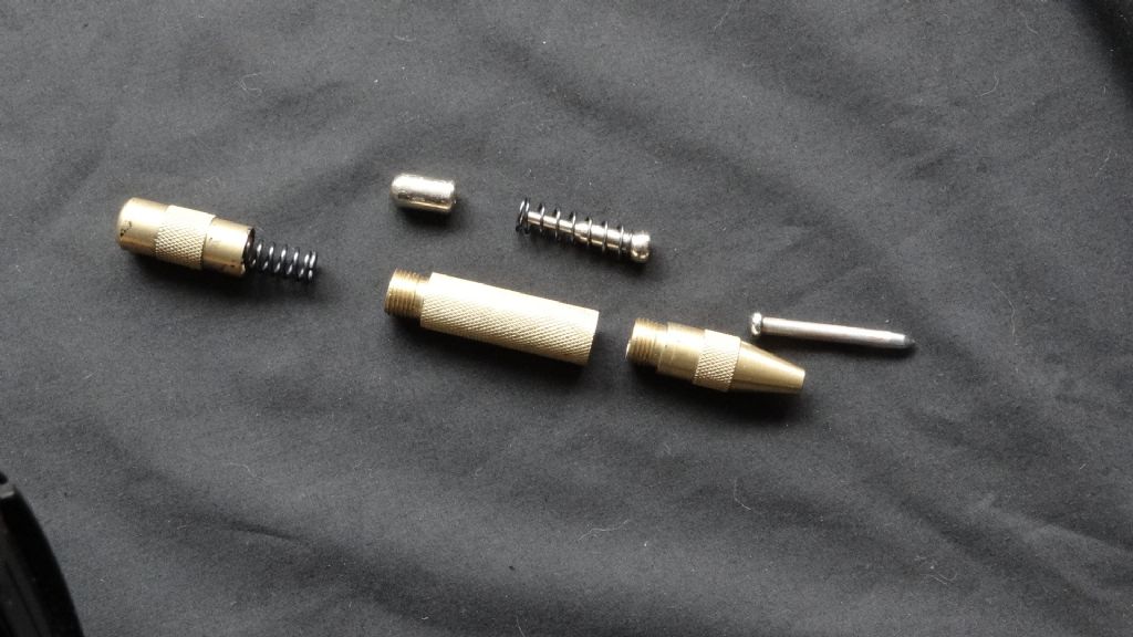

                                  I wonder if the "ball bearing" was actually the bullet-shaped trigger cam wotsit. In my version of the punch, it's the silver cylinder with one end rounded and a hole drilled in the other. (Component is top left in both pics.)
                                  When I took the punch apart yesterday bits flew about. Today it's completely tame. Very strange.

                                          Well ! what a response, I did see something about Eclipse Auto Punches somewhere (sorry but my M&W 280 was my main concern so did not bookmark the page) the missing part is most likely the little detent spring Richard S2 mentioned, one bloke found a spring that fitted and got his working ok, in my case I hope the ball is a standard size, I have had a look at Moore & Wright's website but could find no reference to the 280 at all and of course obtaining a couple of replacement balls from them and sending them to Australia to boot, a comedian could develop a very good joke out of that!
                                          Martin King 2, are the M&W centre punches in your collection (dare I say it) all minus their balls, if not could you as was suggested pull one apart in a plastic bag so you could measure a ball? I have checked out any old ball races I have in my workshop but all too big, not sure yet what local suppliers carry, I can buy a replacement auto punch made in China but it is against my engineering principles to have a first class tool out of action because of my momentary stupidity, might be time to make a ball turning attachment and tackle some silver steel then harden the right sized ball when found, then I can post the size here!

                                            I don't know if you ever got an answer or if you made your own ball but I've just taken my Moore and Wright 280 punch apart and the steel ball is 3mm in mine.

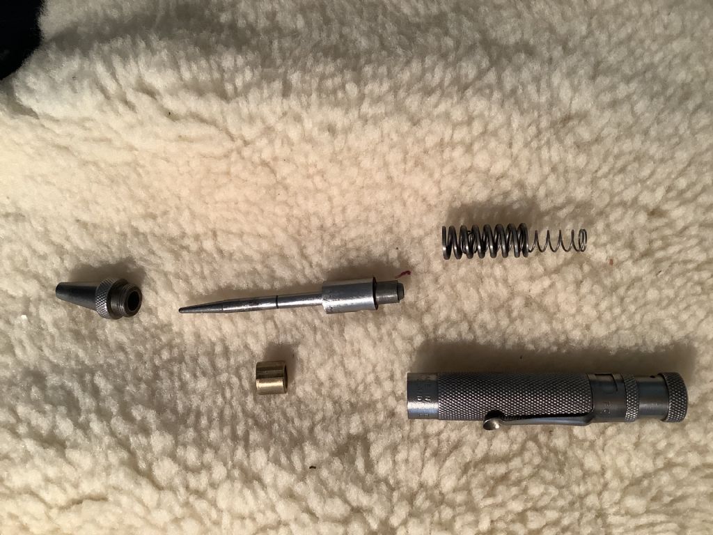

                                              Hello, sorry to bring up an old post. I recently inherited an Eclipse 171 which is not working. Going on the above picture I am missing a spring? The other puzzle is that there is a brass ferrule that has internal thread that appears to be somewhat larger than the pin that is secured in the top half. I also seem 5o be missing the collar with the two holes as pictured above? Where to from here pls? Anyone advise where I might source the missing parts?

                                                  G'day Mike only just checked this forum again and saw your post from 21/04/2020 !! thank you very much for measuring your part, I have checked out all possible sources here in Hervey Bay and discovered to my dismay the only ball bearings they have close in size are 1/8 inch, no metric sizes carried in stock!, Australia has been metric for quite some time now go figure?? anyway I tried lapping down a 1/8 inch ball in a primitive way but it kept jamming so bit the bullet and ordered the smallest quantity of 20 3mm balls from ebay, just have to wait till they get here, again thanks for the effort, much appreciated and I hope you get to see this post
