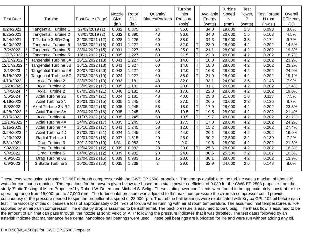

            I have been curious why the rotor velocity coefficient found for Tangential Turbine 5B is so much lower than the rotor velocity coefficient found for Tangential Turbine 5C even though they were determined using the same methods described in the posts starting with 23/03/2023 Post. The rotor velocity coefficient found in these posts for Tangential Turbine 5B was 0.27. Using the same methods for Tangential Turbine 5C starting with the 31/03/2023 Post, the rotor velocity coefficient was found to be 0.51. This is a very big difference for the same rotor. Only the nozzles are different for these turbines. Tangential Turbine 5B had a nozzle size of 0.041” (1.00mm) and Tangential Turbine 5C had a nozzle size of 0.024” (0.61mm). I think that the leakage by the rotor due to the concave shape of the edge of the pockets is causing the problem. I tried various section views to show this, but the following images of the solid models of these turbines illustrate it best. The views are looking through the nozzles at the rotor that is highlighted in an orange color. The first image is the smaller nozzle and you can see that there is very little opening not covered by the rotor. The second image is the larger nozzle and approximately ⅓ of the nozzle is not covered by the rotor. It is probably the flow loss that is causing the large reduction in rotor velocity coefficient with the large nozzle. The flow exiting the nozzle deflects toward the rotor from 1 to 6  degrees according to my sources of information.  This would probably be enough to almost eliminate the flow loss for the smaller nozzle but the larger nozzle would still have quite a high mass flow escape.

            #661197
            Turbine Guy
              @turbineguy

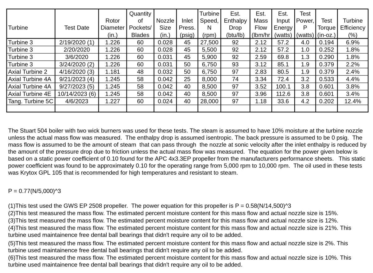

              I have done very little testing of Axial Turbine 4A on steam, so I ran a test yesterday on steam using my Stuart 504 boiler. I used the APC 4×3.3 propeller since it is the smallest propeller I have that is not overpowered by this boiler. I added the results of this test to the test sheet shown in the 26/05/2021 Post. I stated in that post that the torque shown for the other turbines appeared to be too high. The test with Axial Turbine 4A found a torque even larger than these turbines by an amount that appears to be consistent with the higher efficiency of this turbine and indicates the torques shown in this table appear to be correct. I made the Velocity 1 spreadsheet for Axial Turbine 4A running on steam shown below. The mach number, pressure drop due to friction in the nozzle, and clearance were lower with steam than with air so I recalculated the nozzle velocity coefficient. I estimated the nozzle velocity coefficient of Axial Turbine 4A to be approximately 0.88. This velocity coefficient was determined by starting with the velocity coefficient of 0.93 for the conical nozzle as explained in the 29/03/2023 Post then finding the reduction for the pressure drop due to friction. The reduction due to pressure drop was 0.98. This reduced the nozzle velocity coefficient to 0.91. I then found the reduction for expanding to supersonic velocities with a converging only nozzle shown in the diagram in the 29/03/2023 post as line A. The Mach number for Axial Turbine 4A was 1.3 and the reduction for expanding supersonic is approximately 0.98. This reduces the nozzle velocity coefficient to 0.89. The last reduction was for the distance between the nozzle outlet to the rotor. This was 0.010” for Axial Turbine 4A and the correction is 0.99 for this distance. This reduces the nozzle velocity coefficient to 0.88. I kept the same rotor velocity coefficient used for Axial Turbine 4A in all the other velocity spreadsheets and once again the estimated torque was quite close to the actual test torque.

                I made another steam test with Axial Turbine 4A and the Stuart 504 boiler and added it to the test sheet shown in the last post. I did two things differently with this test. I installed the wick burners on the opposite end of the boiler and closed the opening on the other end. This forced the flame to move down the entire length of the boiler before going out the exhaust. The single wick burner that originally came with the Stuart 504 boiler was much longer than the two wick burners that replaced it after it started to leak. I also slowly opened the valve on the boiler keeping the pressure at 40 psig (2.7 bar) until the turbine got hot enough to maintain this pressure with the throttle almost fully open. This raised the energy level in the steam quite a bit resulting in the steam being almost completely dry. The net result was the power increased only slightly higher than the last test even though the energy level was higher and the steam was drier. This was caused by no space for the steam to expand to a higher Mach number before contacting the rotor. Running on air at very low pressure the velocity exiting the nozzle was almost sonic and the maximum efficiency occurred keeping the clearance on each face of the rotor very small. Werner Jeggli used a thick gasket to get the space needed for the steam to expand to a higher Mach number and that is what I will try next.

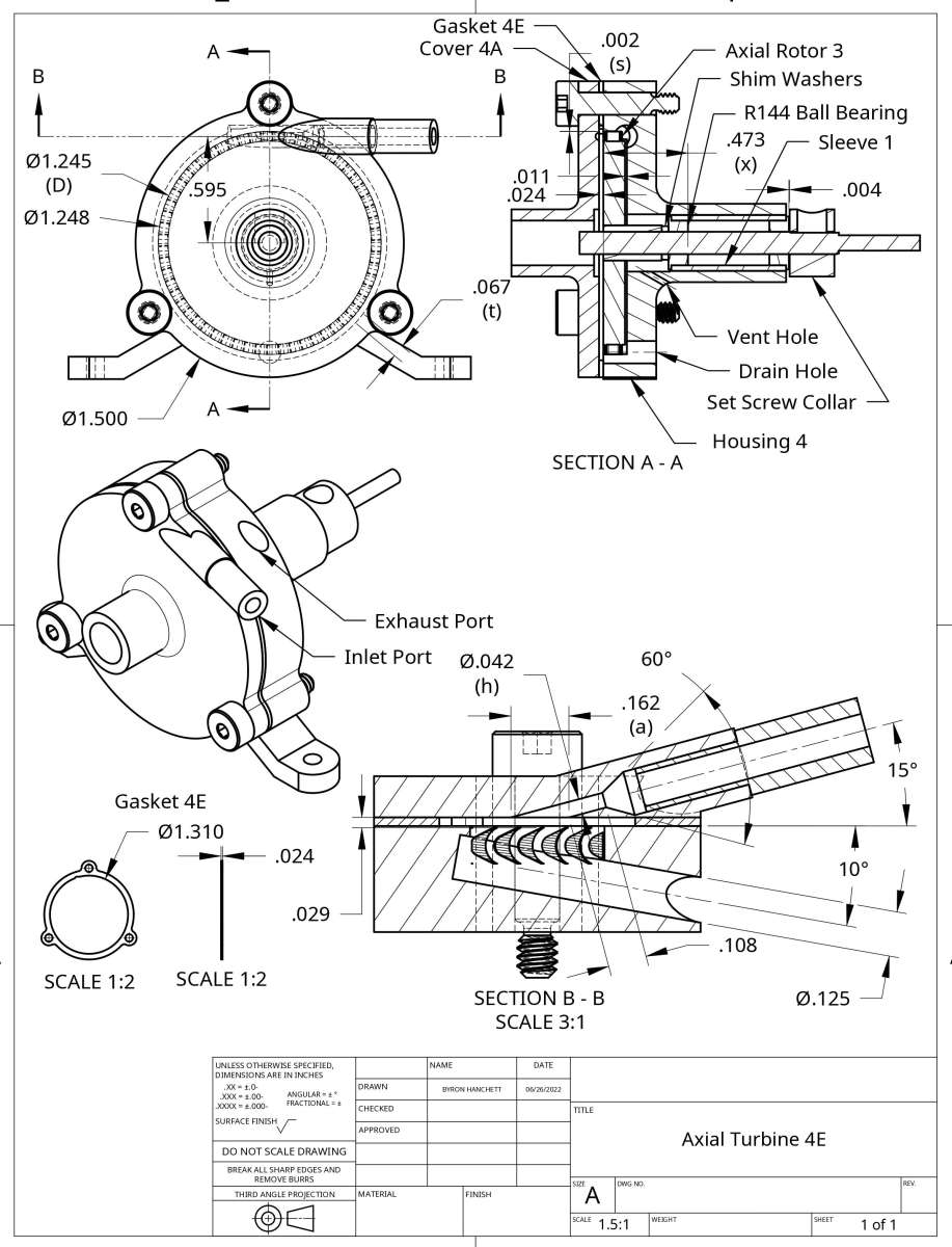

                #685082
                Turbine Guy
                  @turbineguy
                  I made a test of Axial Turbine 4E that is the same as Axial Turbine 4A but with a gasket as shown on the following drawing with the test results shown in the following table. The gasket made almost no difference in performance probably because the steam was only slightly supersonic and whatever gain in performance from giving the steam space to expand was offset by the increased leakage area.  I did tests with air with the same results.  Turbine Test Results 60
                  Axial Turbine 4E
                  #685463
                  Turbine Guy
                    @turbineguy
                    I added the test results shown in the 7 April 2023 post to the table shown in the last post to show the improvement of the last Tangential Turbine and illustrate the effect of running at higher turbine speeds. The 28,000 rpm speed results in a rotor tip velocity (U) to spouting velocity (Co) ratio (U/Co) value of 0.07 that even the best turbines would not exceed 20% efficiency as shown in the following graph. The tests using the larger propeller had maximum U/Co values of less than 0.02 so even the best turbines would have efficiencies under 10%.
                    Turbine Test Results 61

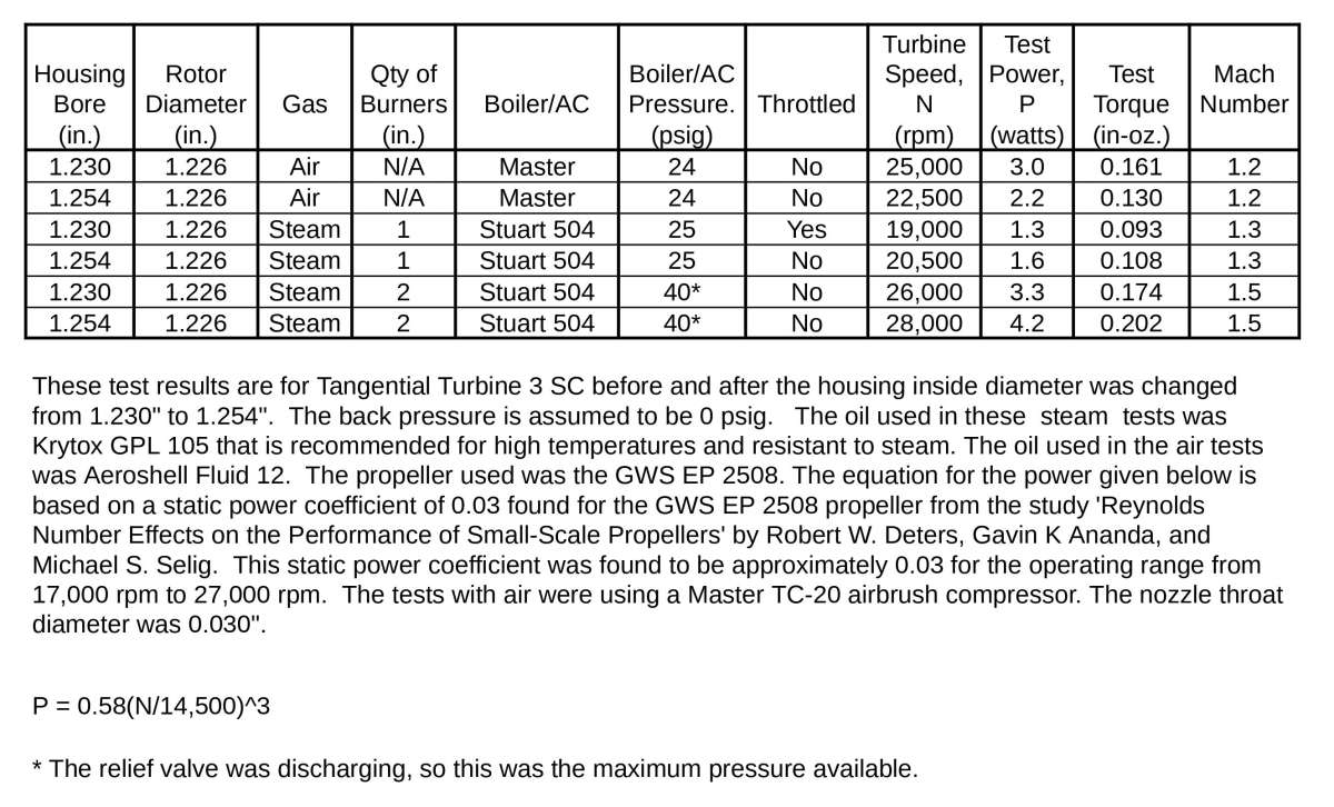

                            On Turbine Guy Said:
                            I decided to go ahead and try enlarging the housing diameter that the rotor fits under in Tangential Turbine 3 SD. The following drawing is an update to the drawing shown in the 27/09/2020 Post. I increased the diameter from 1.230” to 1.254” to provide a space for the gas exiting the nozzle to expand before contacting the rotor. The dimension 0.036” (g) is the minimum distance the gas travels before contacting the rotor. I thought that opening this gap for the higher energy flows would reduce the power for lower energy flows. I ran several tests before opening the gap and compared the results with those after opening the gap. The next post will show the table I created to compare the results.
                            Turbine 3 SD Gap
                            #686898
                            Turbine Guy
                              @turbineguy
                              The following table shows the results of the testing I described in the previous post. The power decreased 0.8 watts running on air at 24 psig from my airbrush compressor. This is the lowest input energy and needs the smallest gap. The power increased 0.3 watts running on steam from the Stuart 504 boiler with 1 burner. This is a slightly higher level of input energy and requires a little more gap. The power increased 0.9 watts running on steam from the Stuart 504 boiler with 2 burners. These tests indicate that if you plan to run on a low energy source like a airbrush compressor the gap should be kept small. If you plan on running on steam the gap of 0.036” would be right for pressures up to 50 psig. These results are using a convergent only nozzle with a throat diameter of 0.030”.
                              Turbine 3 SD Gap Test
                              I will add a revised table in the next post showing the Mach number for these pressures and some additional comments.
                              #686902
                              Turbine Guy
                                @turbineguy
                                The following table adds the Mach number to the table shown in the last post.  This shows the importance of the space for the gas to expand when using a converging only nozzle for higher Mach numbers.  Werner Jeggli uses a gap between the nozzle outlet and rotor face of 0.8mm for steam pressures up to 4 Bar (60 psig) at the Turbine entrance.
                                Turbine 3 SD Gap Test R1

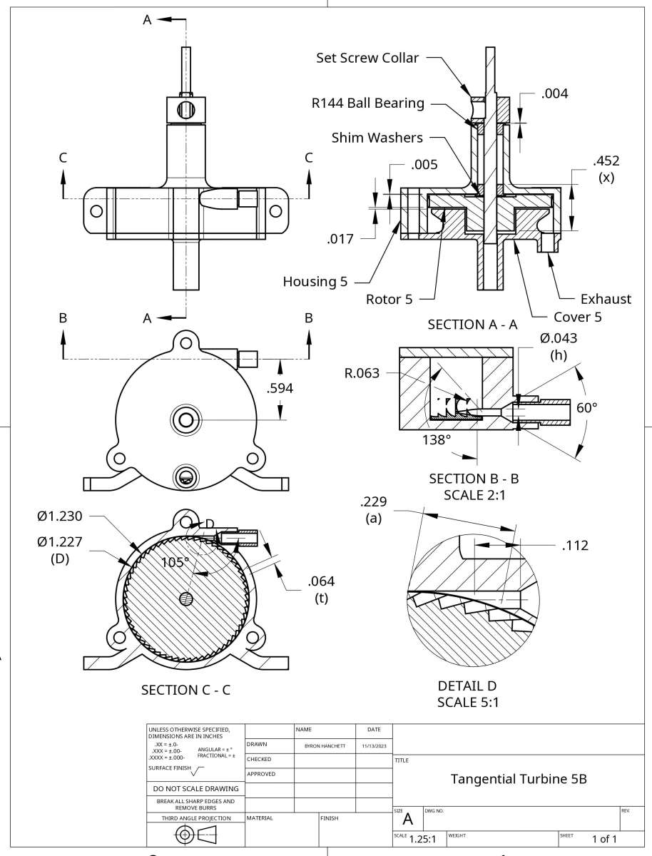

                                #690891
                                Turbine Guy
                                  @turbineguy

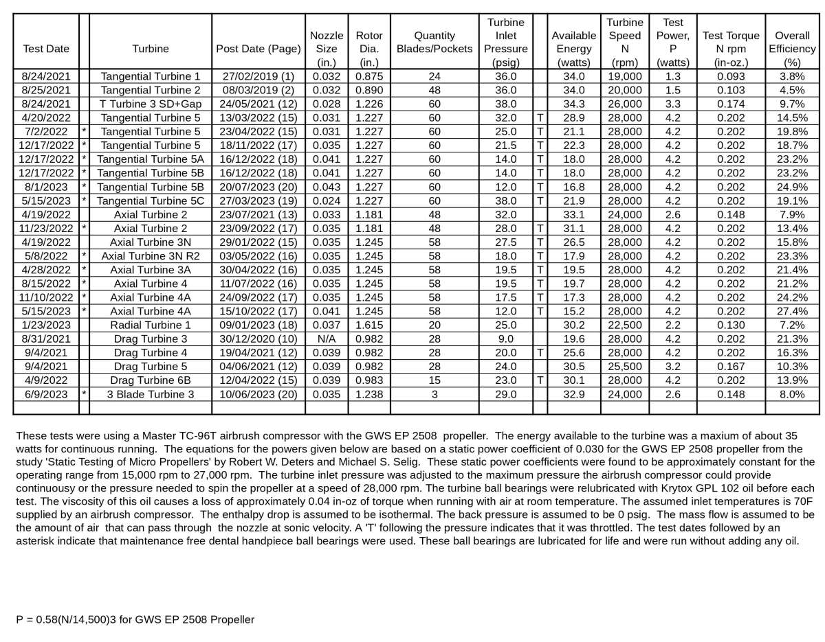

                                  I ran tests of Axial Turbine 4A and Tangential Turbine 5B without a propeller (no load) to find the rotational losses at a speed of 28,000 rpm. It required a turbine inlet pressure of approximately 2.0 psig to reach this speed with Axial Turbine 4A and a pressure of approximately 1.5 psig to reach this speed with Tangential Turbine 5B. The power available to the turbines with these pressures were approximately 1.5 watts for Axial Turbine 4A and approximately 1.1 watts for Tangential Turbine 5B. The rotational loss at 28,000 rpm was approximately 0.4 watts higher for Axial Turbine 4A than for Tangential Turbine 5B. Since both of these turbines use the same bearings and have been operated about the same amount of time, the difference in power required was probably due to higher windage loss for Axial Turbine 4A.
                                  This completes all the tests I currently plan to do with these turbines unless someone would like me to run another test to show something I have missed. The preceding posts show the things I’ve tried and the tests made to develop these turbines to this level. The following drawings show the existing dimensions and positions of the parts for these turbines.
                                  Axial Turbine 4A R2 (1)
                                  Tangential Turbine 5B R3

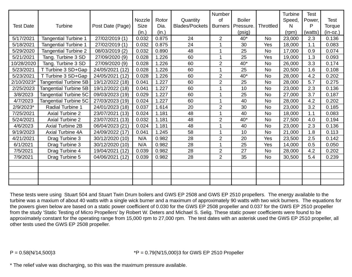

                                    The following test sheet shows the tests I’ve made with my turbines. Since this thread has run for several years and is up to 21 pages, I added a column showing the post date and page number for the post describing the turbine used in the test.
                                    My Turbines 1A

                                                    I updated the table showing the tests running on steam as shown below. I added all the tests I felt were significant and added the post date and page number of the post that best describes the turbine and the test similar to the table running on air in the previous post. These two tables show the most significant tests I have made running on air or steam and the progression in the power and efficiency of my turbines.
                                                    My Turbines 2

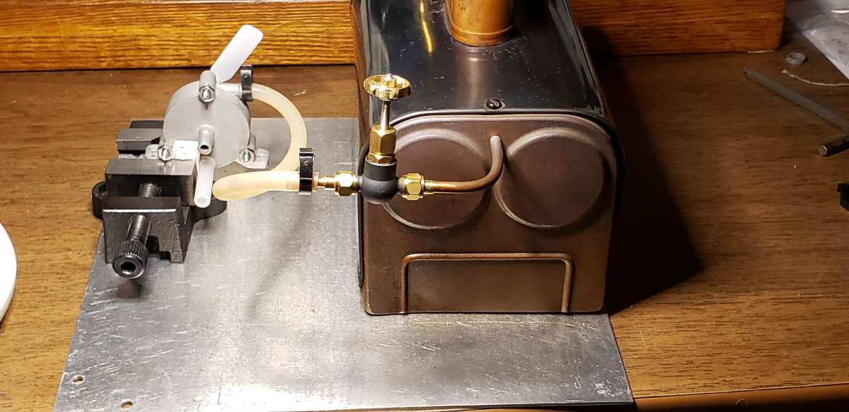

                                                    #724973
                                                    Turbine Guy
                                                      @turbineguy
                                                      I added a globe valve to the outlet line of my Stuart Twin Drum boiler as shown in the following photo. I was anxious to do a test after installing the valve and ran with Tangential Turbine 5B clamped to a heavy base plate like used in previously running on air. Apparently so much heat was conducted into the base plate and carried away by the air blown over the housing by the propeller that I was not able to get as good performance as I was able to obtain without the valve. These heat losses are not a problem when running with air since air expands to quite a low temperature in the nozzle so the base plate and air blowing over the housing actually add warmth. This is a big advantage for running with air. I made a few more tests with the turbine insulated from the support so that the heat lost to the support was negligible but the heat loss to the air blowing over the housing was still very high. I insulated the turbine from the vise I held it with by inserting folded paper on each contact side as can be seen in the following photo. I added two of the tests in the following table. The test of 4/8/2024 was with the valve opened to the point that the boiler pressure remained at 40 psig for the entire length of the run. After running for a few minutes, the speed remained at the value shown for the rest of the test. The globe valve allowed the pressure to be set to the value that the boiler supplies the most energy, so the turbine made the same power as the 4/6/2024 test with less mass flow. This increased the run time from 8.9 minutes to 11.3 minutes to empty the boiler filled with ½ cup of water. I’ve always tried to get the highest turbine efficiency but I think being able to run significantly longer at the same power is even more important. If you can make the nozzle size to match the optimum output of the boiler and provide the space for the steam to expand to supersonic velocities this will provide the best performance like in the test of 4/6/2023. The run time with ½ cup of water for the 4/6/2023 test was 10 minutes so adding the small nozzle and space for the steam to expand to supersonic velocities increased the power and run time compared with the 4/6/2024 test and also provided the best turbine efficiency even with relatively high moisture content.
                                                      Globe Valve
                                                      My Turbines 22 (1)
