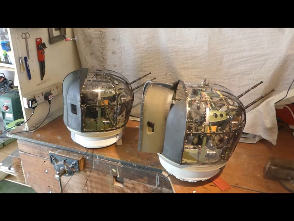

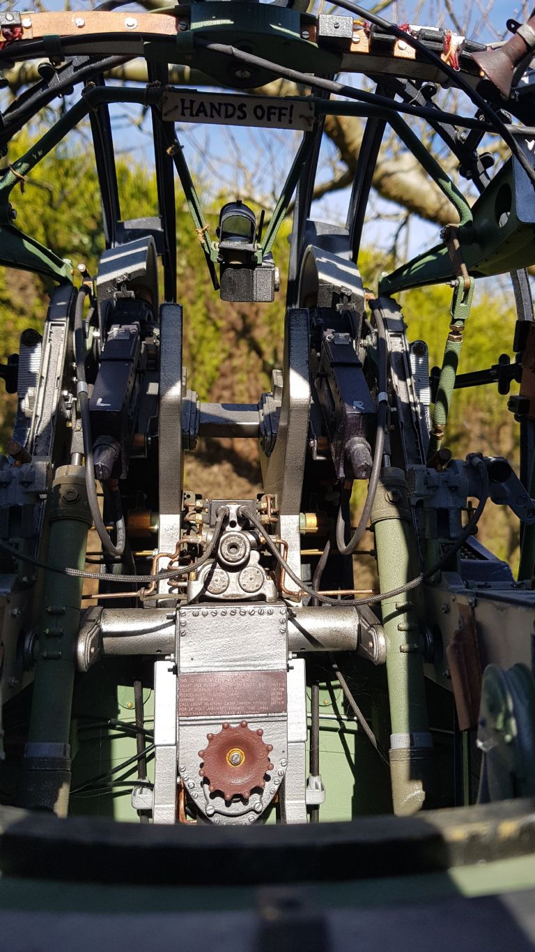

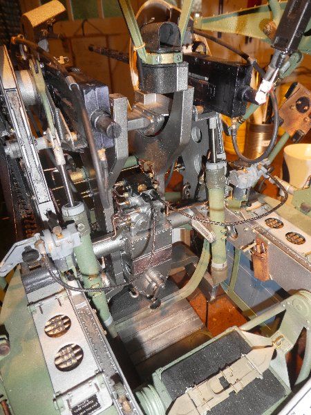

      These were built over around 6 and a half years, chiefly from 3d-printed SLS nylon, to save weight, as the eventual intention is to film from within them mounted on a large RC model. No technical drawings remain, so they were drawn initially from illustrations, and from CAD drawings of some components done by mark Evans from wreckage. Creating the CAD drawings so that the geometry of all the moving parts allowed them to both function correctly as well as miss the internal surfaces of the enclosing perspex cupola was what took the time, as well as learning CAD throughout the whole project. Films can be found by searching Youtube for Fidd88. The most worthwhile films are linked below, the remainder more or less just documenting triumphs and disasters as it proceeded.
      I'm not strictly speaking an engineer within the meaning of the Act, as everything is printed rather than machined, although, the whole structure is bolted or screwed together with hundreds of tiny M1 machine screws into hand-tapped threads!
      Hope you find it interesting, there are stills on some of the other films.

          So they were powered automatically with no human inside is that correct?
          Looks amazing
          edit: or did a small human go into both these things?(I know they're to scale)

                To reply to all above:
                Adv1: yes the turrets had gunners inside, although not for take-off or landing. Mine will added much later in the build when the FPV (First Person View) cameras are installed in the turrets.
                Sillyoldduffer: Amen in all respects. I was taught to fly gliders by an ex Lancaster tail-gunner. Even with eyes 50 years older than mine – I was in my 20's, he would spot other gliders many seconds before I did – at least to start with!
                Mick B1: I made the rounds with the belt connecting them non-functional, but actually linked them with tapered pegs to the adjacent round underneath. this allowed them to be twisted into shape in the feed-chutes and then glued into position so that they progressively curved in the track, rather than deformed. I'll post an explanatory pic of that later maybe. In the Mk III Wellington or later, the rear-turret was indeed a 4 gun FN20. Prior to the Mk III, it was a two gun FN5 in the Wellington.

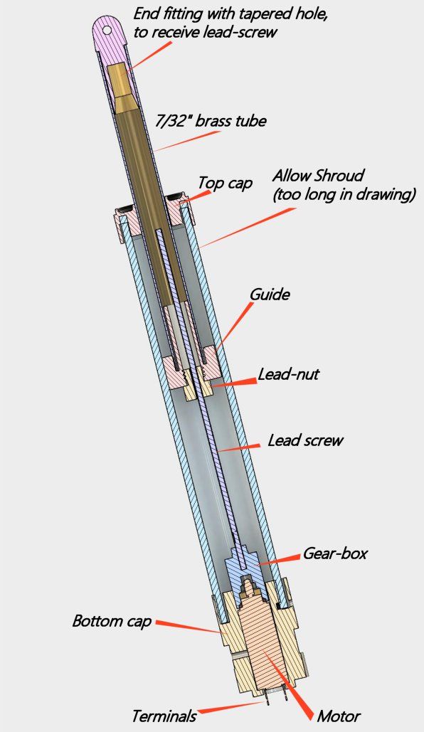

                  I've figured out how to make an album, and have added a small selection of photos of the turret builds. There are many many more which I can add, should people wish to see more. Sometimes the stills show things more clearly than the films on youtube, so please let me know if you'd more stills, or have questions about the build, or wish to see sectional views in CAD etc. Was a lot of fun.

                          This is one of the better films showing the mechanical linkages which keep the gunsight parallel to the guns. This took a lot of working out, as the paper illustrations I was working from had the geometry wrong – unsurprisingly – but also both the guns and the top edges of the green sight-bar had to remain clear of the close-fitting cupola "perspex" (polycarbonate) panels and supporting internal structure.
                          This film above was made long before a lot of the internal detail was added.
