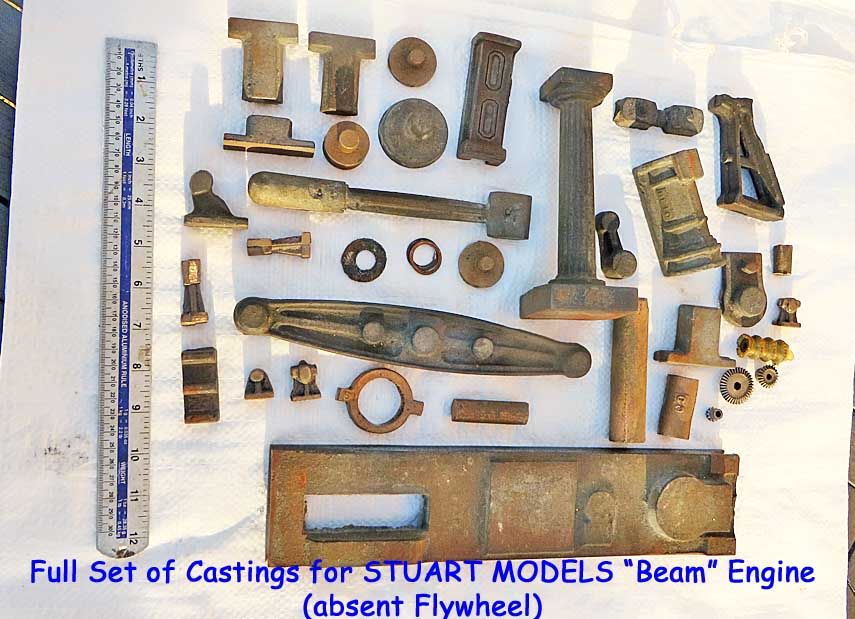

      I do not wish to mislead anyone with my latest listing which is SUPPOSEDLY for a set of STUART Beam Engine castings minus the flywheel as in the auction description where I bought them in with other stuff.
      Pretty sure they ARE NOT Stuart so would love some help identifying them please.

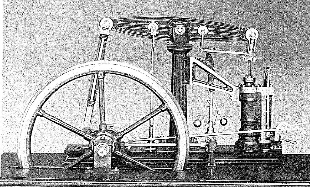

          Looks like a Sanderson beam to me. Blackgates do them and would probably supply just the flywheel to a buyer

            Yes they are Sanderson castings, I have a set just the same.

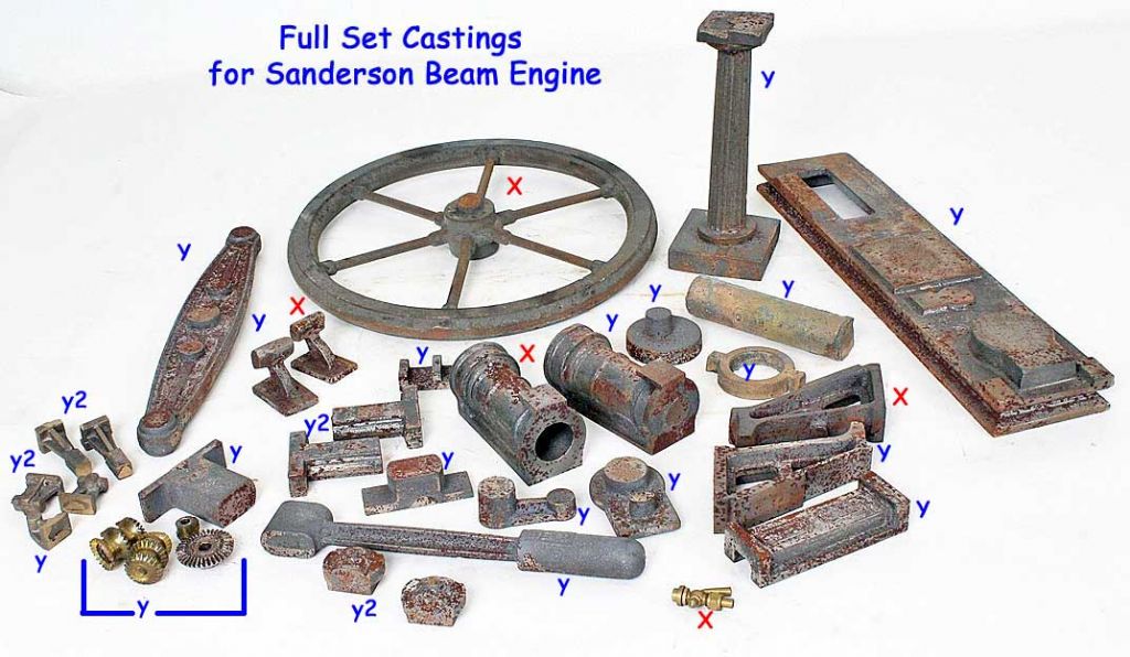

                      Hi All,
                      i have sorted out the mis-description with the Auction House who were very helpful.

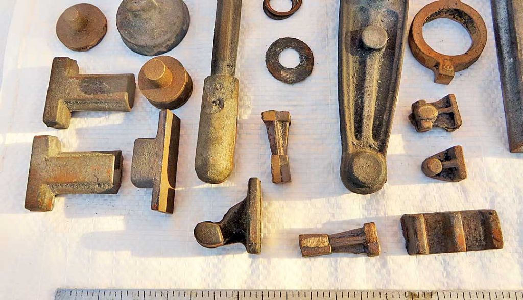

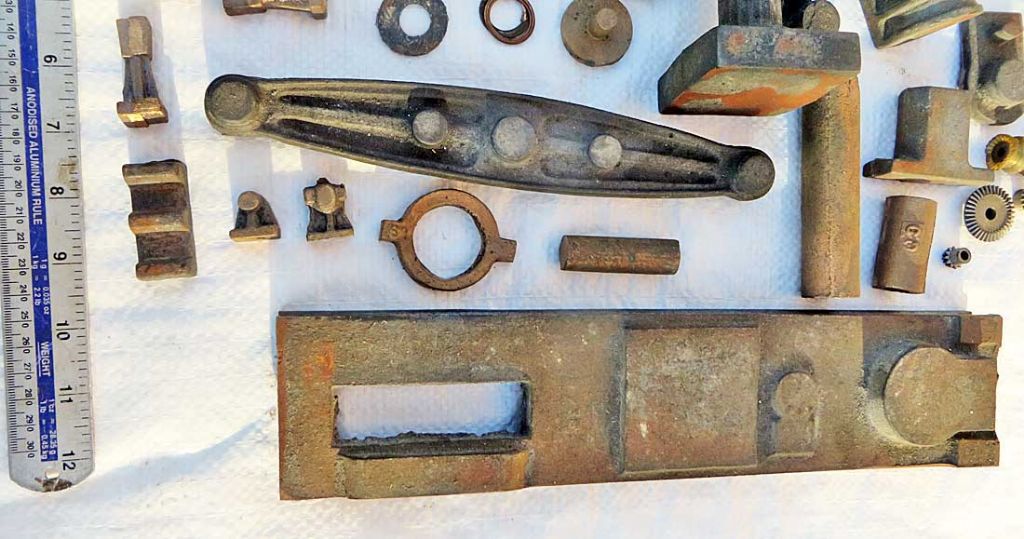

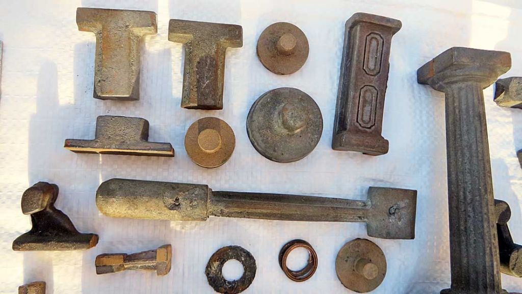

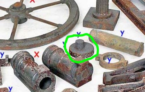

                      I have got a photo of what SHOULD be a FULL set of Sanderson castings and have marked the ones I do and do not have. There do however appear to be two cylinder casting and two of the support arm castings in the photo of which I only have one each? The Blackgates pic shows only one of each I think?
                      Y for what I have and X for what is missing.

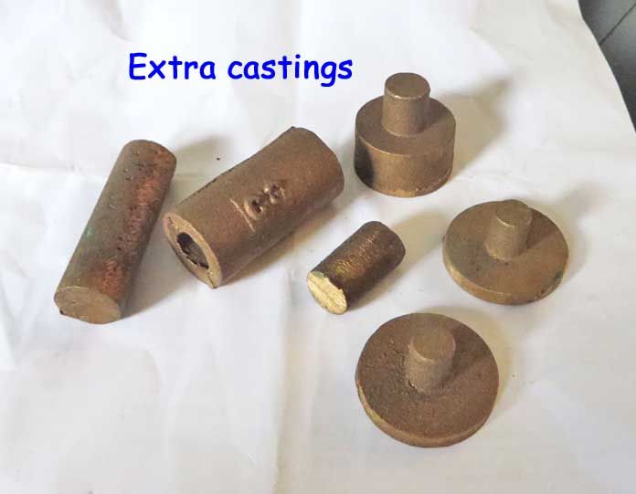

                      I also appear to have 6 "extra" bronze or GM castings as shown here?
                      Any help most welcome to get to the bottom of this so I can list them with confidence and accuracy.

                      #581956
                        The second cylinder and the two brackets are not needed for the engine but may be a selling point particularly the cylinder which could be warded as a spare should something go/be wrong with the other.
                        The other bronze bits are probably best sold as a job lot of "assorted model steam engine castings" or similar

                          Of your extra bronze castings I think the smaller of the circular ones with the chucking piece may be the piston casting. I seem to recall when I made mine that the piston was a similar casting. The finished piston is 1" dia. by 7/16" thick if that fits with its dimensions ( allowing for a machining allowance ).
                          #581961
                            I think the piston casting is in the group shot between the cylinder and the stick of bronze.

                              Jason, I'm not quite sure what you mean is the piston castings?
                              #581966
                                Actually I think you may be right John, what I thought Martin was allowing the piston to be may well be the eccentric

                                Martin King 2
                                  @martinking2
                                  Jason, I do not have the second cylinder and second support bracket so I am OK with just the one of each.
                                  Again, are there supposed to be two of the small castings to the right of the beam? I only have the one.
                                  I will list the extra castings along with the main lot.

                                  John Purdy
                                    @johnpurdy78347
                                    Jason, yes I believe that is the eccentric, the chucking piece is offset.
                                    Martin, the larger of the two round cast bronze sticks is material for the main and beam bearing bronzes. That is what was supplied for them with my castings which came from Clarksons in '82.
                                    The two castings to the right of the beam you mention are the support for the parallel motion anchor links, and no, only one is required. It is fastened to the top of the support bracket between the cylinder and the column.
