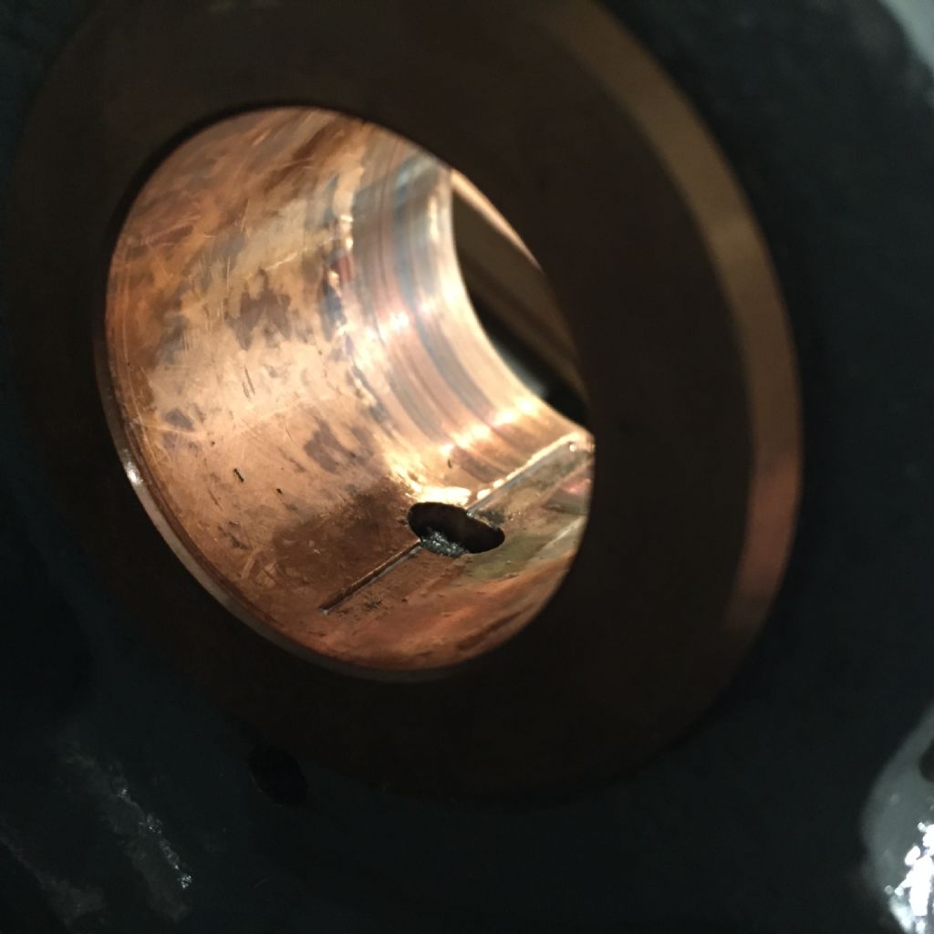

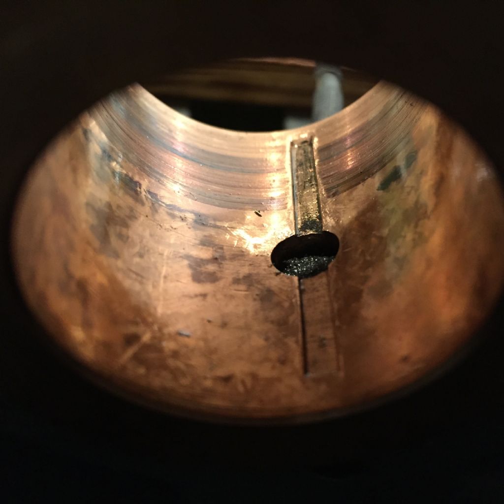

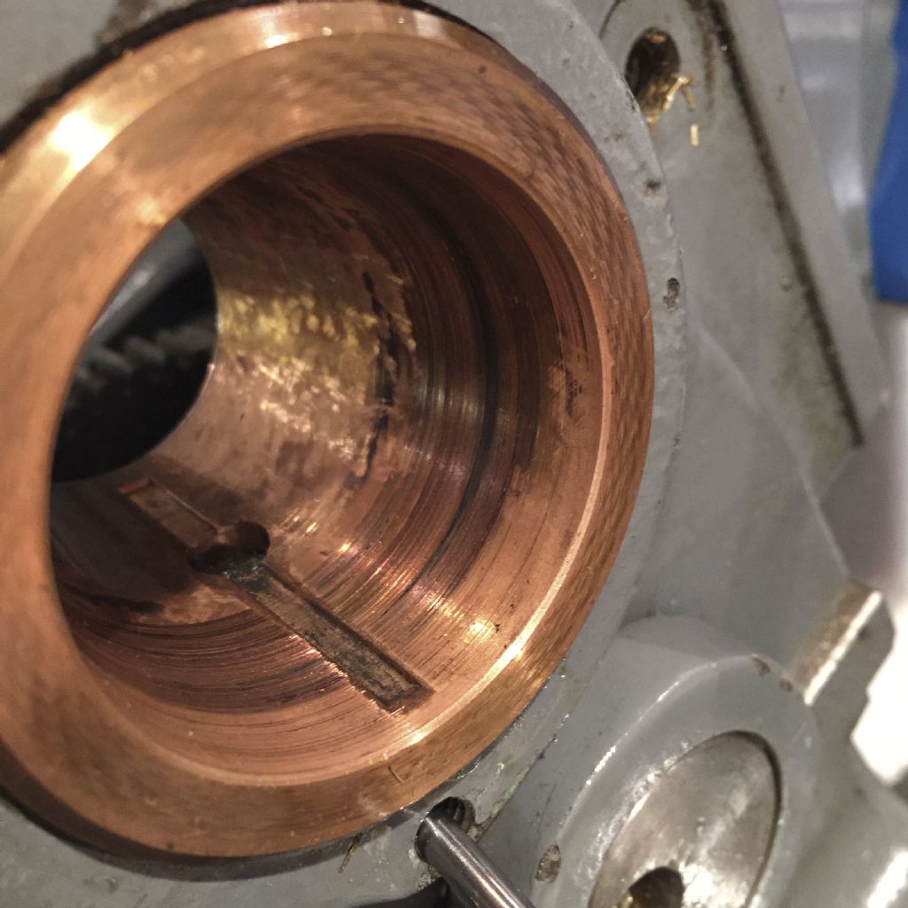

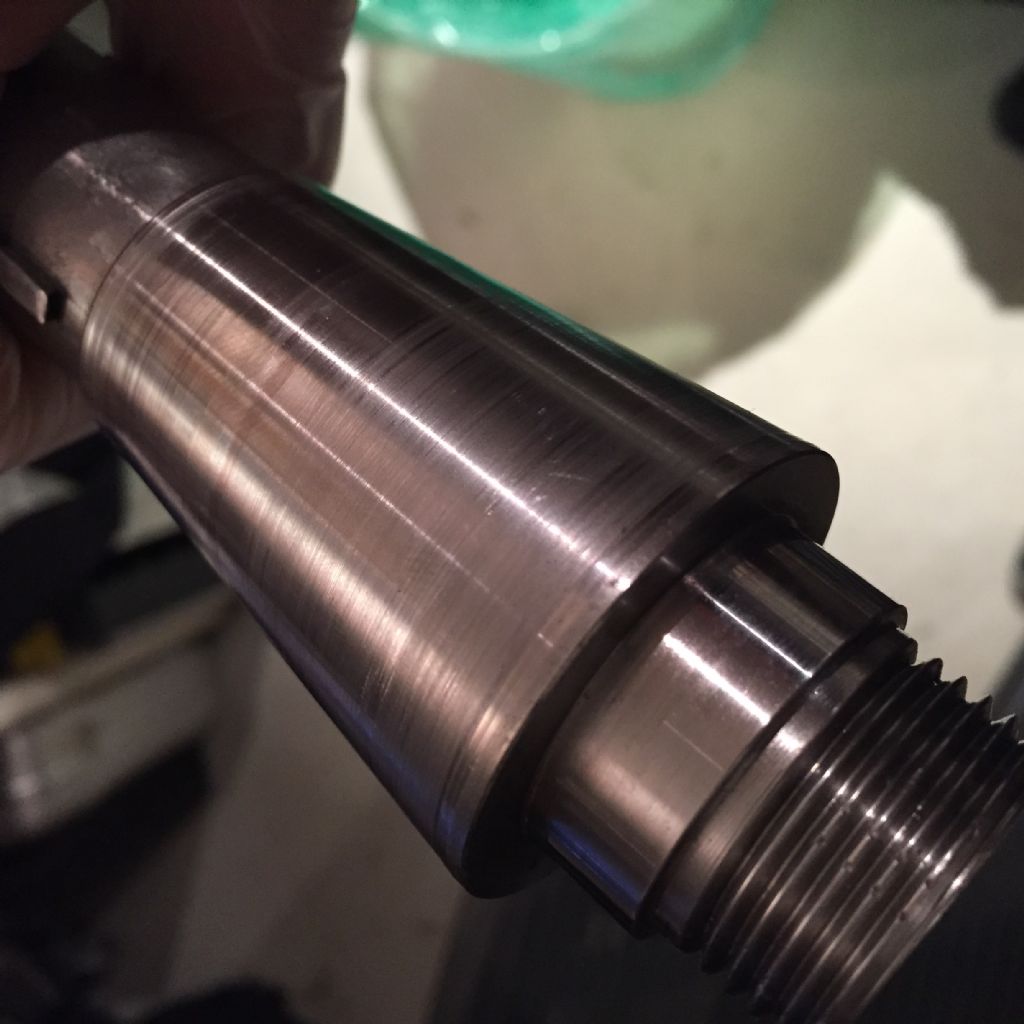

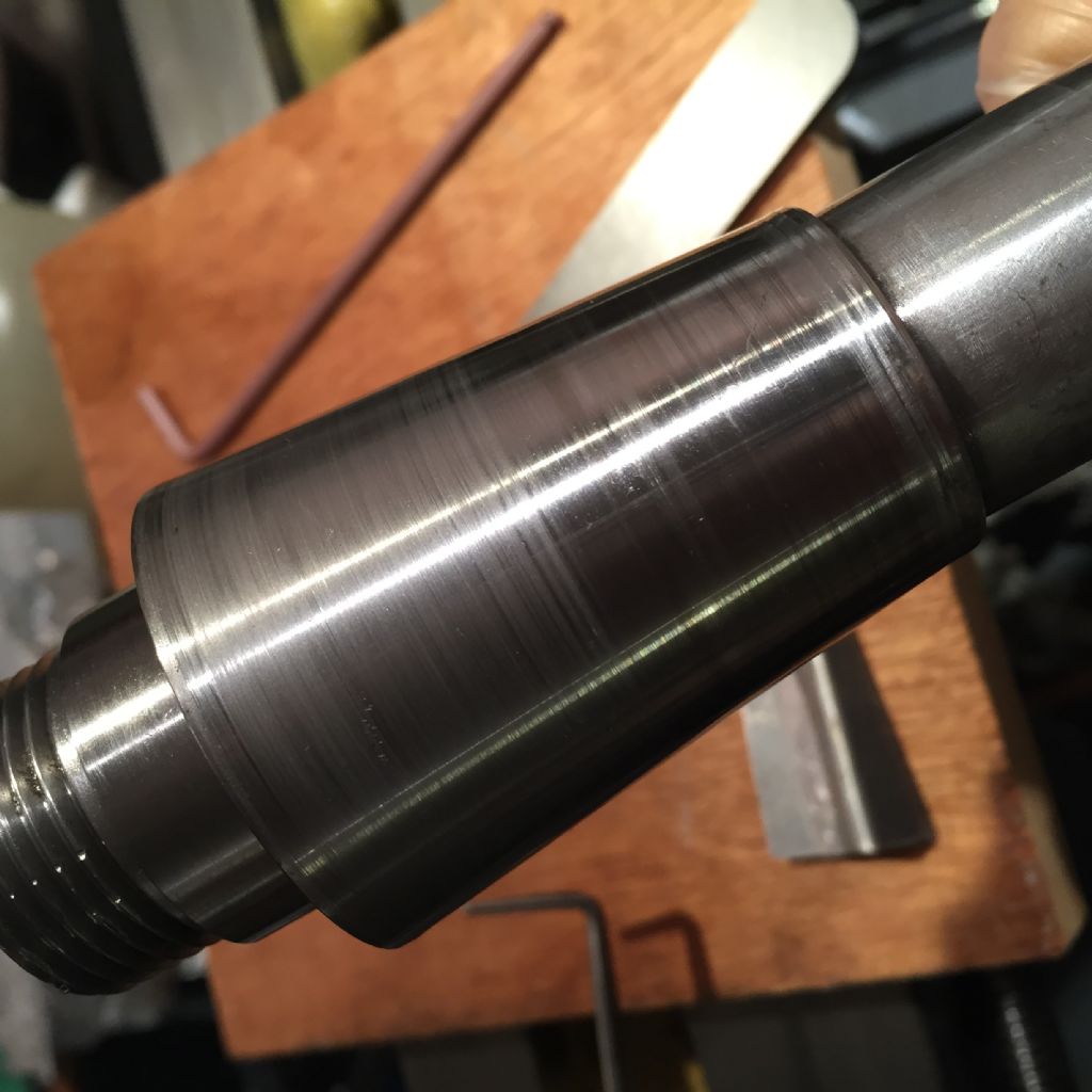

              jonathan olley
                @jonathanolley64724
                Hi, I finally got up enough courage to attempt an investigation myself (Thanks Eric), and this is what I discovered.
                The tapered journal was adequately lubricated and the wick only slightly worn. The rear bearings would seem to be in serviceable condition though the set on the far left is noticeably more worn that the set on the right. I am yet to remove them and won't until I receive their replacements. I will replace the wick though it is almost certainly unnecessary.
                What I see is that %40 of the front portion of the tapered bearing is worn and the other %60 is unworn, at all in fact. i can still see the scraper marks on the bronze. Was this a poor fit in the first place? Or is this normal wear and tear??
                Here are some images…Any comments or suggestions gratefully received. My intention is to replace the ball bearings and adjust the spindle. If I cannot obtain Zero (or close to) run-out on the nose I shall seek further advice and/or shell-out for a new spindle/bush etc or in other words £200 plus the faff of 'fitting', which of course I know nothing about. Funnily enough, my uncle is a retired machine fitter, dealt mostly with industrial production lines for Dunlop…only thing is he lives in NZ….So unlikely to want to pop over for a cup of tea and a Q&A.
                Cheers, Jonathan

                  Posted by jonathan olley on 12/03/2016 23:20:45:
                  … Was this a poor fit in the first place? Or is this normal wear and tear??
                  Jonathan,
                  To my eyes, it looks like the spindle was poorly fitted … Perhaps Tea-Break interrupted the scraping.
                  Check the taper on the spindle [the actual angle doesn't matter, but it must be constant] … Then, if it's OK,  get yourself a good bearing scraper and some blue.
                  Edited By Michael Gilligan on 13/03/2016 00:05:38
                  #229658
                  John Fielding
                    @johnfielding34086
                    From the pictures I would say the bronze bush is toast! The spindle is very hard steel and hardened even more by heat treatment, so it will be able to polish it or even a tiny bit of grinding by a company who specialise in this type of work.
                    If it were my lathe I would bite the bullet and buy a new bronze bush and have the spindle touched up. Scraping isn't an impossible task to do at home if you take it slowly and know what you are doing. But pictures can sometimes lie!
                    I have never had to press out the bronze bush in a Myford but I think it could be done in situ with a big bolt and some spacer collars machined up to fit the bush exactly. It will probably need a fair bit of Sunny Jim to get it out and the new one into place.
                    #229670

                      #229680
                      KWIL
                        @kwil
                        Looks more like it has been running dry or over tight. The trailing edge of the oil slot at the out end is crumbled (dragged) away.
                        Once the new rear bearings have been preloaded with the front bearing clear (ie spindle to the right), move spindle to left with the clamp rings and C spanners until you can feel the front bearing begin to drag and henpush the spindle right using the C spanners as per the Myford Handbook Instructions to get the correct running fit.

                          #229712
                          Ajohnw
                            @ajohnw51620
                            It looks like one of two things to me. Bearings not correctly adjusted which means that the spindle will tilt during turning more than it needs too causing more wear to the front of the cone and or some one has had a go at scraping the cone in. The tilting effect is always there to a certain extent on lathe bearings. Eventually they tend to wear oval what ever type they are. Allowing them to run too loose just increases the wear rates.
                            Chances are that some one has cleaned the oil way edges up with a file.
                            Personally I doubt if myford scraped these bearings on new lathes. It would make a lot more sense for them to make the parts accurately in the first place or use some sort of jig to correct things. Bearing scraping ideally just needs to be a bit of extremely light relieving. No one told Myford that when they made the first batch of phos bronze ml7 bearings which makes me think they had never really scraped anything in. The allowance they left was nothing short of insane and when they corrected that they wouldn't supply me with another set for free or even at a discount.
                            If some one actually has had a go at scraping the bearing in they probably used way too much blue. I'm not sure that they have though as it tends to leave an evenly dimpled surface but the high spots would soon wear off.
                            Reading Michael's link there is another and to me more usual way of sharpening a 3 square shaper. Hollow grind the faces but the scraper has to be kept closely tangential to the wheel right up to the tip. Then it's honed forming a sharp rim at the edges. This way they can be rehoned easily and quickly until too much of the hollow grinding has gone.
                            Bearing scraping isn't that difficult a thing to do if done slowly and carefully. Looking at the marks on the spindle I'd guess it's pretty close at the moment and the main problem might just be that it was too loose. The problem with removing a lot of material with a scraper is maintaining alignment. Not just in lathe terms. In this case the alignment between the cone and the rear bearings. Having the head out vertical on the bench would make a lot of sense as it might get round the spindle tilting under it's own weight as the work is done.
                            When the new bearings are fitted that the time to get the blue out and see what's what. That will need a lot of careful adjustment of the rear bearing each time it's checked. Or of course adjust and turn etc and see what happens. They should still have some super 7 spindles – maybe. I requested one and was told they had never ever supplied one but they did make a batch later. My main reason for wanting one was damage to the morse taper which looked like it had been reamed several times so little scope for more. My Boxford appeared on ebay so I never bought one.

                              #229720
                              Lambton
                                @lambton
                                John,
                                "It looks like one of two things to me. Bearings not correctly adjusted which means that the spindle will tilt during turning more than it needs too causing more wear to the front of the cone "
                                I agree with your reasoning however I am sure the scraping at the rear of the bush is the original Myford work.
                                My reason for saying this is my Super 7 has exactly the same scraping type of marks and I know for certain sure that no one has ever touched this bearing since it left the factory.
                                Before CNC machining became the norm hand scraping of bronze bearings for precision fits was standard engineering practice which not only produced a high standard of fit but also left the small depressions caused during the scraping process to act as mini oil reservoirs.
                                Eric

                                    #229844
                                    Martin Kyte
                                      @martinkyte99762
                                      I would agree with the bad adjustment theory of Ajohnw. To much clearance on the front bearing would cause bearing wear to the front of the bush when the spindle is loaded. I would have expected the wear to be upper part of the bush towards the back of the lathe although if there was excess clearance at the front it would tend to run dry much more quickly. This could exibit the signs as shown. Be interesting to see the whole circumference of the bush.
                                      I don't fancy your chances of getting the old bush out though. Re-scraping would be my first choice.
                                      regards Martin
                                      #229861
                                      jonathan olley
                                        @jonathanolley64724
                                        Hi, the latest so far; rather than have my lovely ML7R in pieces, I thought I’d put it all back together before I forgot what’s what and got busy with some other distraction…and during the process, adjust the spindle as per the instructions.
                                        Success! (sort of), I’ve managed to adjust the spindle to two tenths over two thou’ of run-out which if you remember is better than the original reading of over eight thou’ of R/O…!
                                        As you can imagine I’m very happy, despite it not being an acceptable tolerance, however it will do for now or at least until I can persuade someone to come and service it professionally.
                                        To that effect I've recently (last two weeks), I've been trying to contact Darren Boden, the ex-Myford engineer, who for a price, would come out to service a Myford lathe. After leaving a voicemail and sending a couple of emails I'm yet to receive any sort of reply, his phone is never answered, just goes to voicmail. He could of course be on holiday but I just wondered if anyone had had recent contact with him and if he's still running his business? Would be good to know so I can try another avenue.
                                        Thank you all for all your technical advice, whimsy and support.
                                        Cheers, Jonathan
