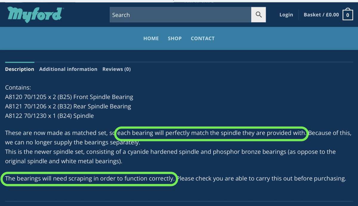

                              #753759
                              peak4
                                @peak4
                                #753772
                                  Am I permitted to be slightly confused ?
                                  IMG_0099
                                  [ perhaps they mean “… will, in the fullness of time … ]
                                  … Academic interest only, as mine is an ML7R
                                  #753776

                                        To be clear, I was referring to the capstan sleeves being hardened and ground – I know the ML7 spindles are unhardened.
                                        The apparently contradictory advice given by Myford about scraping the bronze shells also had me confused. Tony Griffiths never mentioned anything about scraping when he described fitting them to his own lathe. I did consider buying a new spindle the last time these were available, but It didn’t make economic sense to me.
                                        If the RDG sleeves are now unhardened one could be turned down below 3/4″ to reduce the amount that would need to be bored from the lathe headstock. Maybe though in the end the best concentricity would be had by using a plain Loctited insert with the taper machined in-situ, as already suggested. Given the existing state of the bore there’s nothing to lose.
                                        Making a new spindle seems to be a lot of effort to go to, given the fairly decent spindles come up for sale quite regularly – sometimes with good shells.

                                            A quick phone call to Myford should clarify the scraping issue. They are generally very helpful.
                                            If the bronze bearings are a bored finish and not ground, they could well use a final scrape in to get best finish and fit. That is pretty normal on bronze bushings on larger machinery if precision is required. They may also require a bit of relief scraping in along the join lines between the two halves to act as an oil reservoir to aid the hydrodynamics where the spindle rotation forces oil into the gap around the bearing.
