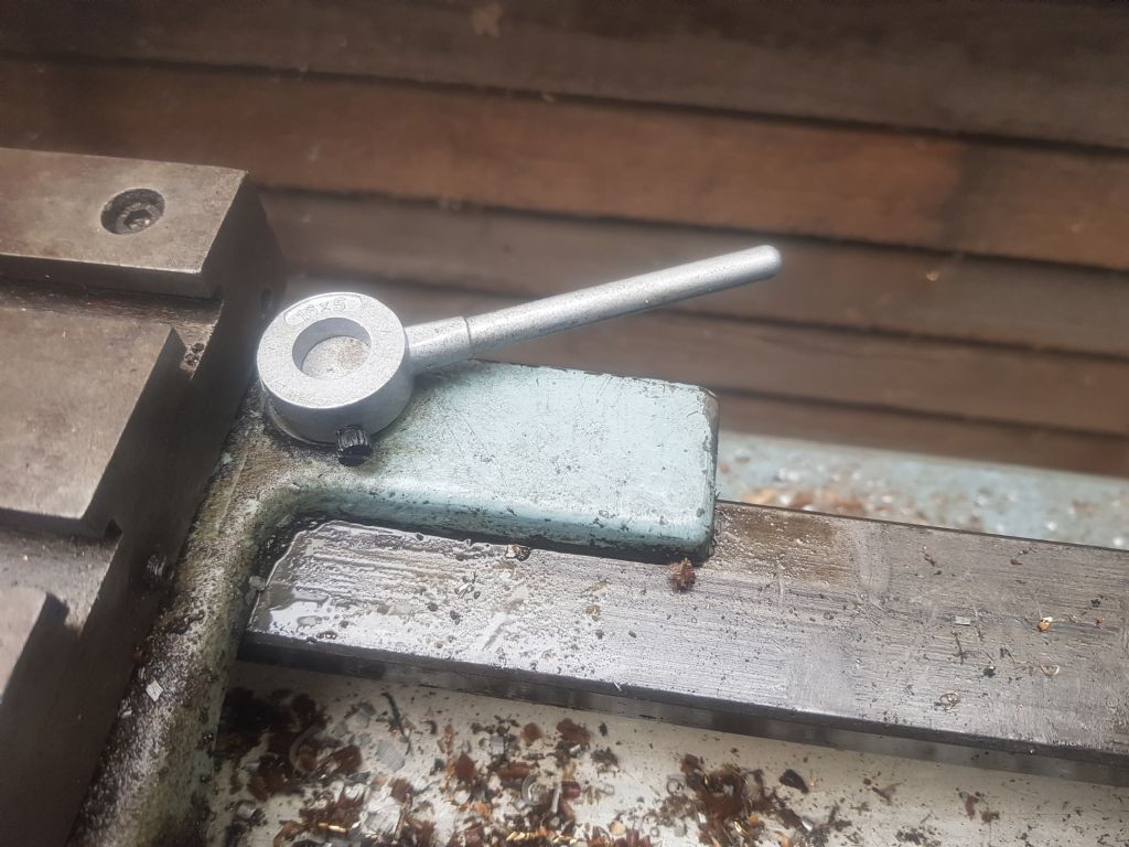

      @brianjones11
      I was unhappy with the need to scrabble for a spanner every time I wanted to clam the saddle. I balked at paying ca £20 for an after market addon so after some serendipidy I came across this for £2.45 on EB
      Its a 15cm die holder and I simply cut off one of the legs to suit as I hope you can see. It only needs quarter turn to lock
      Hope this helps other impecunious pensioners
      I might even put a little black ball on the end for that professional shine
      OBTW as I can already hear the FES rumbling, the clamp is shown in loose position, when fully tightened its at the 6 o clock position and unlikely to foul the tail stock

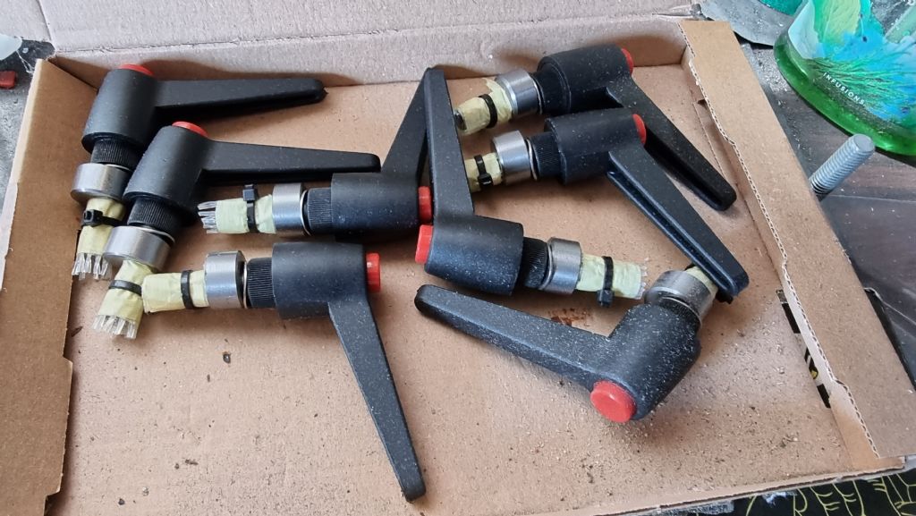

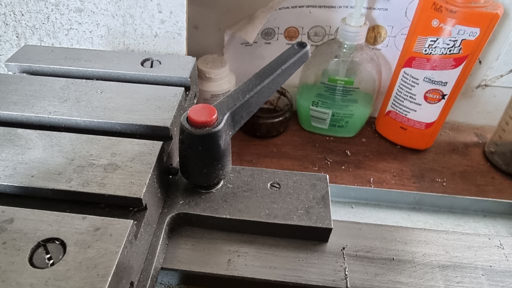

            Steviegtr
              @steviegtr
              I made this one. Then got ambitious & made some more. Lockdown blues stuff.
              Steve

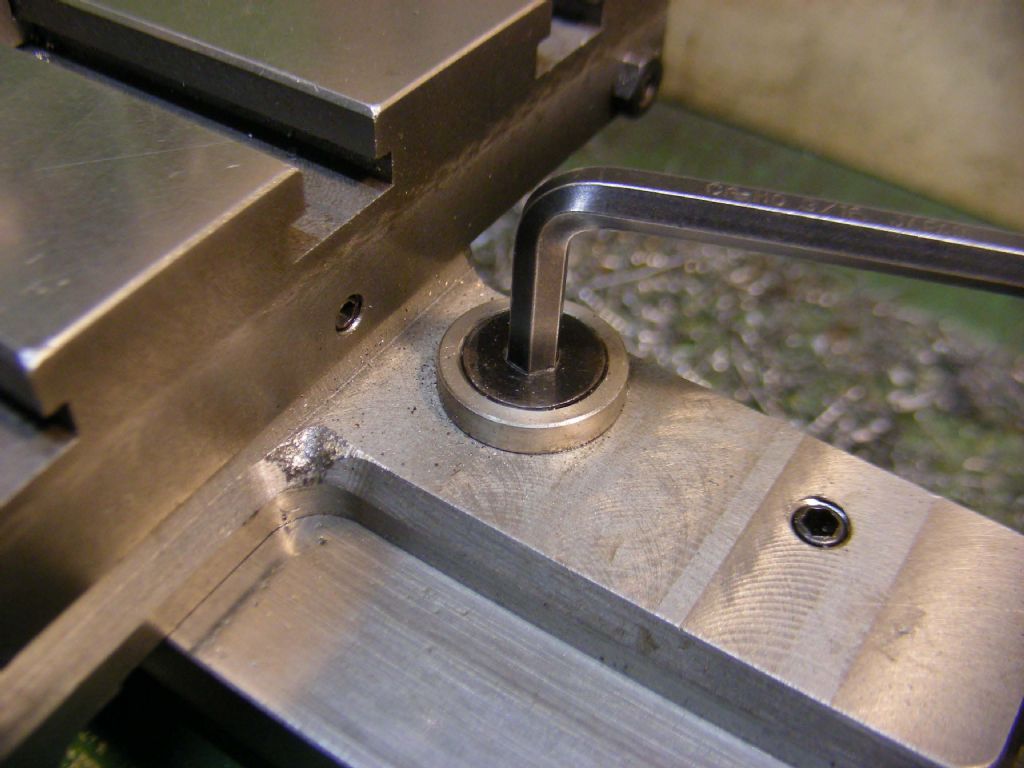

                @ega
                I replaced my screw/bolt with a countersunk washer and socket screw so that I can get at the cross slide clamp screw when necessary:
                The S7 block type cross slide gibs were mentioned in another post; I have found it helpful to install a clamping grub screw in line with the centre of each even though the front one is often hard to get at.

                  roy entwistle
                    @royentwistle24699
                    ega when I did that it always filled up with swarf
                    Roy

                    not done it yet
                      @notdoneityet
                      Posted by roy entwistle on 13/08/2021 11:46:06:
                      Roy
                      Not if you leave the allen key in situ.🙂
                      #558094
                      ega
                        @ega
                        Roy
                        True, but as I regularly use a shopvac to clean up the swarf it's not a problem in practice and, as NDIY says, I could leave the key in place if it were.
                        An additional advantage of a key/handle/spanner of some kind is that it gives an indication of whether the saddle is locked or not.

                          roy entwistle
                            @royentwistle24699
                            I was taught, about 75 years ago, at technical college that all loose tools ie. chuck keys, spanners, steel rules calipers etc had to be placed in the drip tray of both lathes and milling machines before switching on
                            Hence I get swarf in Allen screw heads
                            Roy

                              Steviegtr
                                @steviegtr
                                Posted by brian jones 11 on 13/08/2021 11:32:36:
                                so are you offering these for sale to members ? How much inc pnp mainland uk
                                they look neat btw
                                Sorry Brian. That was the original idea. But with Covid & our local post office closing down they just got shoved out of the way.
                                I have quite a bit of stuff to sell. But just must be lazy. Or maybe waiting till i am skint & then do a bumper ebay sell. Sorry. If you lived anywhere near Leeds you could come & take one. From memory the handles were £5 odd each
                                The reason i remade the grip pad was i made them metric. Could not get any imperial ratchet handles. Tried rethreading one but not too good . So made the complete things.
                                Steve.
