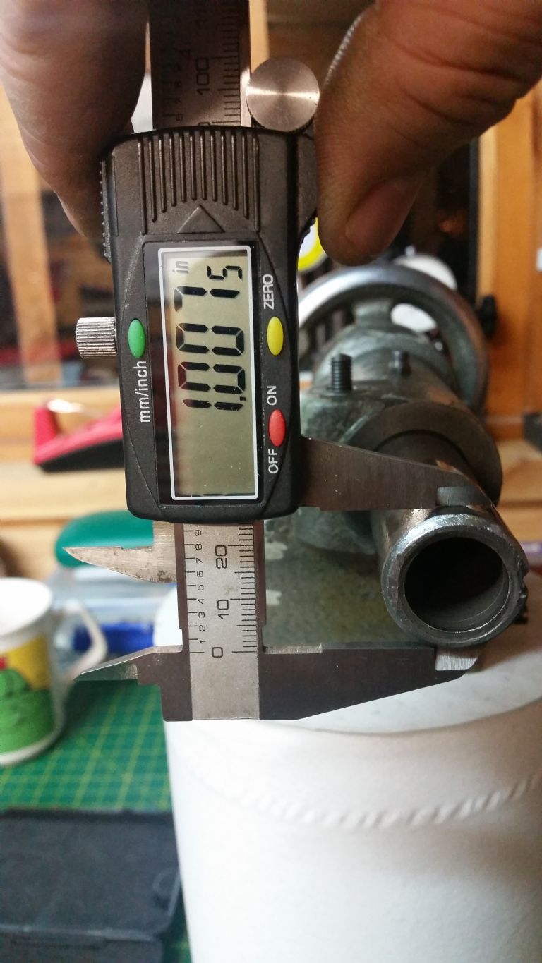

      Ok that’s made my mind up I’m going to take the quill out again and paint the tail stock while I’m at it. Anyone know how to remove the key that slides along the keyway ?

        Hi Hopper I'm going to remove it again and go over it again as you suggest. Alan Donovan, thanks for pointing that out (newbie error) I will measure it again once I have it apart and post my findings.

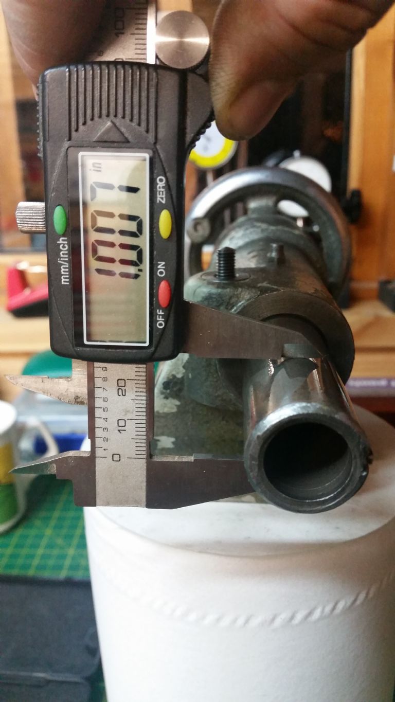

              Well, that was a productive evening, I started to strip the tailstock down again and unscrewed the lock handle and notice that the barrel that is underneath it was not freeing up when you loosen the locking lever. I took it out and have lightly rubbed all the edges with a bit of emery paper and cleaned it, put it back in and hey presto it's working as it shouldsmiley now the quill now has a nice smooth action. I've re-measured the quill avoiding the key groove and got a better measurement, sorry I don't own a micrometer yet so the cheapo digital caliper will have to do. Thanks for all your idea's on this.

                Well done. That's a good result. Our ML7 is much the same: when releasing the lock handle you have to give it a tap with the palm of your hand to make sure the locking blocks have released their grip on the quill. Seems to be nature of the beast. Your measurements look good. Half a thou is nothing to worry about.
                Carry on lathing!
