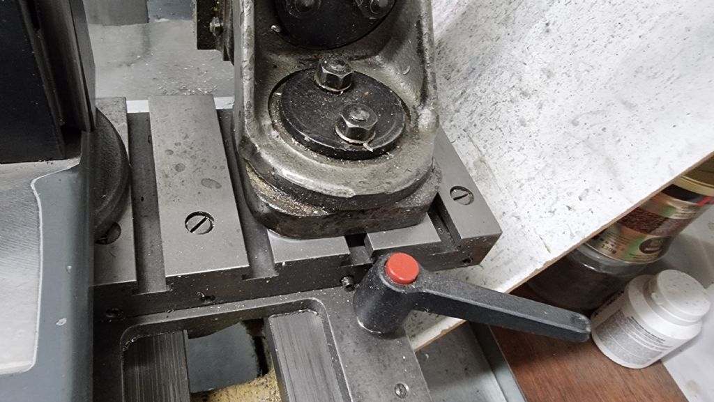

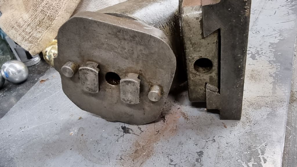

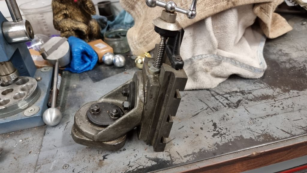

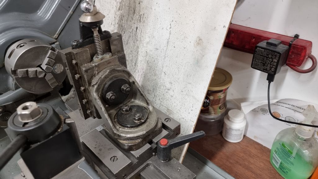

                  Hi Hector as promised on P.M here is the item. My Lathe is the Super 7B.I am wondering if your T slots are too narrow. The 2 pins slide into the same slot as the T bolts do. See pics. Hope this helps. I am pretty sure that mine is a genuine Myford item. Never used it as i now have a Milling machine.

                    Hello Steve, Many thanks for all your help. The photos clear up the problem which was ME. I thought that the two tee bolts fitted into two slots on the slide not both into one slot. Talk about being a beginner!!!!
