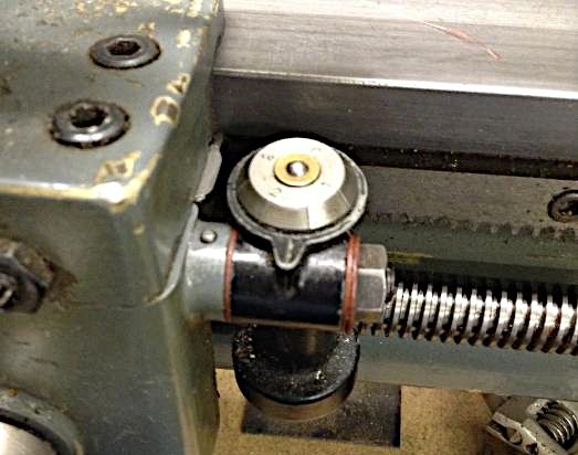

      Wondering if somebody could help, how to set the gearbox for acme thread on ML7 (for crosslide screw manufacture? also thread position indicator (4 position on leadscrew) will not turn when engaged, it turns when stationary, but when lever engages drive it refuses to turn, I have cleaned and oiled it, but I could not disassemble it! Any suggestions most gratefully accepted, Seasons greetings to all,especially thos providing previous assistance. Wouls I be better off buying an ace die?

          Acme threads are only special in respect to their shape, you need the correctly profiled tool-bit. The TPI or pitch if metric will be as for any other type of thread. Just look at the thread cutting chart on the headstock!
          As to the threading indicator dial not turning, that's how it works. Select the line to engage and when it comes into conjunction with the fixed point engage lever and it will stop turning.

            When the half nuts are engaged the thread dial indicator shouldnt rotate. It indicates the position of the leadscrew relative to the cross slide, which is constant with the lever in the engaged position.
            Acme thread cutting is best done single point IMHO. The threads, even 10tpi, would require a lot of effort to cut, and probably wouldnt end up straight. The width of cut becomes quite large and in my experience controlling chatter is an issue.
            The change gears are set up for the thread pitch, irrespective of the thread form. Cant help you with the choice of gears though, as I dont have a myford and you havent specified the thread pitch.

                Just to be sure, when you say dial indicator, I take it you are referring to one of these:-
                It's sole purpose is to make sure that the leadscrew is engaged at the correct time. Depending on the thread TPI/pitch and the leadscrew TPI/pitch it will be possible to engage the feed at any line, two opposite lines, just one line or for some metric pitches it wont work at all.

                  I'm going to presume that you are wanting to make a new cross slide screw for your ML7 which is 10tpi. Being an even numbered hread you can engage the half nut on any line on the dial numbered or not.

                            @howardlewis46836
                            Stupid question, but you have slackened the 1/4 BSF nut so that the Thread Indicator Dial can swing to engage with the Leadscrew, before retightening it?
                            Once engaged, as the Leadscrew rotates, it will drive the dial, so that you watch it rotate, and close the half nuts at the appropriate reading.
