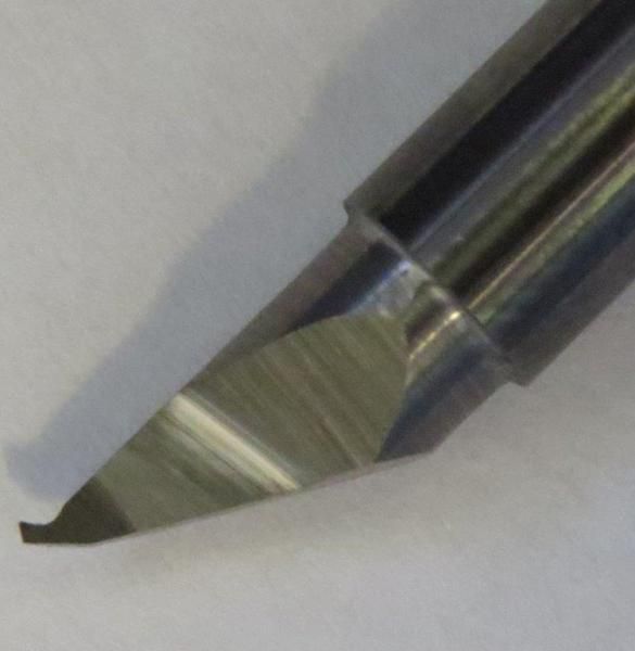

                          Roger, I did say that they were not exactly cheap. Only prices that I could pin down are in the U.S. **LINK** but for the jobs that I envisage they would be quite invaluable so prepared to pay the price and hope that I don't bust one in a hurry.
                          Compared to all the time saved faffing about (I have ground similar boring tools from HSS) making my own so might be worth a punt.
                          This one was ground from 1/8" sq HSS to bore a Cox Pee Wee .020 cylinder head for a contra-piston – it worked!

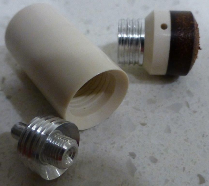

                              Here is the micro threader, Great work there Danny.

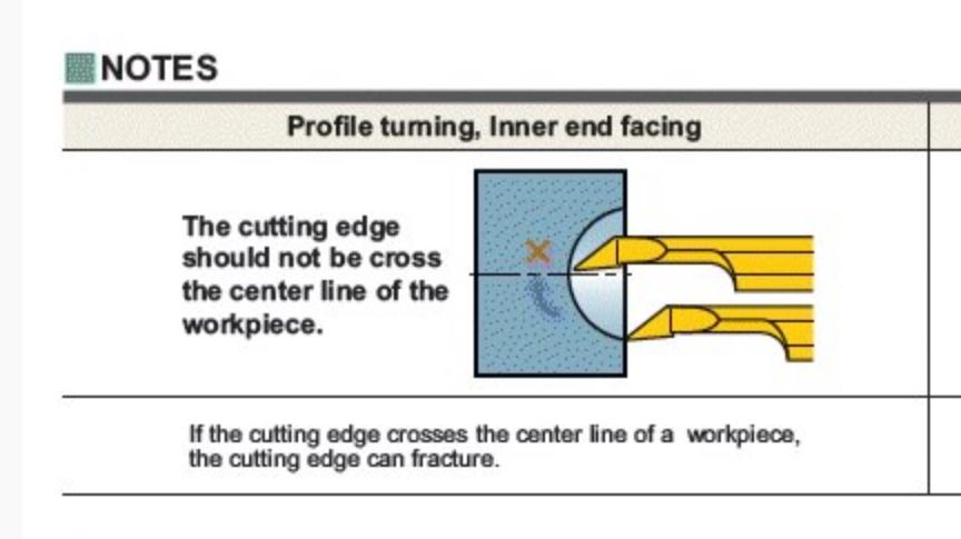

                                Thanks for the link, Danny … They do look rather good
                                I do, however, find this little warning note [whilst perfectly reasonable] rather scary:
                                … It's a very fine line between reaching "the center line of a workpiece" and crossing it.
                                As illustrated; one gives a perfect hemisphere, and the other a ruined tool and maybe a ruined job.
                                  I carry out bowl cutting frequently for some parts I make in aluminium. First op is to use a 6mm ball end mill to drill to exact depth of bowl required. 2nd op with a 6mm boring tool roughs out and finishes the bowl to the depth and radius required, for the finish pass the tool starts cutting from the centre so avoiding damage to the tip by upward moving metal.

                                        Posted by Michael Gilligan on 07/01/2017 11:42:01:
                                        Noted, emgee … But my comment was specific to the very small carbide tool referenced by Danny.
                                        Edited By Michael Gilligan on 07/01/2017 11:55:22
                                        Michael, I have found the same applies to any size finely ground carbide tooling, solid or insert are both likely to chip on the cutting edge with even light reversed cutting forces as would be the case by going beyond the centre of the bowl shown.

                                          Emgee,
                                          Thanks … Yes, I am aware of that ^^^
                                          I hoped I had made that much obvious, by writing: "[whilst perfectly reasonable]"
                                          The thing I found 'scary' is how fine the dividing line between success and failure might be, on these particular very small and not inexpensive boring bars.
                                          I won't labour it any further.

                                            Mike G, The same applies to any turning tool that is rubbed from the reverse. It is worse on a inner sphere as described, you have the work piece acting as a lap over the cutting edge. The above refers to only a solid turned sphere. If there is a small hole or if the bottom of the sphere is formed some other way it is ok. The problem with any small tools is the very centre of any part. As it has zero surface speed, it can only be removed by deformation or by the chisel effect. Very small tools are just not that strong in their geometry and by their nature are weak. That makes them very susceptible to centre line height setting. Often when boring having the tool slightly above centre height is an advantage as the loading of the tool, then deflects down and in doing so reduces very slightly the cutting load. When the tool is exactly on centre line, when it deflects down, it will take a very slightly bigger cut. When it is set below centre line, it will have the tendency to be digging in and taking cuts big enough to either damage the tool, or leave a very poor surface finish. So with small tools, the more rigid the material the tool is and the lighter cuts makes for the tool lasting a long time with good surface finish. Cutting fluids that promote the shearing of the material, ie reduce cutting forces, help a lot as well. On small stuff, I keep the corner radius to less than 0.2mm or 8thou. On micro bars, less than Ø3mm diameter, I have the tool radius at 0.1mm or 4 thou. This allows at a 1 thou per rev feedrate to get accptable surface finishes. If I need a very good finish, I hand feed at about the 0.01mm per rate approx. So when the spindle is doing 600 rpm, I feed the main hand wheel so that I do 1/4 turn every 7 seconds, or 1 rev in 30 seconds. This is for the 0.1mm nose radius tool. With .2mm radius tool it is turning the hand wheel 1 rev per 15 seconds, or 4 revs per minute. The myford box does not allow 0.001 inches per rev feed rate. It takes time to learn to turn a handle at a feedrate, but is really worth while to learn.

                                                      Posted by Neil Lickfold on 07/01/2017 06:17:20:
                                                      That's a nice-looking tool Neil. What wheels do you use (size & grit) for grinding such small features?
