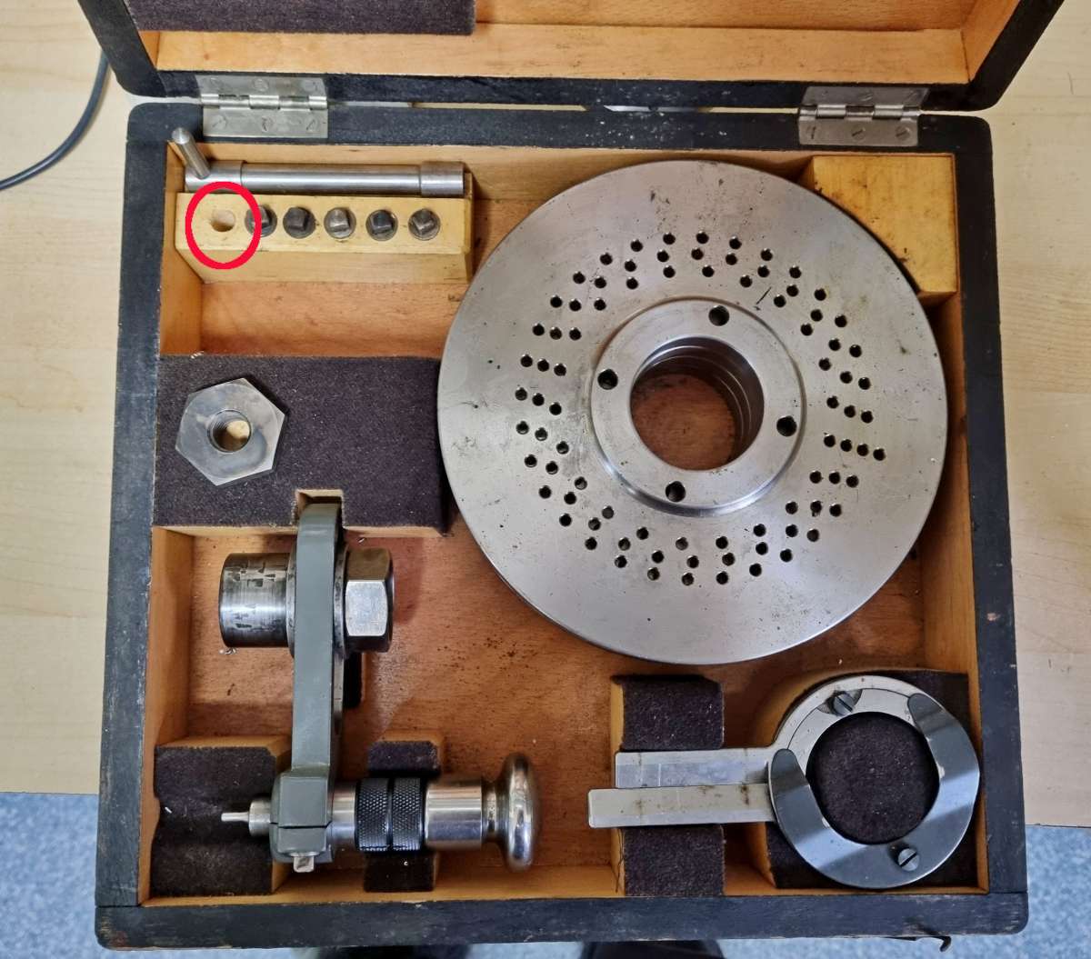

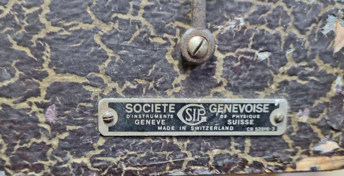

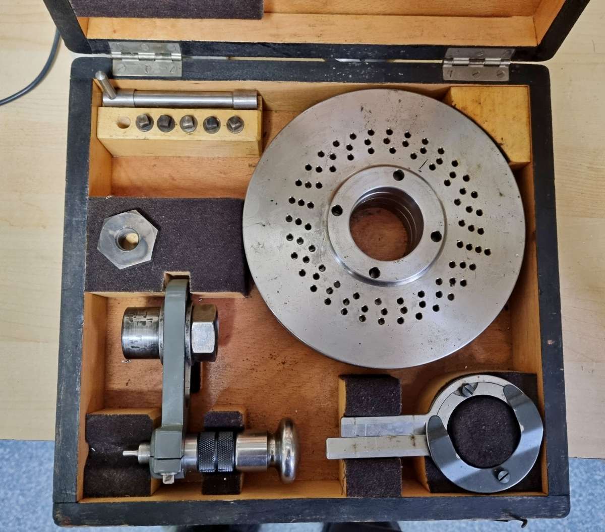

      HI, I am hoping someone will be able to identify this dividing attachment made by the Swiss company SIP. This is part of a workshop clearance sale I have been helping with for some time. Any help will be much appreciated.
      Thank you

          I didn’t explain meself very well I’m afraid, I know how it works but not the machine it is made for.

            It seems unusual to be in its own box, rather than an integral part of a dividing head. I’m therefore inclined to think it is an ‘extra’ for something like a plain indexer or rotary table.

              Societe Genevoise make/made a range of jig borers for which this is possibly an attachment. Try lathes.co.uk for more detail.

                Rotary table indexer set. The standard SIP rotary tables often had only a graduated collar on the worm handle. You added this kit to do precision indexing in the same way as common on dividing heads etc.

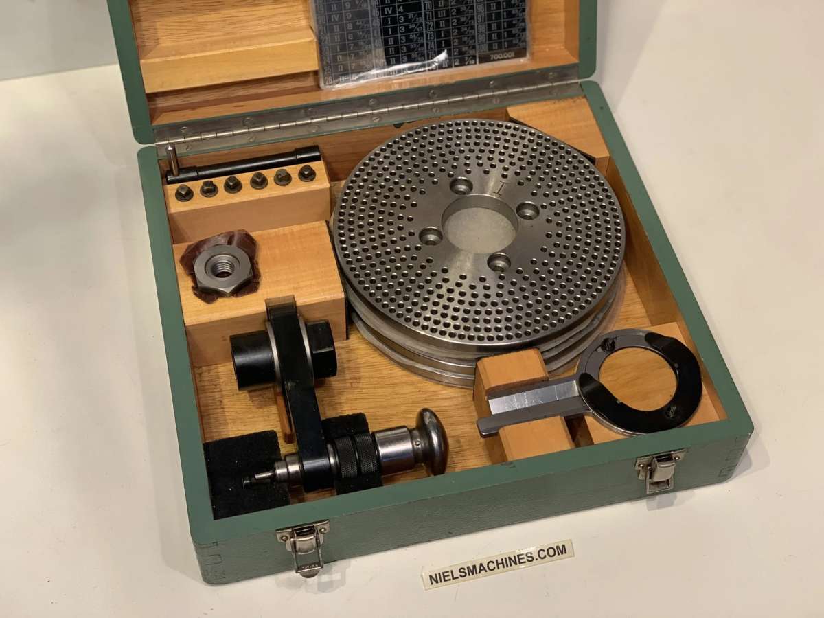

                      The answer might be in the link provided by Michael.   The pictures of the unit being sold by neilsmachines look identical to Brian’s photo, and  neilsmachines say it’s for these SIP dividing tables:
                      Sip PD-3 Circular Dividing Table ø350mm
                      Sip PI-4 Tilting Rotary Table ø300
                      Sip PI-5 Tilting Rotary Table ø450
                      Sip PD-4 Circular Dividing Table ø450mm
                      Sip PD-5 Circular Dividing Table ø600mm
                      Sip PD-6A Circular Dividing Table ø800mm
                      Brian’s set is missing the settings list and one of the 6 bolts next to the T driver.
                      The missing list is a good example of the extra goodness one gets with an expensive indexer.   Not a bit of cheap paper stuck inside the box, instead a bombproof enamelled plate is provided.   Unfortunately, this wonderful feature was no protection against the Slack Alice who forgot to put the plate back in the box.   (Good news: the photos of this double-sided plate on neilsmachines.com should allow almost all the values to be recovered.)
                      This is the neilsmachines box:
                      sip-rotary-table-index-unit
                      Brian’s example:
                      brians

                        It should not be beyond the means of a competent machinist to make a replacement bolt using the others as a guide to the design. It would not be a deal breaker for most of the people looking to buy one of these. I also think that with a spreadsheet it would be quite easy to replicate a table to go with it based on the usual calculations for a dividing head being available on the www. There are probably online calculators for one off calculations as well.

                          I occasionally worked on a SIP jig borer which was supplied with a large rotary table and this attachment, I do recall the table being used but not this attachment, nice to have but seldom used, lovely properly engineered machines serviced and calibrated every year. When the place shut down the two machines either went east or were scrapped, makes me weep thinking about it.

                            As you will have gathered from foregoing posts, SIP (Society Genevoise) were very high quality, Swiss made, machines and measuring instruments. The measuring equipment was normally found in Standards and Calibration Rooms, to check and calibrate other measuring instruments.
