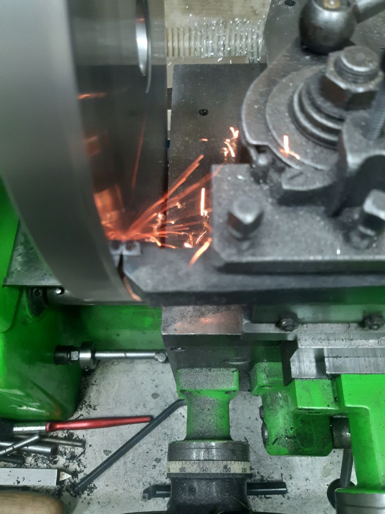

          0.001" should easily be possible with **GT inserts the more common **MT wont work so well at shallow cuts.
          This is the Warco 280 doing it so unless it's a really clapped out Myford that should be able to do the same or better. Best watched on Youtube at full screen so you can see the thin wisps of swarf, thats EN8 too

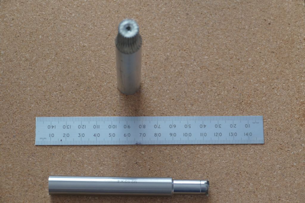

                    HSS turned with a GT insert at the bottom of this picture. This is what I would consider good. I would also say good enough or acceptable but excellent is, as Andrew suggest, not well defined.
