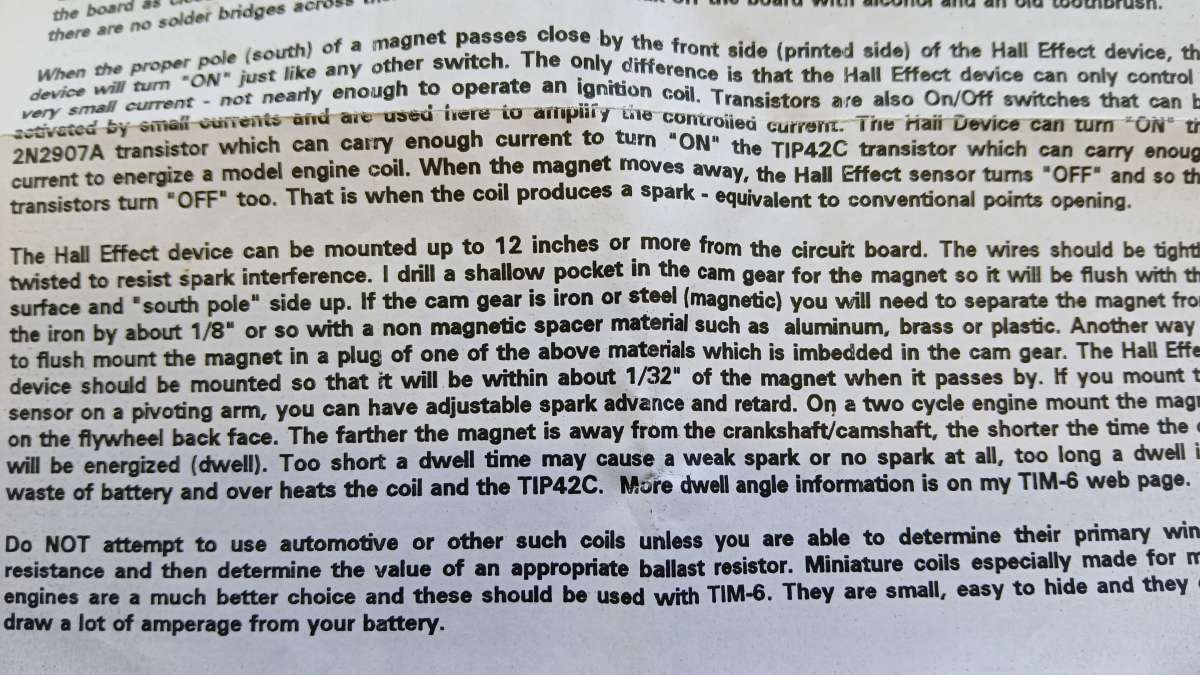

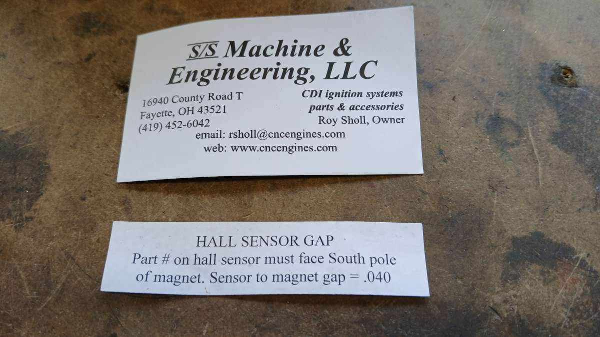

          #795497
            Bit late as I just wanted to dig out the instructions to check. the S/S give 0.040″ and the Jerry Howell give 0.031″ which will give you a bit more to play with.

              Thank you all. It is a shame that the instructions I have do not give any information on the best gap to use, which would be helpful. They don’t even mention which pole is best to face the sensor.
              All I need to do now is decide which is north or south on the magnet
              I take it that the magnet can be mounted in any material, ie Ali cast or plastic
              #795506
                Material needs to be non magnetic or insulate the magnet, South pole see the Jerry Howell instructions above for both

                  All very interesting ! I recently had an issue where it was clear the sensor had been rubbing the the flywheel. Wear on the main bearings and some degree of flexing had caused this. I would have said 25 thou, so 31 is not far out, 40 seems wide. Using paper or a small slip of flattened copper pipe of the right wall thickness is handy for setting up. Noel.
