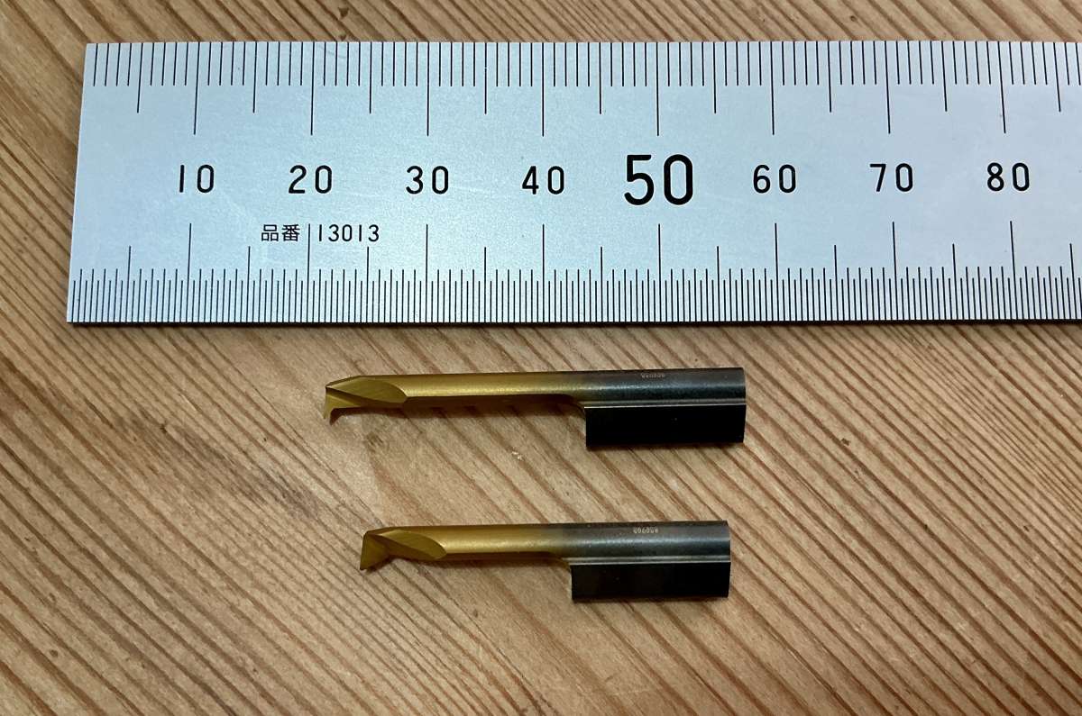

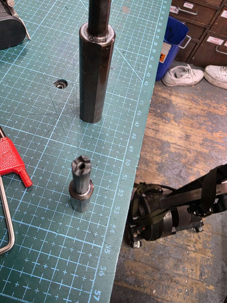

      Anyone used these? They were given to me so I thought I’d make a simple holder for them. I don’t want to waste too much time making it though as I suspect they won’t last long with me behind the feed handle 😂
      IMG_4587
      #803878

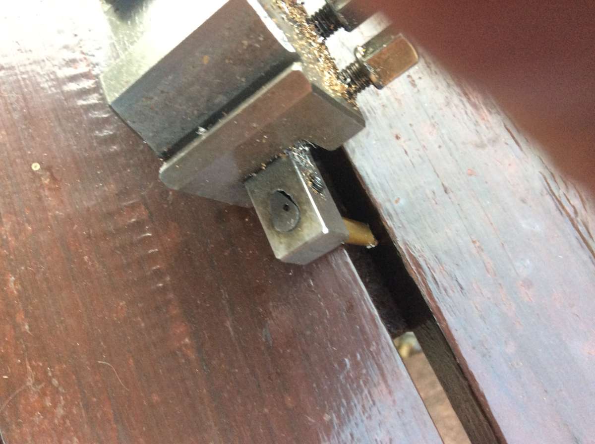

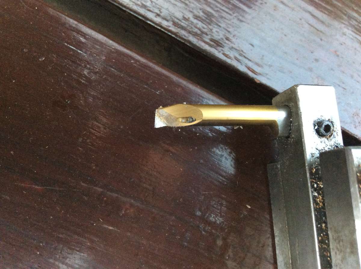

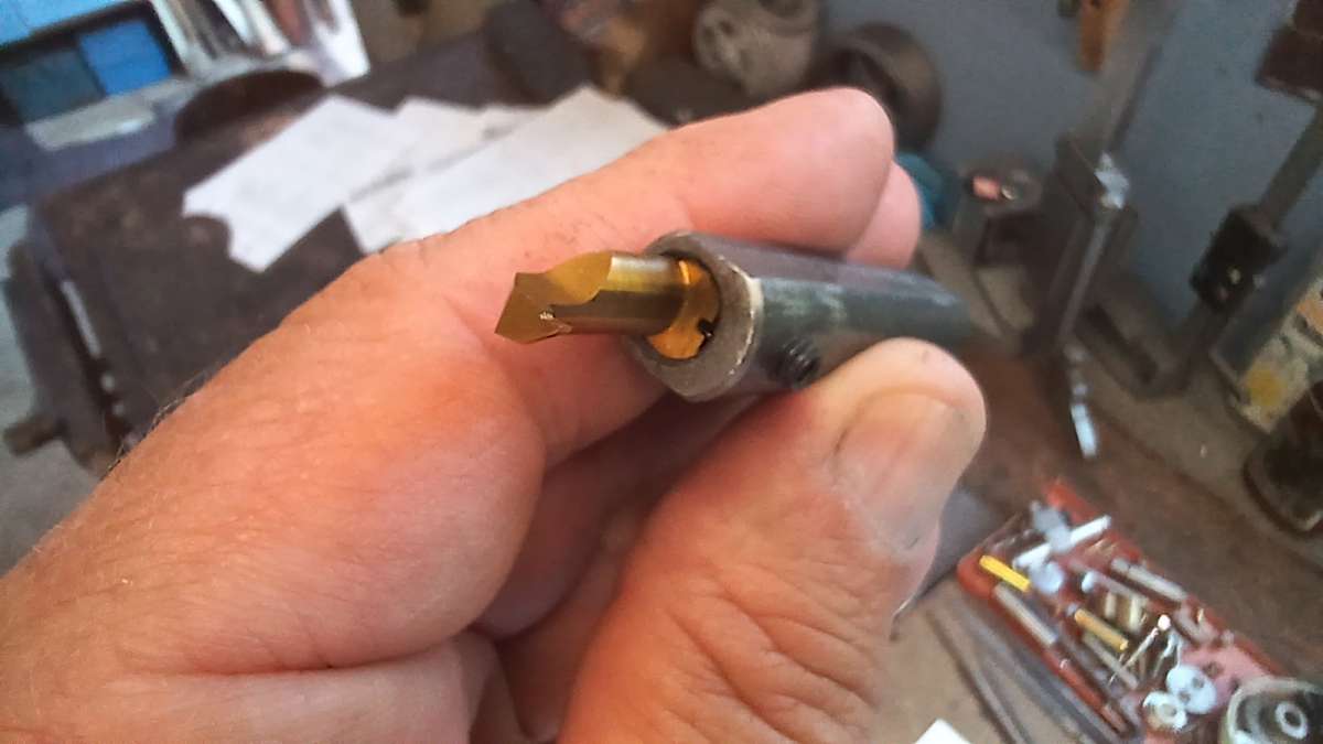

        I was given a few similar ones though they have a different shank profile. Made a simple holder and they work well, I use the internal grooving ones quite a bit.
        20250620_181558
        20221211_110001

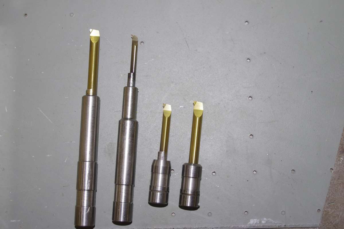

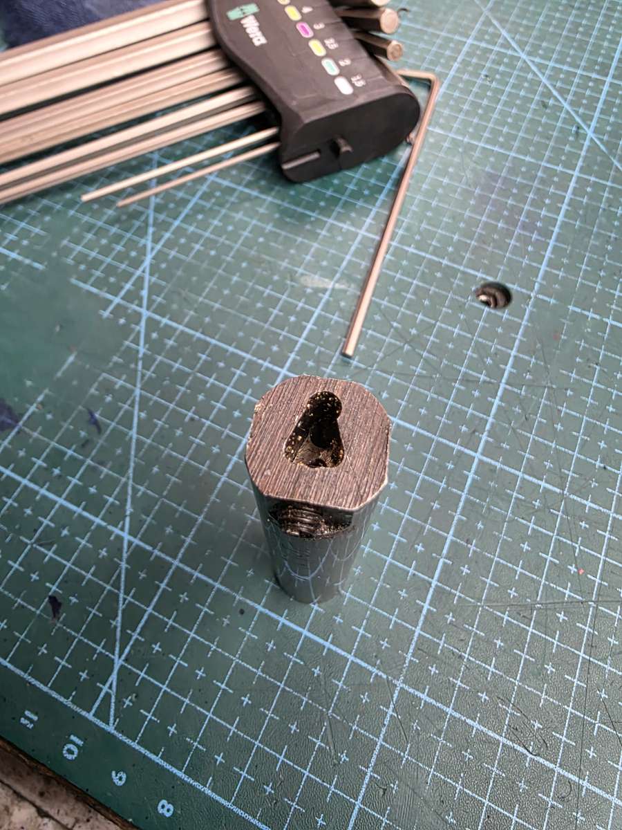

            yes they look like Horn bits and they work really well like Jason the recess ones are very handy. My holder is made by drilling/millig two holes at the correct distance then filing out most of thr excess and using a broken tool as broach clean out the rest and have a grubscrew at an angle to keep things still. sorry about the scarf but they get used.IMG_3915IMG_3914

              We have hundreds of them at the museum, about 20 Iscar that I bought years ago and the rest were Sandvik, brought in by Gary, boring, grooving and threading. All the same style shanks as Jasons. I have added Densimet tungsten shanks to some to use in the mill boring head as well as in the lathes. We can bore down to about 4mm diameter.

                  Here is a thread from a German forum with dimensions and various ways to hold the Horn 105 system bits. I have a couple hundred of them I bought used but re-sharpened, they are very handy
                  Most browsers have an autotranslate option that works quite well.
                  https://forum.zerspanungsbude.net/viewtopic.php?f=59&t=44478
                  and a .pdf of holders at:
                  http://herbert-schmitz.net/Zerspanungsbude/Horn.pdf
                  Wade

                    Peculiar dimensions on the inscribed diameter eg 2.467mm and 4.771mm ??
                    Bob
                    #803936
                      The scaling of the photo is probably a bit off which gives those numbers, the second link gives 4.8mm and 2.5mm for the hole so may also be some clearance as it is the two flats that make contact. Had they been US made I might have said 3/32 and 3/16

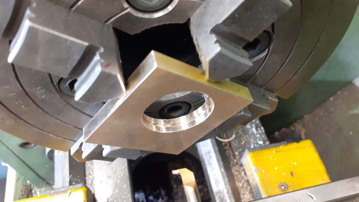

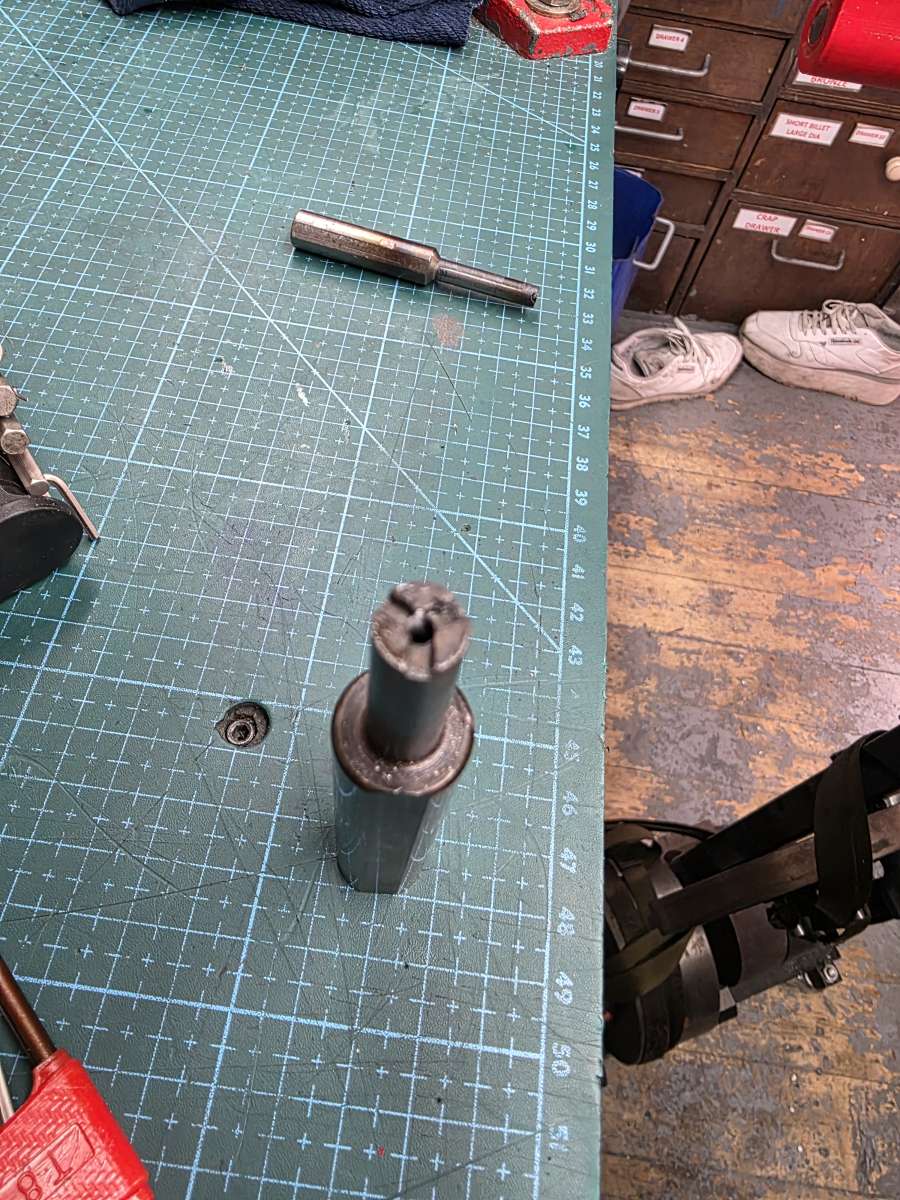

                            I have loads of these bits for boring, threading and grooving. We used stacks of these at work, the used ones found their way home, just needing a tickle up with a CBN wheel.
                            I milled the profile (badly but it worked OK…) in some holders.
                            20250621_08482020250621_084605
                            I did a bit better job for some other inserts…
                            jimb 20250621_084826

                                  I took a picture of some that had been fitted to Densimet (tungsten) shanks to be used in the mill boring head, they are Loctited in so they will be easy to replace if needed. We have all the sizes of holder for the lathes, they use grub screws to hold the mini bars.
