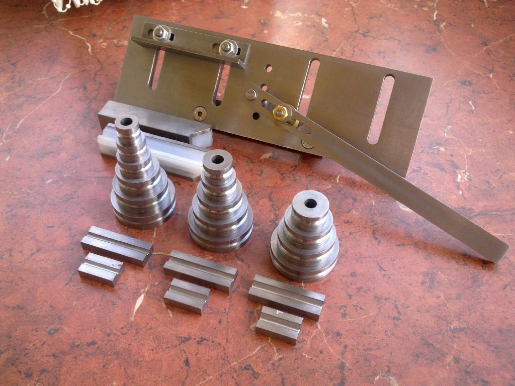

                  I have a set of mini bending springs like the ones mentioned above which work quite well for simpler pipe bends. I also made a mini bender which has proved a joy to use…..the plans were posted on Model Engineering Website a few years back.

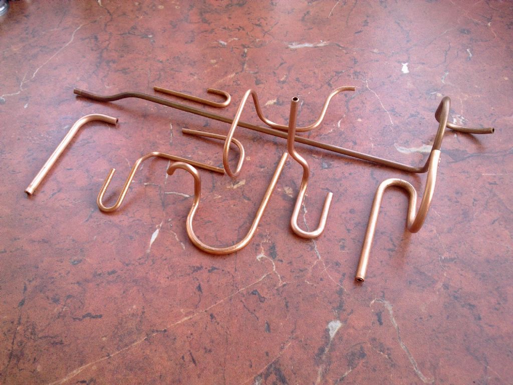

                                I have one of the original CZ metal benders. Never tried it for a continuous close spiral but likely to manage everything really well. Chronos have recently re-invented it – at a cost of around £104. Mine was just over £30 when new and is a magic little tool. I have made a couple of extra mandrels when needed.
                                **LINK**
                                #453141
                                  For the Stuart the bends are a lot tighter than most commercial benders can go down to. For similar plumbing I have used various end feed plumbing fittings that can be cut down and silver soldered to straight lengths, things like street elbows, full and half crossovers are the most useful.6, 8, 10, 12, 15mm etc.
                                  Another option is to make the bend from solid with a couple of well positioned holes drilled with a ball nose milling cutter and again solder the pipe on before shaping the external profile, this is 6mm OD with a 2mm internal "bending" radius.
                                  Edited By JasonB on 20/02/2020 07:12:33

                                    I have several different benders but the Dubro is by far the best for small sharp bends.
