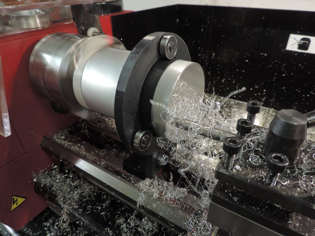

                        #387778
                          Here's an alternative approach…
                          #387790
                          Ian P
                            @ianp
                            This was a quick lashup on a Boxford. (Tailstock and carriage obscure where the contraption is fixed to the bed)
                            Ian P
                            Edited By Ian P on 27/12/2018 10:48:32
