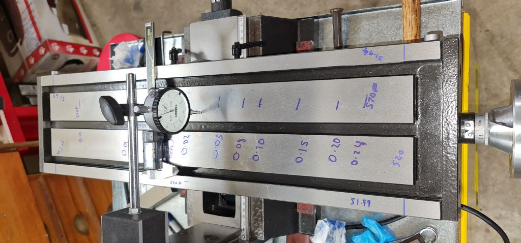

      Hi, I have finally got around to assembling my mini mill, which originally was a lathe/mill combo. I never used the mill part as it was intended. So saw a milling table that matched exactly the one in the parts catalogue. Basic X and Y axis.
      On assembly I first wanted to check that the table ran parallel. As in when you wind the table in the X and Y axis. We can ignore the column as I will tram that later.
      Issue is I find that over my full range I see 0.2mm increase over 580mm of travel. In fact for the first 250mm of travel its only increased by 0.01, then from 300 mm it increases exponentially. See first picture.
      The Y axis has 0.03mm increase over 200mm (I think this is acceptable?)
      If I lean on the table at one end fully extended I get about 0.04mm movement.
      So questions;
      1. Is the X axis acceptable for a home hobby work
      2. Is Y axis ok
      3. Is there any adjustment that can be made?
      I did stumble across an article in MEW 68 October 2000 page 30 "The Vertical Mill as a surface grinder" by David Machin where he has a table that shows .003" (0.076mm) which to him was very disappointing. But table looks to be half my size.
      I might have a go at reproducing what he did to flatten my mill but perhaps that might be out of my league.
      Thoughts comment welcome, pictures in next post below.

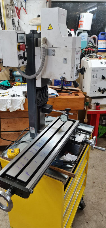

          Picture of the table and measurements
          [url=https://postimg.cc/8sz6BXn3][img]https://i.postimg.cc/8sz6BXn3/20220511-165452.jpg[/img][/url]
          Picture of the mill in question
          [url=https://postimg.cc/G4GW7Q5w][img]https://i.postimg.cc/G4GW7Q5w/20220511-165503.jpg[/img][/url]

                    Here's Peter's mill – made from the head and column of a combo mill/lathe plus a milling table.
                    The setup is flimsy compared with a real mill and I suspect everything is flexing under it's own weight. A stiffer support, such a sturdy bench or a proper machine stand, might help considerably.
                    The figures aren't good, but the mill is usable for small distance cutting, where the error is low, provided it's not flexing. If the problem is flex, cutting will make it worse.
                    It's unusual to load a mill with work as big as the table, most of what I do is over about 200mm.
                    I advise against plunging into measurements as the first step because they're difficult to get right. It's extremely easy to lead oneself up the garden path due to faulty measuring technique. Best thing is to try see how well or badly the machine cuts metal. If results are acceptable, job done! If not, the work piece will contain good clues as to what's wrong. Following up the clues measurement is next the step.
                    Don't worry about Schlesinger Limits. They apply to professional equipment, not hobby compromises!

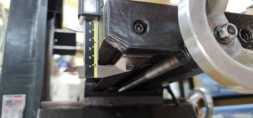

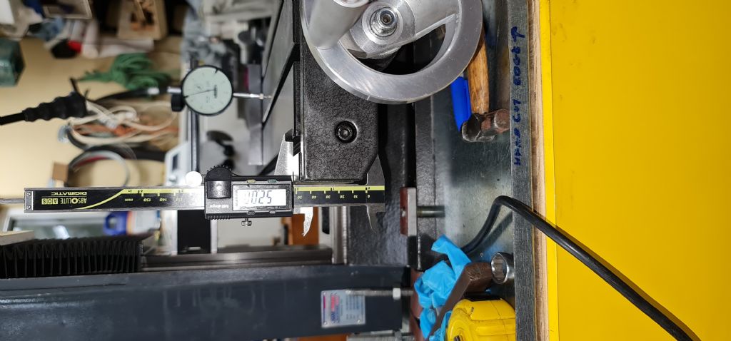

                                      Hi, lots of responses so that is greatly appreciated so I will try and answer most of them.
                                      • @Pete Rimmer, Old Mart and others : I measured the four corners with digital caliper and it seems there is a thickness increase from one end to the other. Looking at my mill as per the picture above, in order from top left 51.74m, top right 51.69, bottom left 51.99 and bottom right 51.94. I equate that to 0.20mm difference between ends. This matches what I am measuring on with DTI. The table thickness increase from top end to the end facing you in the picture.
                                      • @silly old duffer: Yes its not a real mill more a hobby/mini mill so not a precision machine, but I would like to try and get it close to tolerance before I started to machine. The base is on 1.5 inch cross ply, sheet of steel, then top of the workshop trolley. The base is not sitting on the wheels, its on 2inch pipe with reinforced steel. I copied the design of Robin Renzetti who built a granite surface plate stand. As well as Stefan Gotteswinter has done similar. As I am measuring the machine in static form I would not have thought this would have impact on measurements?
                                      • I will strip and clean the dovetail faces and gib then re-assembly in case there is gunk in it.
                                      • Finally it I might be chasing a lost cause here for the cost/value of the machine and just work around the uneveness of it.
                                      Photo of how I measured it.

                                        Peter, you are measuring across the full width of the table, including the dovetails – the bit you need to measure is from table top to the flat ways 'underneath-of-the-table-top', the flat surfaces that support the table on the shears above the dovetails… ..the dovetail bit doesn't matter..

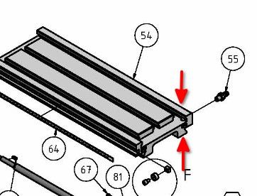

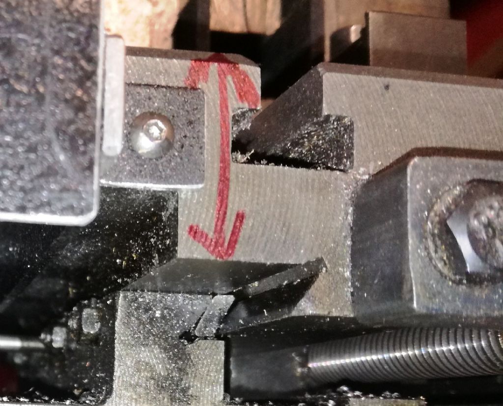

                                            Hi Peter, as DiogenesII says, don't measure to the bottom of the dovetails, you should measure where I've marked with the red line with arrow heads in the photo below and you can see where the table makes contact with the base on the flat surfaces.
                                            The bottom pf the dovetails shouldn't be actually touching anything along their entire length and won't matter if they are not the same measurement at each end.
                                            Regards Nick.

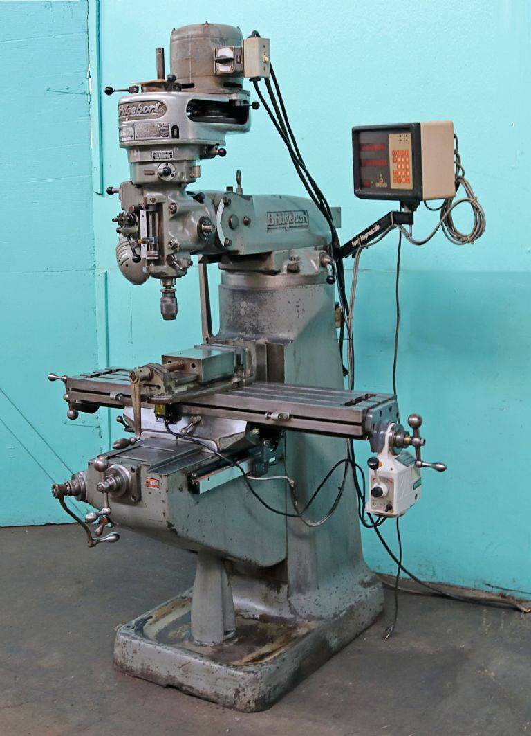

                                              6. Medium professional mill of which the Bridgeport is perhaps the star example. By my standards a Bridgeport is wonderful, but professional users sometimes complain they're a bit flimsy. It's all relative!

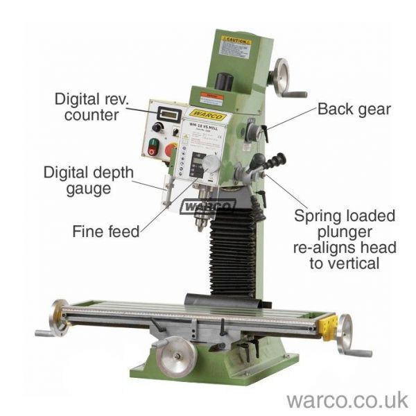

                                              The typical hobby mill configuration is functional, but relatively light. Picture stolen from Warco – a WM18, which is about as big as this layout can get before the head lift wheel is too high to reach!
                                              This type of mill is pretty spindly compared with a stubby heavy Bridgeport, which also comes with stiffer design features such as the knee.

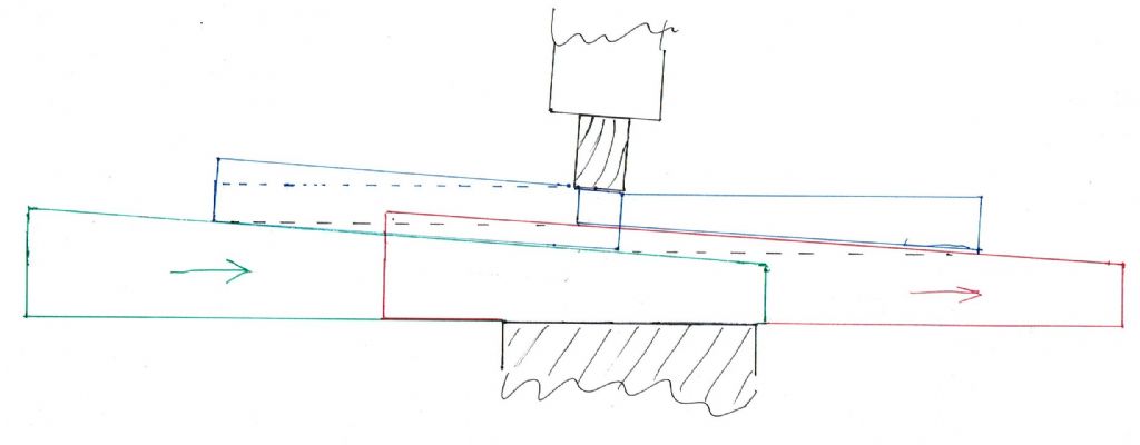

                                                      Hi Dave Halford, it is my understanding that Peter believes his table is thicker at one to the other, whether that is the ways and the table not being ground parallel to each other, will make it tapered. Looking at my crude and rather exaggerated sketch below, tramming the head in any way or leaving it square will not fix the problem, because as the table is moved towards the cutter, the gap between the cutter and the table will be reduced, or increased if going the other way and you will end up with the work with a taper cut in the opposite direction.
                                                      Regards Nick.
