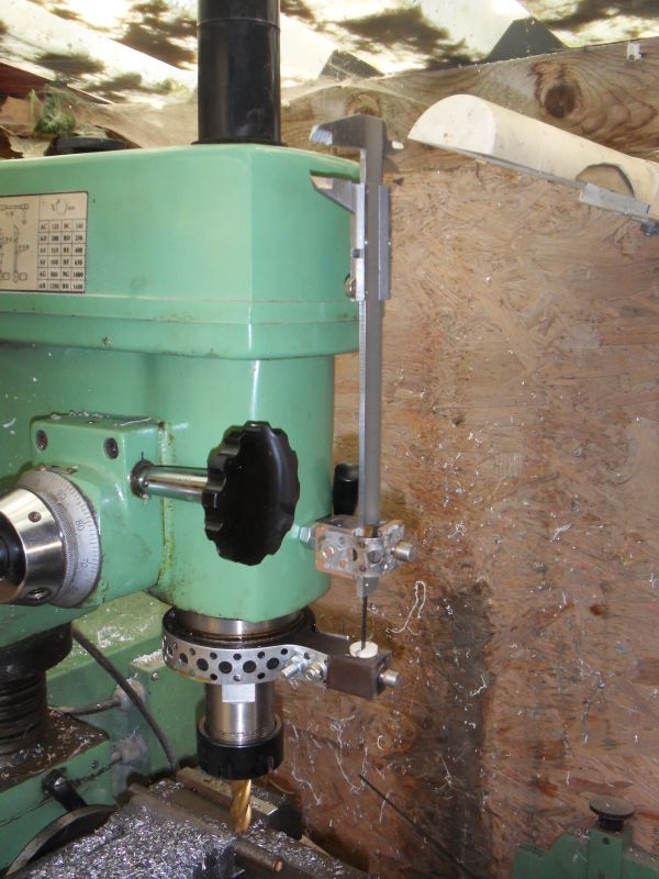

                        richardandtracy
                          @richardandtracy
                          I played about with the location from MichaelG and attached bracketry to allow a cheap & nasty vernier calliper to be attached. I used the idea of the depth measuring rod to attach to the quill, but had to replace the stainless rod that came with the calliper with a longer 3x1mm carbon fibre rod bonded in with epoxy. Both ends of the calliper can be moved to re-set the zero where necessary.
                          The fixture is as below:
                          No permanent mods to the machine were necessary, and everything is reversible.
                          I attached a gib clamp lever on the cross slide through a ready tapped hole in the side of the saddle, obviously put there by Warco for that purpose without ever mentioning it in the handbook. The cross slide dial is set up for diameter turning, and it's an effort to remember that the movement is half what the dial says.
                          Did my first real milling over the weekend (made 5 Tee Nuts – wow, so complicated!) and now can claim I'm starting to be a beginner. It was much easier with the cross slide clamp & the quill scale than it ever was before. Thanks for your advice. At some point I will fit a prop behind the milling head to prevent it rotating about the lathe headstock & improve the stiffness further.
