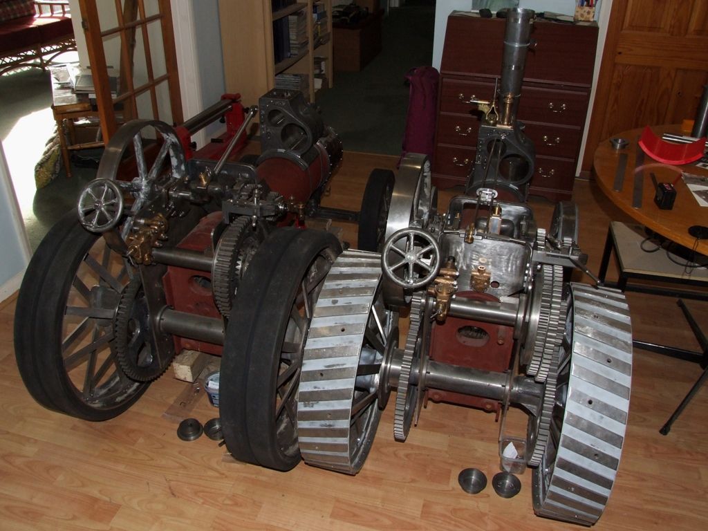

                                  William, don't know if you saw the recent thread about a drill press but like most on there I still have a drill press but 99% of my drilling is done on the mill. The main reason being it has a DRO and I can position holes far more accurately with that than I can by traditional marking out, picking up the punch marks etc. better to spend the drill press money on the DRO
                                  So worth bearing in mind as there are 648 rivit holes in each Superba rear wheel so that's 1296 holes as there are two bits of metal to be joined for each rivit hole and marking that lot out by hand would be a pig as would winding a table up and down that many times.
                                  I'd also add a Theil to the list of old iron that has already been suggested, though no quill

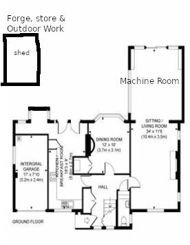

                                    Here's a pic of the shed, to the right of the house:
                                    Here's a pic of the garage – the ceiling is very high, in line with the rest of the ground floor ceilings (which are up a few steps from the surface of the garage):
                                    There was a thought to a G1 garden railway whose terminus could be in the shed, also!

                                      So looking at you pictures of your des res. I would be wondering on the viability of taking the shed down or moving it. Then removing the back wall of the garage or putting in a doorway. Then build a workshop on the rear of the garage.
                                      Steve.

                                        The window you can see between the shed and the washing pole is a vestigial utility room next to the kitchen (double doors) which spans the full width of the garage, rather than being the garage itself. I found a plan from the estate agent which hopefully illustrates the rough layout:
                                        The reference to building a new purpose-built outbuilding earlier on would be the nuclear option. Clearly, if I can find a way to make the shed work, then I'll use that. If I can't, then I'll use the garage – and if I can't use that, then the outbuilding would be considered.
                                        Seems that electrics are about £700 for running the armoured cable from a consumer unit socket (assuming spare) and half a dozen sockets and some lights. I guess the thing that is worrying me the most is the stability of the floor – I could rip up the floorboards and pour concrete down between the batons I guess?
                                        Edited By William Ayerst on 29/03/2021 16:15:32

                                          Spoilt for choice! As a divorced man, I'd consider using the extension and the shed:
                                          Would be possible to run the track into the machine room as well – very convenient. Andrew Johnson keeps traction engines in the living room – he's my hero!

                                              SOD there is absolutely no way I'd get away with that. I have already obliged myself rights to a garden railway, dedicated workshop and classic car storage – I think any more may be beyond the pale.
                                              Am I right in thinking the shed should in theory already be on a concrete slab? So pouring another 3" or so to replace a boarded floor should in theory be more than stable enough for a mill?
                                              The idea of running a ground level 5" Gauge loop around the garden appeals greatly and having 'everything' in the workshop-shed would be ideal if it could be managed.

                                                  Posted by William Ayerst on 29/03/2021 16:48:50:
                                                  Am I right in thinking the shed should in theory already be on a concrete slab? So pouring another 3" or so to replace a boarded floor should in theory be more than stable enough for a mill?…
                                                  Needs looking at because sheds can be almost anything from an earth floor, paving slabs, concrete raft, or suspended on wooden rafters. Not done it myself, so can't comment on how well it works, but at ground-level machines only need to be supported directly under their feet, which can done with concrete blocks or brickwork. Once the weight is supported with a pillar or whatever, it's only necessary to level the machine on top. To make it easier to move a heavy machine into position across a weak suspended floor, 1" plywood sheet could be used to spread the load, and itself supported by strategically placed pillars, perhaps temporary. Much depends on the floor and how easy it is to get underneath.
                                                  Provided the load is spread by a thick plywood sheet, paving slabs or breeze blocks laid on sand will take a lot of weight. The goal is avoid bending wooden beams or have the concentrated weight of the machine punch a hole through a weak spot. A machine weighing 1000lbs with four 1" square feet will put 250psi onto the floor: the feet are made 6" x 6" each, the pressure is less that 10psi, and a thick plywood sheet will spread that out even more.
