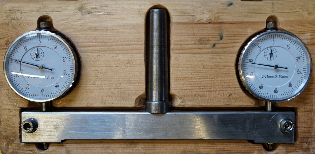

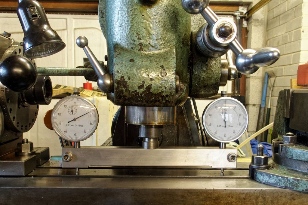

                    Tramming my mill(s) became much less daunting after I'd made one of these gizmos.
                    It's made roughly to a design by John Moore (Bogstandard), though mine has an MT2 arbor to suit both my Centec and Dore Westbury mills; his fitted directly into his milling chucks, so had a parallel arbor.
                    It's slightly different to most of the commercial ones, in that it's self calibrating.
                    To achieve that, it's essential that the arbor is exactly perpendicular to the bottoms of the two little feet.
                    I ensured this both by careful boring and assembly, but also by spinning the final thing in the Myford's gap bed space.
                    This limited the length, but it seems fine in use.
                    The arbor was fixed directly in the Myford's spindle with a drawbar, and the feintest skim taken off the bottom of the feet.
                    Note that the final fitting of the clocks, has the tubular outer section all contained within the bottom alloy bar; it actually only goes about 2/3 of the way through.
                    This means that one can stand it on a known flat surface, before fitting to the mill's spindle, and zero the clocks exactly. Effectively it self-calibrates, without needing to go through the normal rigmarole of turning the clock's supporting arm by 180° and constantly re-checking.
                    To use, fit the tramming gauge to the mill spindle and raise the table (or lower the quill as appropriate) until the stylus on each clock touches the table.
                    Tilt the head to correct any error, which shows as the clocks will display different readings.
                    One can monitor for angular movement whilst nipping up the mill head fixings.
                    Here's a couple of photos, there are more in the album;
                    https://www.model-engineer.co.uk/albums/member_album.asp?a=55535
                    Note the differing clock readings showing a tilt anti-clockwise.

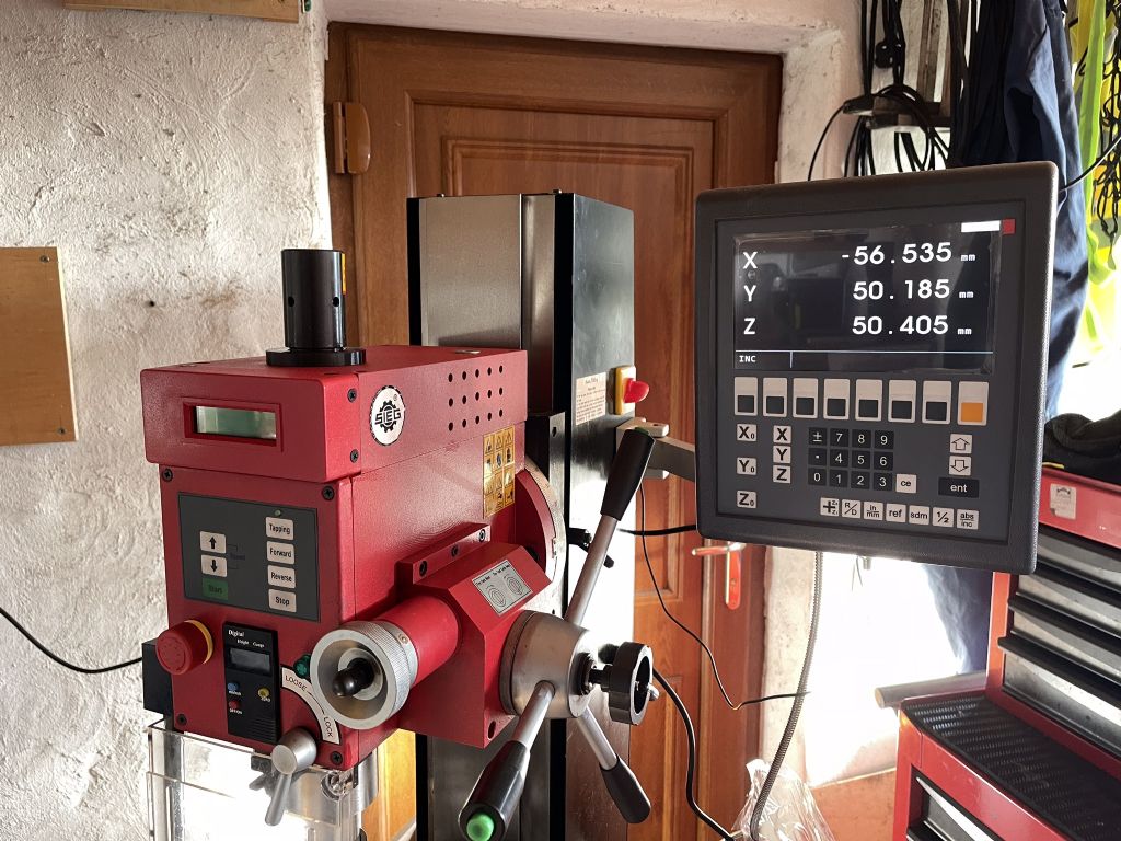

                      I went through the same dilemma last year and having in a past life visited the Sieg Factory in Shanghai opted for the SX3 mainly due to the build quality and low down Z Axis adjusting wheel. So far it's been faultless.
                      I fitted a good quality 3 Axis DRO with magnetic readers from Machine DRO and have a photos and details of how it was fitted.

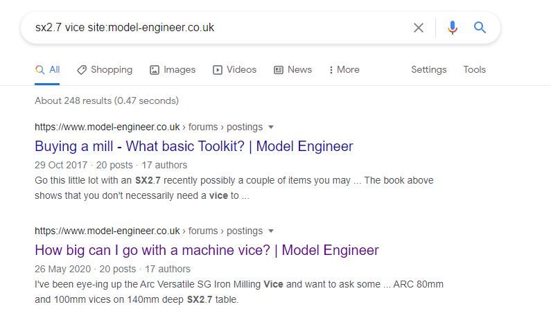

                                                  The google search box on the home page is the best to use and will give similar results to DuckDuckGo.
                                                  I've not tried a new Knob equipped machine but if it's anything like my other machines with them will be nicer to use than the up/down buttons to change speeds
                                                  #539994
                                                  Green Techie
                                                    @greentechie
                                                    Hi Jason, I tried the search box with the default settings but I got "There were no exact matches for the phrase 'sx2.7 vice'".
                                                    I think part of the reason I prefer the dial (apart from being quicker) is that as a software developer I'm stuck pushing buttons most of the day!
                                                    #540022
                                                      Must be those Techie fingers hitting the wrong buttons smile p, second hit down this list from the homepage search box
