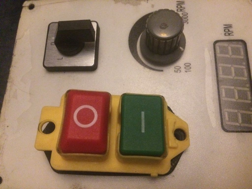

            I suspect this is something called a no volt relay that is not working. They are usually built into the start/stop switch and drop out if the mains supply is interrupted (so the machine doesn't auto start after a power interruption). It's a pointer if the unit only runs while you hold the start button down.
            Can you post a picture of the on/off switches?

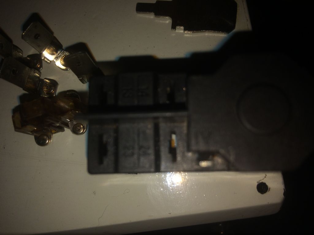

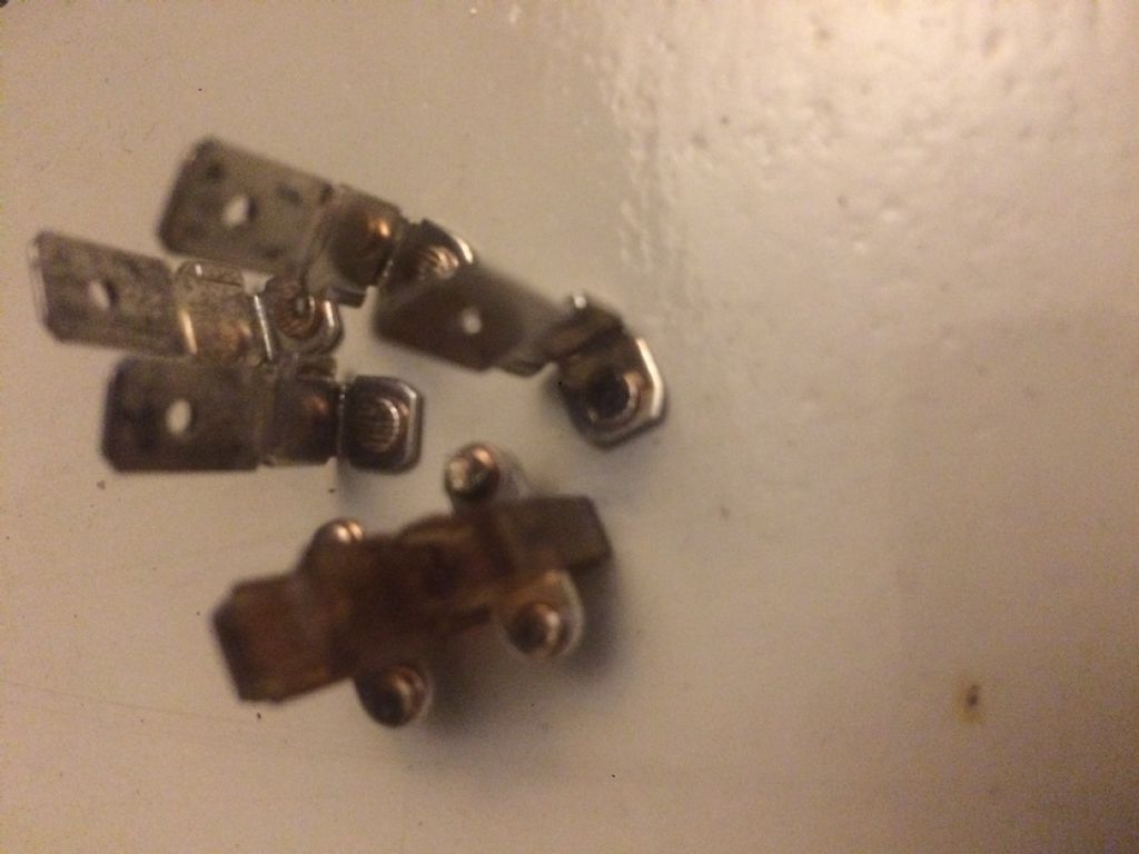

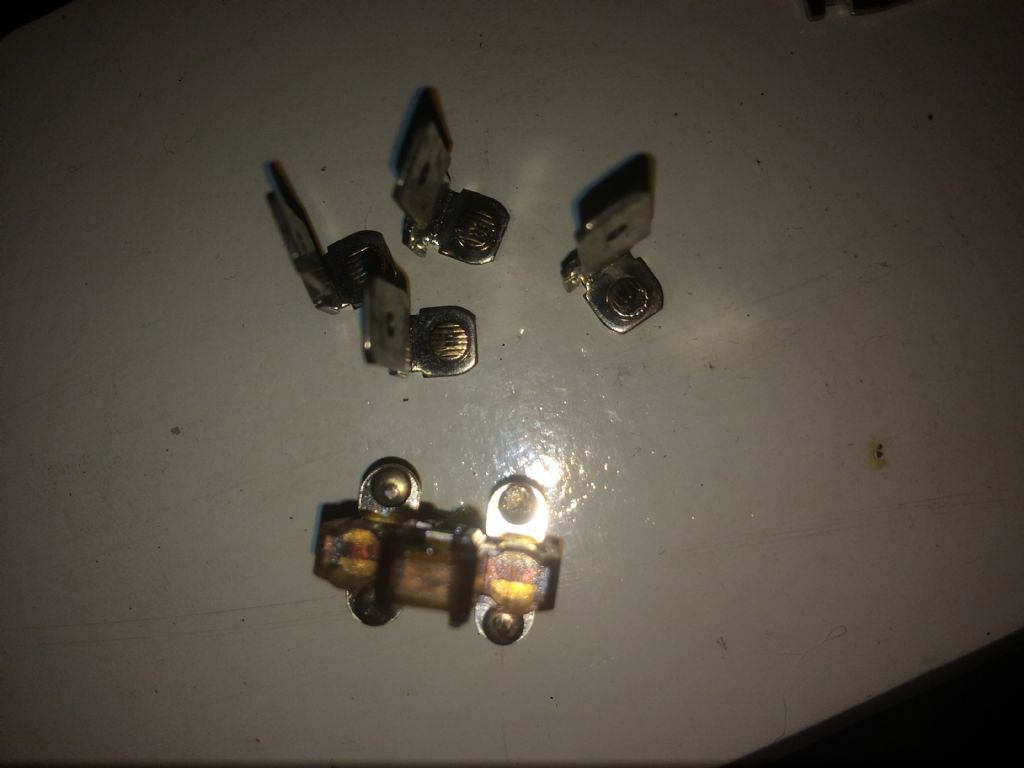

                  img_2877.jpgimg_2876.jpgimg_2873.jpgimg_2872.jpgThankyou for the advice,
                  The guard switch is still in place, with the switch pressed down the mill doesn't light up or move at all, only once it is depressed does it work.
                  I have ordered a new NVR which should hopefully arrive tomorrow. I have (hopefully) attached some photos of the current NVR, i took the unit apart to have a look and noticed there is some scorch marks between the contacts, one in particular looks really bad, could this possibly be the fault?

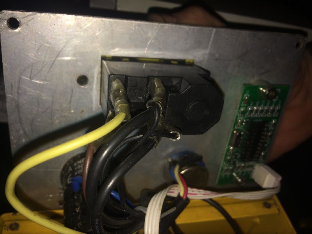

                    Jim Mason
                      @jimmason14480
                      If that thinner black wire in the right of the photo on the switch is on a fifth switch connection then I'll bet pounds to pennies that is the supply to the NVR, and the NVR had gone to meet it's maker. A new switch should sort it.

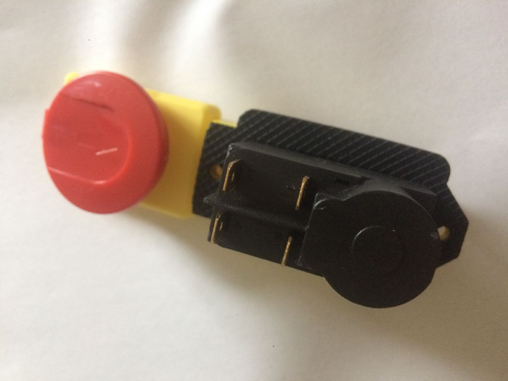

                          Ian Patrick 2
                            @ianpatrick2
                            Hi all,
                            New NVR arrived today, however there is only 4 possible connections? Would the 5th connection (To create the magnet) be internal?

                            Ian Patrick 2
                              @ianpatrick2
                              Hey all, just a update!
                              I tried the new switch, removed the extra wire, hoping it was an internal connection on this one and boom, worked!
                              So must of been a worn out NVR
