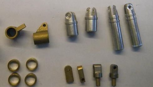

                                The parts that will need milling are not very large, so I think the range of movements I'll be able to get on the various slides will be more than enough. Here's a pic of the parts which need some milling done on them – the aluminium leg ends are sized to fit into a 1/2 inch brass tube. Milling cutters will be held in my ER32 collet chuck. There's nothing very heavy duty involved either, so I think I'm going to obtain a vertical slide and give it a go. I'll look into buying a milling machine at a later date when I have a bit more cash to spare.
                                Duncan – An interesting project – It might just fit the bill if I can find the parts at reasonable cost.
                                Thanks for the help and advice!
