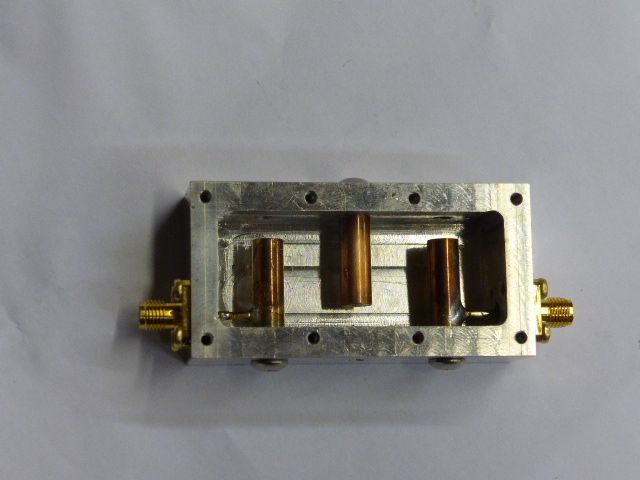

      I've milled a cavity in some Aluminium plate 22mm wide x 56mm long and 15mm deep. The corner radius is 2mm. I need to take a couple of finishing cuts, whats the best technique to get very best finish? Clue – 22mm is a quarter wavelength
      I've obviously got a long series 4mm cutter, which is a standard helix carbide type and the only other cutter I have is a 5mm high helix version (which would obviously leave a bit of cleaning up for the corner radius. The depth of the cavity is the critical dimension.
      Steve

        Anonymous
          A CNC mill, climb mill, and use a 3mm cutter so you don't get chatter in the corners. thumbs up
          Failing that I'd leave about 10 thou or so on width and length and climb mill full depth. The depth can be set accurately using the knee, or quill, depending upon the mill type.

          Sam Stones
            @samstones42903
            Hi Steve,
            Sounds like 'Plumber's radio' to me (wave guides and cavities?)wink 2.
            Climb milling; slow feed; plenty of turps.

            Muzzer
              @muzzer
              Perhaps worth trying the high helix cutter? 55 degrees and higher seem to be recommended for best finish in loominum. Also – is it worth looking for a more machining friendly alloy? It wouldn't be cheating but could make the job easier. When you say corner radius, presumably that defines the cutter diameter.
              Where are the feeds and speeds coming from? And are you using an adaptive toolpath to control the load on the cutter?

              Steve Withnell
                @stevewithnell34426
                Posted by Andrew Johnston on 26/10/2017 22:23:18:
                If 22mm is a quarter wavelength why is the 15mm depth the critical dimension?
                Andrew
                Thanks Andrew.
                I keep avoiding sending Ketan a wedge for a KX1, which would be ideal for this application The 22mm is not critical because the resonators are tunable. The depth of the case affects the impedance and bandwidth of the filter (etc). The cleaner the finish the better the overall performance.

                Steve Withnell
                  @stevewithnell34426
                  Posted by Sam Stones on 26/10/2017 22:25:30:
                  Hi Steve,
                  Regards,
                  Sam
                  Interdigital Digita Filters – I've made a few at 1.3GHz and this is the first I've attempted for 3.4GHz. I thought with less metal to remove it would be easier, but I've also a lot less 'elbow room' with this one. I shall break out some turps! (I've been working with Parafin and Neatcut, but the Neatcut ends up in sticky mess).

                                  Steve Withnell
                                    @stevewithnell34426
                                    All done – next step is to see if it performs!. I ended up polishing the sides with the flat of a file, I still had some noticeable ripples in the walls. More practice is probably in order.
