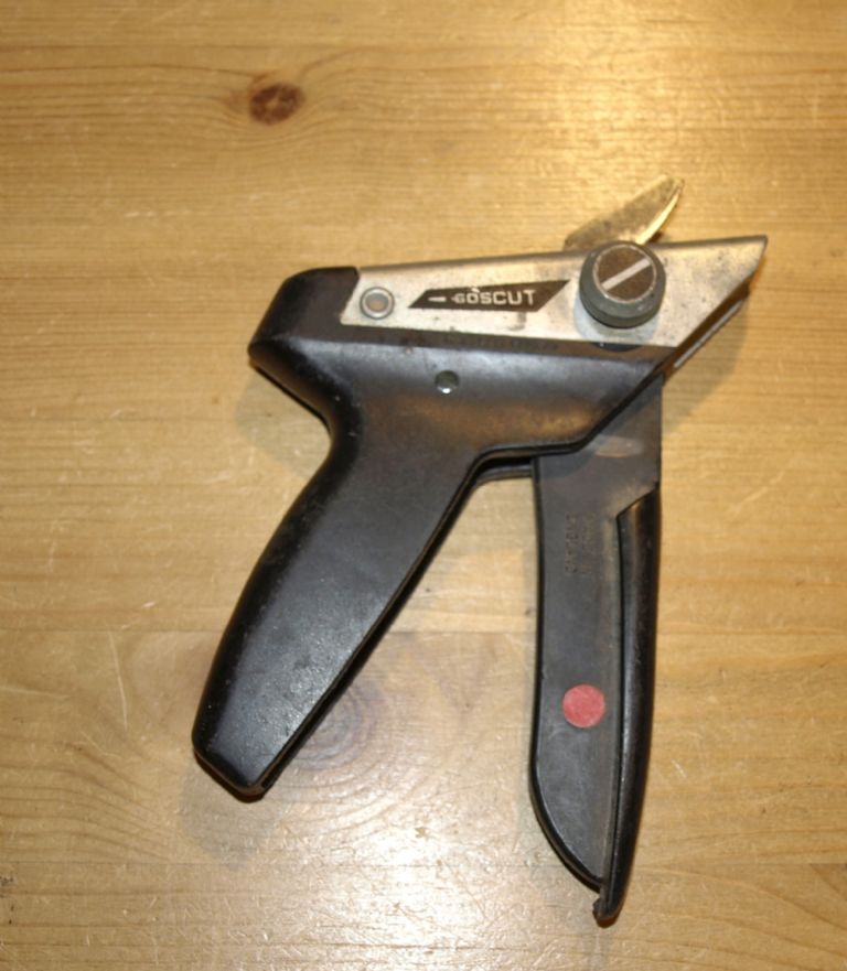

                                            Anyone remember the “Goscut”, that could manage 1.0mm bms easily.
                                            (sorry to digress).

                                              #77555
                                              Anonymous
                                                Posted by The Merry Miller on 09/11/2011 15:03:09:
                                                Len. P.
                                                No, never ‘eard of it; obviously not old enough!
                                                What is it then?
                                                Regards,
                                                Andrew
                                                #77556
                                                Clive Hartland
                                                  @clivehartland94829
                                                  It was a hand shear that had a central blade and the body acted as the anvil and you progressed the cut and a long curling piece of metal came out about 2mm wide.
                                                  It was a very tiring tool to use for long periods and I am sure it has caused me a lot of trouble with my wrist.
                                                  You could change the blade for a different cutting angle. ie curves.
                                                  You were able to adjust the width of the slot to accomodate the curves you were cutting.
                                                  Like a lot of tools it came out as a handyman thing and I bought one and had it for years but I dont know where it is now.
                                                  It would cut 1mm steel or 1.5 Alu. Dont know about braas though.
                                                  Clive

                                                    #77570
                                                    The Merry Miller
                                                      @themerrymiller
                                                      I’ve found it!
                                                      The cutting edge had very fine teeth, and this blade was one of three each used for different materials. Where the other two went heaven knows.
                                                      Len. P.
