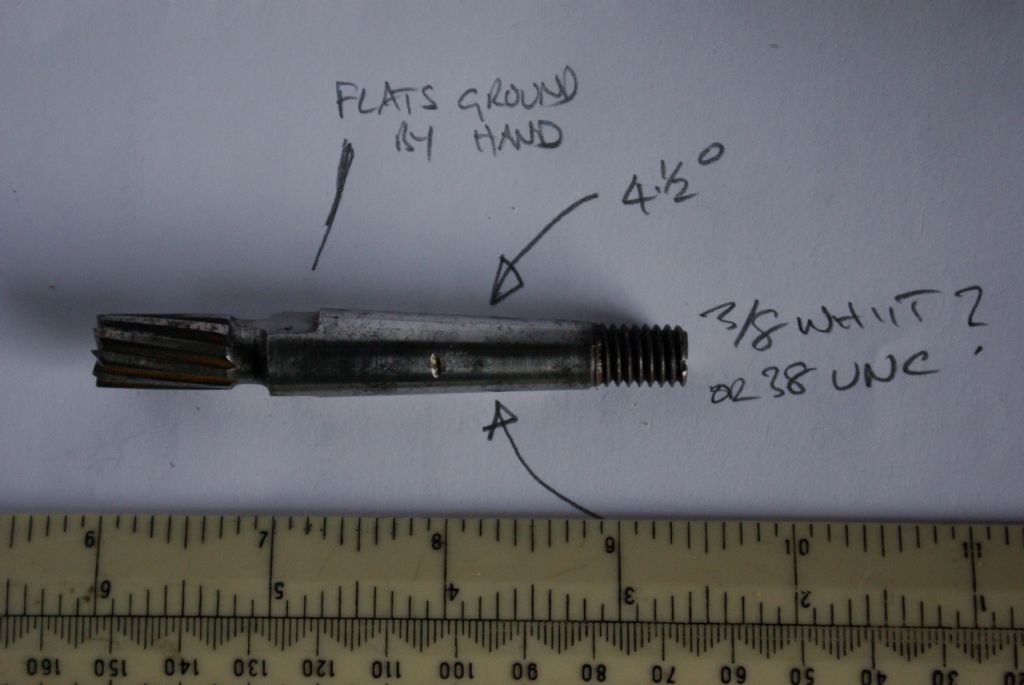

      Amonst my late fathers "junk" I've found a tin containing numerous milling cutters. Unfortunately all but one are heavily rusted due to years of damp. One, however, wrapped in wax paper survived, stained but still sharp.
      see below
      I'm curious to know what it might have fitted as I've been unable to identify the taper (per Machinery Handbook).
      As I don't have a milling machine I propose to bore a matching taper into a piece of 3/4" bar then after pulling the cutter firmly into the adapter machine the whole beween centres so that I can use it in a 3 jaw chuck

          Are you sure it isn't just Morse taper? Perhaps #1?

            Hi Murray,
            The first thing I did was to try it in my wood lathe which is MT1.
            I rattled, in that the narrow part never made contact with the sides before the thick end made contact
            ie I think the taper is too blunt for it to be a morse taper.

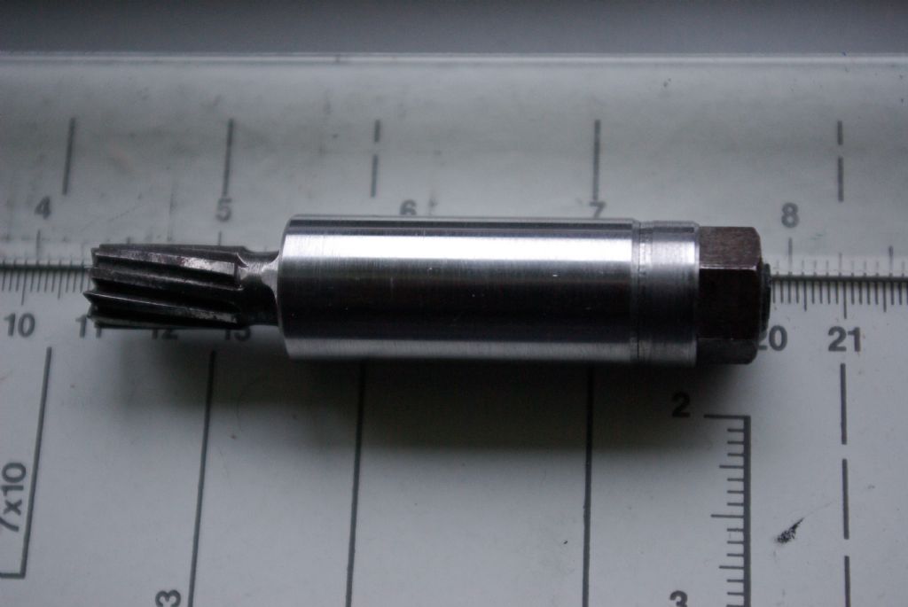

              Hi all,
              I descided I could spend an inordinate amount of time trying to find out what the taper was, when all I wanted to do was use the cutter.
              So, plan B, bore a tapered hole to match the taper and lock the cutter into it.
              Mount between centres and true up the outside.
              Job done – works lijke a dream

                            I've now managed to mill a 1/2" slot across a piece of mild steel. I have no use for the slot – the whole exercise is part of a learning curve of what I can do with a small lathe.

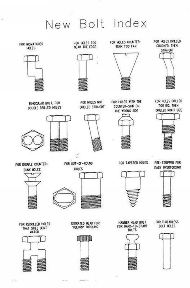

                              Found the poster :-
                              This or very similar was on the maintainance department wall and apprentices were sent to the stores for one off the list, often to be obtained together with a long stand
                              Enjoy
