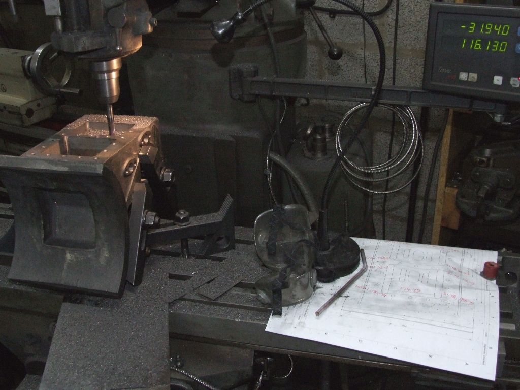

                                                A few more notes:
                                                There's no fundamental reason not to use high flute count cutters on aluminium. The advice to use 2, or possibly 3, flute cutters arises from the fact that aluminium alloys are easy to machine and so feedrates can be much larger than those used for steel. So there is more swarf. Using fewer flutes helps prevent jamming of the swarf in the flutes. For instance the manufacturer of my cutters recommends, for a 6mm cutter, 3800rpm and 210mm/min in steel cutting full width and 0.5D deep. But for aluminium the recommendations are 7600rpm and 440mm/min, cutting full width but also 1D deep, so roughly four times the removal rate. Interestingly the feed per tooth is only slightly higher for aluminium. This is what happens when aluminium swarf clogs flutes:
                                                No idea why SoD says don't use suds on aluminium. On the manual mill I machine aluminium dry, or with the odd squirt of WD40. The WD40 doesn't lubricate, or do much cooling, but it does help prevent swarf from gumming up the cutter. On the CNC mill I use suds flood coolant, mainly to wash away the swarf. Recutting swarf is a quick way to kill a cutter. I've never used paraffin on anything.
                                                You don't need long flutes to cut deep pockets. It's unlikely you'll be doing a full depth pass, and if you do the cutter will deflect. A cutter with short flutes and large stickout will be stiffer than a cutter with long flutes and the same stickout. So less tool deflection. This pocket is 48mm deep and was machined with a 2.5mm stepdown and standard length flutes:
                                                I start with selecting a width and depth of cut and then select an appropriate chipload. Then a spindle speed appropriate to the cutter and material, and that then allows the feedrate to be calculated. The critical parameter is chipload, in mm/tooth, rather than feedrate. It's counterintuitive but increasing chipload is often a cure for chatter. When I first started using my horizontal mill I was cautious. Result, the whole machine shook, which was impressive given it weighs 3500lbs. Double the feedrate, and hence chipload, and it cut perfectly with no chatter or vibration.
                                                Andrew
