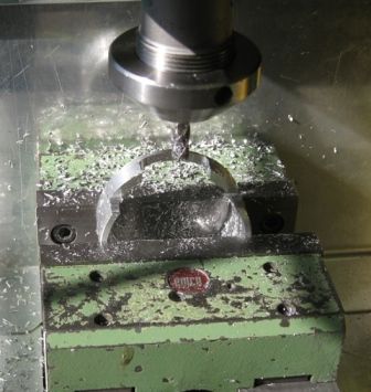

          Joseph Noci 1
            @josephnoci1
            A mill can do 95% of what a shaper can, but not vise-versa…
            How would you do this on a shaper? Or many other 'simple' mill tasks that are not just straight lines…
            Looking at your posts I get the impression that the work you do would suffer if you only had a shaper… If I really had to choose, I would choose the mill – and I think the VM30 is a not to shabby mill!
            Focus that rush of blood towards making the space for both!
            Joe
