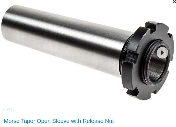

                        -Adaptors Sleeves/Morse Taper=Open Sleeve with Release Nut.
                        I am also looking at this, however what this exactly is and how it fits or replace the MT4 for ER32 I am not sure about yet. They said I may be able to get this but its not something they stock.
                        If somebody can explain what excactly this part is, meaning if I buy it will it be fitted with an ER32 chuck on an MT4 arbor, but with the nut(16mm) added, and just work-?

                            If you mean THIS EXAMPLE then, no, it won't do what you want. You would need to get a sleeve to reduce your MT4 to MT3 or 2 then fit an ER32 collet chuck with matching MT into that. You would still be stuck with how to remove the sleeve. You would be far better off, in my opinion, to obtain an ER32 collet chuck on an MT4 taper shank. Like this:
                            Then you're back to square one with the extraction problem! Though it shouldn't be a problem if you do it correctly.

                                Do you mean one of these, as sold by ArcEuro?
                                If so, it's no good to you. It's a reducer – a big MT taper on the outside, with a smaller MT taper inside. For example, a reducer with an MT4 outer an MT2 inner allows MT2 tooling to be plugged into an MT4 spindle. The MT2 tooling is secured and released in the usual way with a drawbar. The Release Nut pulls the reducer out.

                                      Although the sleeve from ARC will be no good to you NDIY was suggesting threading the body of your existing ER32 holder so an ejector ring can be added, not to use the actual item shown.
                                      I dare say if you don't want to thread the holder a pair of concentric threaded rings could be placed around the body of the ER32 holder and when screwed apart one would bear on the back of the nut, the other on the mill's spindle nose and pop the taper apart without loading the bearings.
