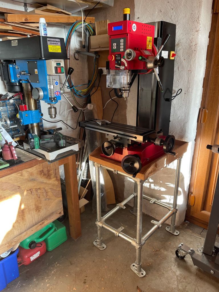

                I would use KEE or the Interclamp system from The Metal Store. They do free cutting of the galvanised tube so all you have to do is sort height width depth and any fitting for shelves. Free Delivery and it is all put together in minutes with a single Allen key. Shelf could be a double thickness of 25mm MDF glued together (could put a bit of sheet metal on the top if you require it.
                Size the tube to support the weight.

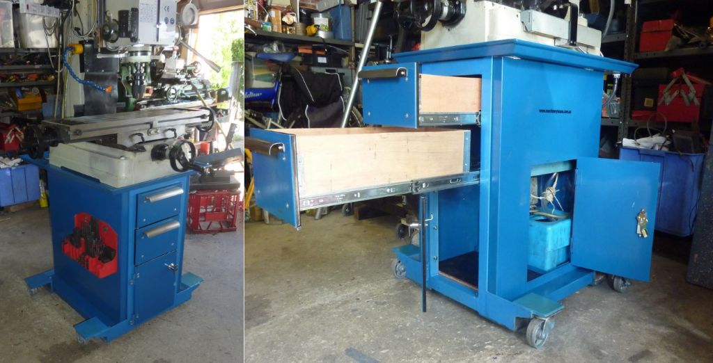

                    The Warco GH Universal milling machine looks like it is one of the many Rong Fu machines that are made in Taiwan. I have one that is sold in Australia as an HR-45 mill/drill and bought it with the standard base made from sheet steel. It is sturdy to support the mill but not overly heavy.
                    The mill base is bolted to a wider base with outrigger casters so it can be moved around my small workshop. It is stable when moving and operating.
                    The base had an access door at the side and I added a second at the front as well as 2 drawers. The drawers are mounted on extended slides, allowing full access.
                    Paul.

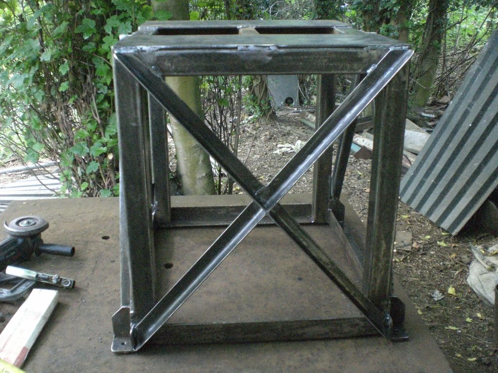

                      Hi HowardT, this is what I made for my Major and the GH version is only 20Kg heavier, basically it is 50 x 50 x 3mm square hollow section uprights and 50 x 50 x 6mm angle for the top and bottom frames, I'm sure you could build something similar with just angle iron and be bolted together.
                      You could also put outriggers and casters on like Paul has done if you so wish, but make sure they are outside of the mills footprint.
                      Regards Nick.

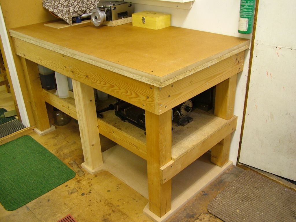

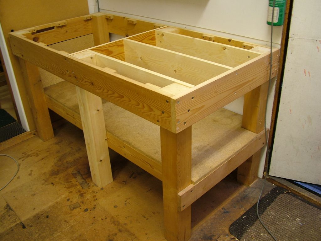

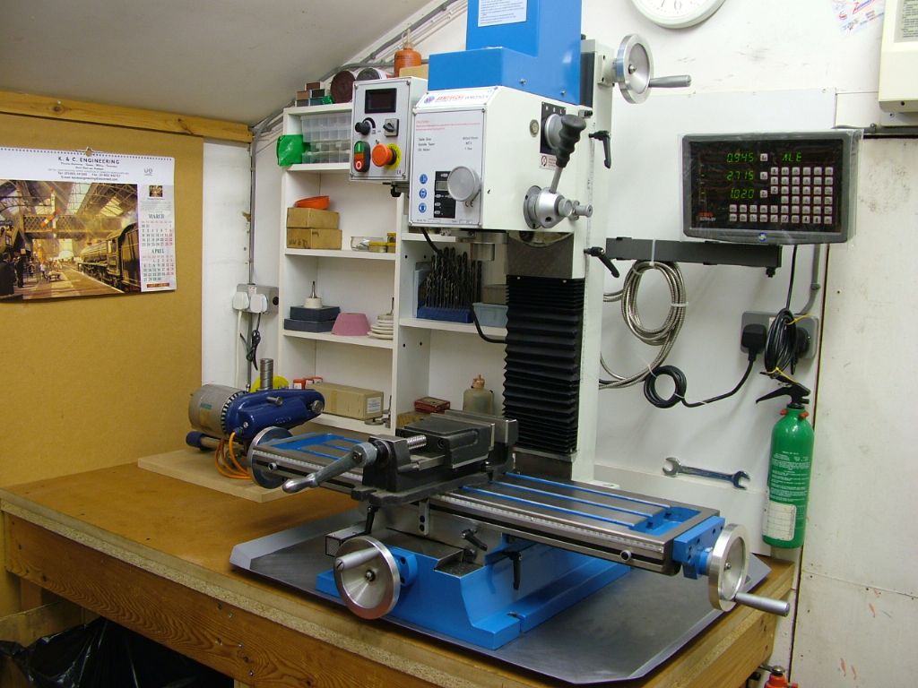

                          Howard, Your Warco GH apears similar to my Amadeal – not least in a birthday prezzy to yourself – had mine for my seventieth wink
                          Mine is mounted on a fairly strong wood bench – 4×4" legs and 6×1" rails originally, two extra legs and top rails added for extra support. The top is a layer of 1"MDF over the original 1" chipboard. This has proved to be sound and without movement for the last six years. Just been roughing out cast iron with rippa cutters – no issues
                          Just another option to consider……?
                          Enjoy your prezzie however you mount it – it was two years before mine actually saw any work but now I wouldn't be without it – it might not be a true 'universal mill' but does what I need.

                                          ab9ca583-c57c-4eed-8527-6230a42ed999.jpegAssembled in 15 minutes with an 8mm Allen key. Metal cut to size FOC by supplier.
