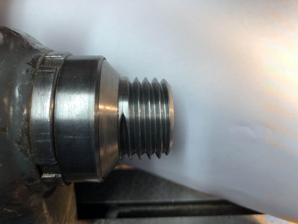

      Hello all,
      I hope I have posted this to the right thread. I am new here so please do let me know if I have made a mistake.
      I may have an insurmountable problem here, but I thought someone here might have some ideas.
      I am the very proud owner of a wonderful Swiss Mikron T-90 Clockmaker's lathe. These lathes have an unusual headstock screw mount for a chuck. I am finding it nigh on impossible to find a chuck with the correct backing plate and I certainly don't have the skills to machine one. Are there places I could have one machined for me? Any suggestions?
      Thanks so much,
      NIck

                    If you post details of the spindle nose thread and any spigot /face you may get further help from this forum.

                      I'm travelling up your way next week. Making a backplate should be a straightforward enough job.

                        Nick Palliser
                          @nickpalliser19088
                          Here is a picture of the spindle nose. I have asked Dr Samways of Anglo Swiss Tools if he has the exact parameters. I am waiting for his reply.

                            I'm working in London too. The last year I've been at E14, currently in Sw15.
                            What size chuck are you looking to fit?
                            #377320
                            Nick Palliser
                              @nickpalliser19088
                              I am looking at a 125mm

                                That’s a hefty Chuck for a little Mikron. I certainly wouldn’t go any bigger.

                                  The original Mikron 3 jaw was 110mm and the 4 jaw was 150mm. 125 should be ok i trust.

                                    Is the register the taper behind the thread as opposed to the parallel portion behind the taper?
                                    #377394
                                    Nick Palliser
                                      @nickpalliser19088
                                      Posted by ega on 24/10/2018 11:29:51:
                                      Please forgive my ignorance, but I don't understand what that means.

                                        Nick,
                                        The majority of lathes with screw-on chucks have a plain [cylindrical] register 'after' the thread.
                                        Yours appears to have a cone [which would be much nicer]

                                          The taper will be the register, it doesn’t make sense for it to be otherwise.

                                              The Mikron spindle seems to combine the advantages of both taper and threaded spindles.

                                                  If you have access to another lathe do the following:
                                                  Get a tube of micrometer blue (or other engineer's blue)
                                                  Bore a piece of stock so that it will pass over the thread and the OD register. This is a test-piece to get the taper angle set on your compound.
                                                  Make a template from card or take measurements to get the approximate angle of the taper from the threaded part. Use it to set the compound angle on the lathe.
                                                  Now cut the taper in the piece you bored.
                                                  Blue up the taper you cut and use it to take a print off the taper by pressing it lightly and giving a bit of a turn. Removing and replacing the test piece in a 3-jaw will not affect your results at this oint and there's no need to dial it in, just re-cut the taper each time.
                                                  Adjust the compound angle until you get a good print on the spindle from the piece you cut and then keep the compound set to that angle. Keep that tool in the toolholder so the tool height is preserved because adjusting the height even slightly will change the angle.
                                                  Now get your backplate blank, face, bore and thread it for the spindle all in one setup then cut the taper on it. Everything will now be concentric and you can finish off facing and turning the OD with it mounted in the Mikron. that will ensure the best mounting face for your chuck.
