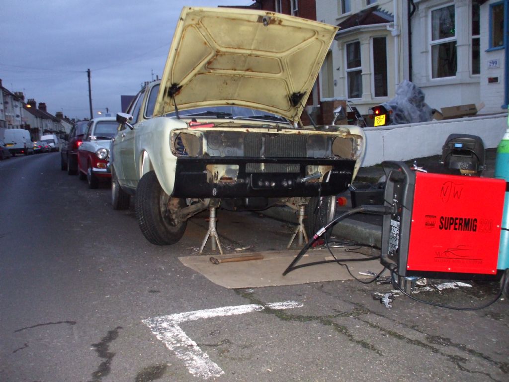

                    Here's a typical job for me, in the same spot I've been doing them for over 30 years:

                        Tolerant neighbours there Nick.
