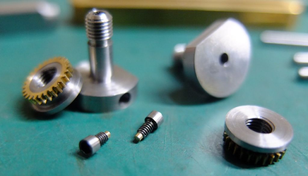

      I picked up a few of these tiny M&W micrometer heads some years back and I've used them for a few projects.
      Here are the component parts.
      The locking nut knurls are scrap gears. The runner locking screws are M1.6 Allen screws with the head diameter reduced. I drilled them out with a 1mm bit for a couple of mil then loctited brass rod into it and filed flat to length. This prevents any damage to the runners when locking in place.

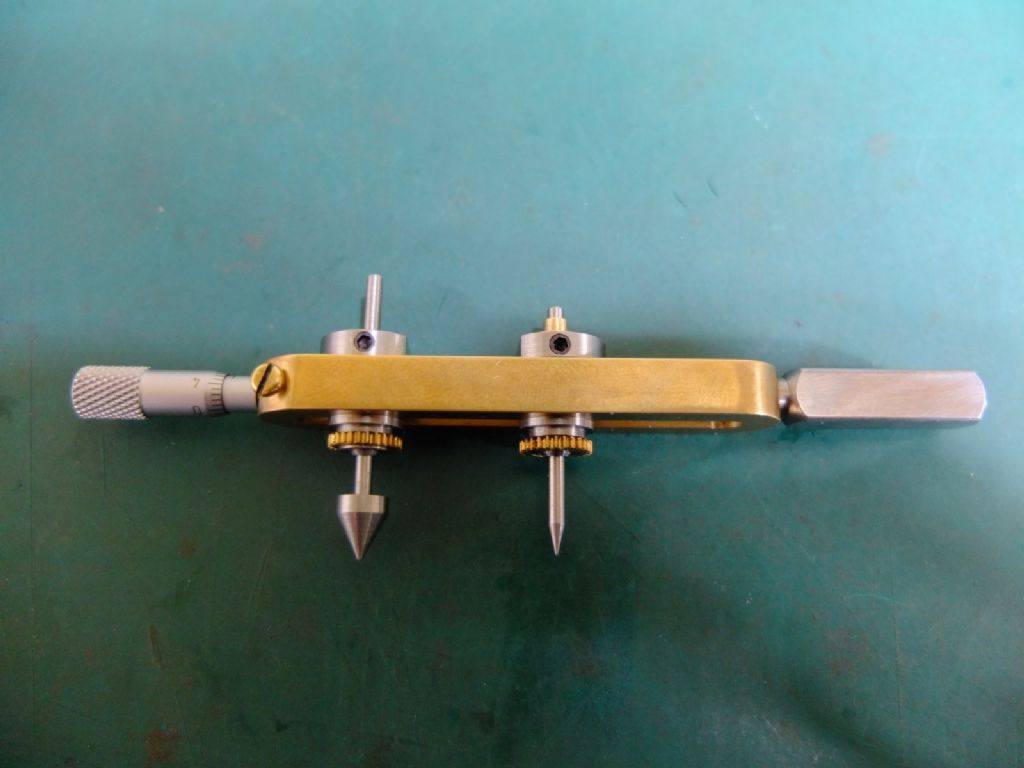

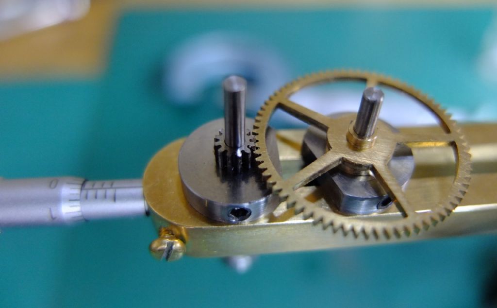

      And here's the tool in action.

          What a super idea makes you wonder how it had been missed for so long, well done.

              Great idea, shows that there's a use just waiting to be found for all the random items that we collect over the years.
              Great design, and looks to be superb workmanship.
