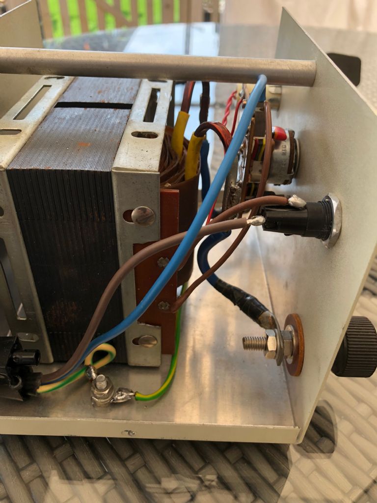

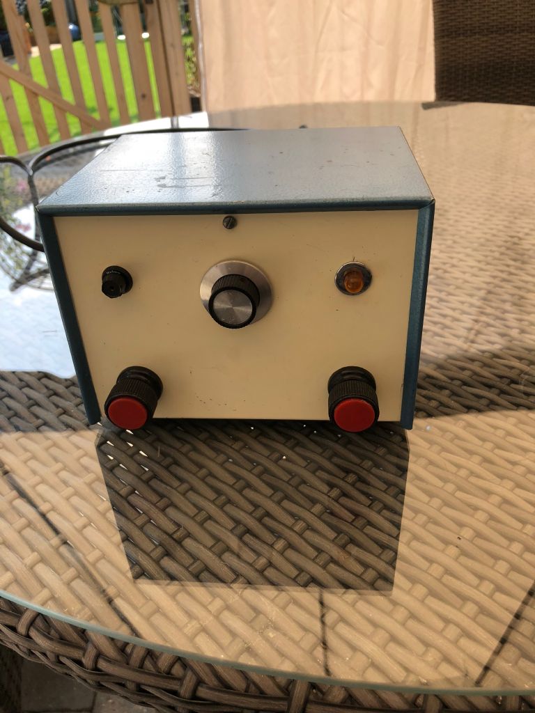

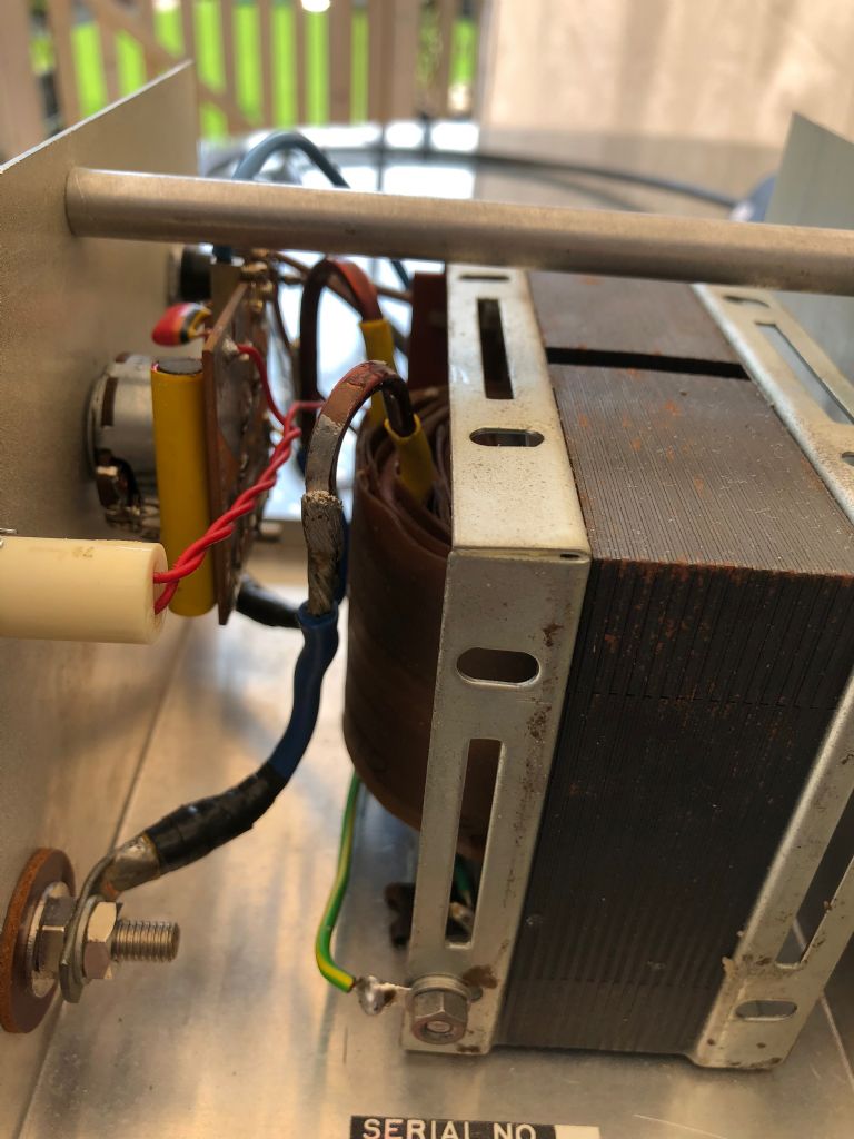

      img_0369.jpgimg_0371.jpgimg_0370.jpgHello All,
      I picked up this unit at a boot sale this morning, was going to use the case to house the electronics and motor for power feed on my milling machine.
      But looking inside I think it might be useable as a spot welder for lithium battery connections, or for resistance soldering.
      The AC output voltage can be varied from 1V to 6V.

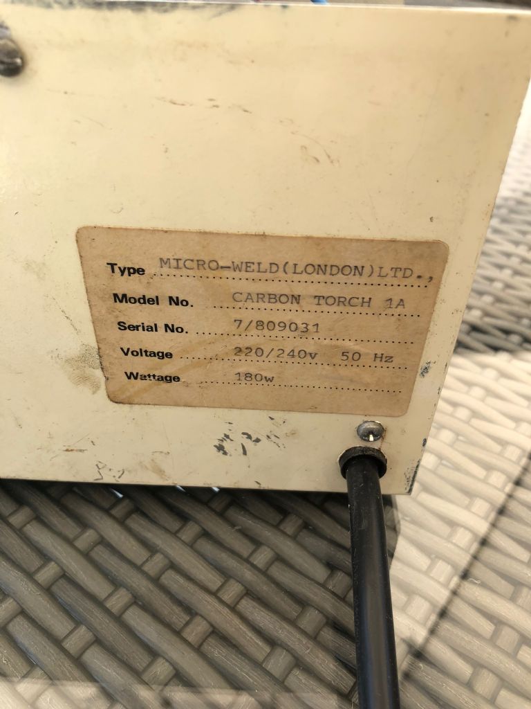

      Would like to know what the originalimg_0374.jpg torch/hand piece used with it would consist of.
      Can't find any info on it having searched the web.

          Looks like a very small contact brazing kit. The "Torch" would hold a stick of carbon with a pencil point – probably 1/4" diameter and protruding from the torch by about 1". The steel to be brazed would be earthed and the carbon rod touched onto the steel component (probably no more than 1/32" thick. Special bronze filler rod would be added to the 'weld puddle' , melt and form a brazed joint. At 1 amp, it may only be enough to solder and not even braze. These are the twin carbon torches, but its not man enough for them:-

            I would think that 1A is the model number rather than output current.
            It looks like it could output 80+ amps

              Been a couple of threads recently about Resistance Soldering Units and how hard it is to find a suitable transformer. You've got one! It might even be usable as an RSU without modification; is there anyway of controlling it with a foot-switch?
              It might be worth a few bob, the units are very handy for soldering delicate plates – don't destroy it for the box.

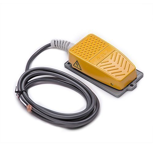

                      As long as you get a suitable foot-switch there's no problem controlling one of these from the mains side. The unit is only 180W (less than 1A) which is low-end.
                      For use in a workshop one of these would do, other brands available:
