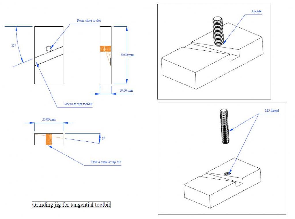

                                        I have delayed making the grinding jig for Mike Cox’s toolholder because my freehand efforts have been pretty successful. I am now ready to do the job properly but having reread the article, I cannot find any reference to the angle of the channel in the grinding jig. From the photos it looks as if it is about 60 degrees. If that is the case, then it occurs to me that there are three ways that the toolbit could be held in the jig. ie one side of toolbit against the left side of the channel, one side of the toolbit against the right side of the channel or the 90 degree angle of the toolbit centred over the centre of the channel. If the angle of the channel is 90 degrees then of course there is only one option.
                                        I wonder whether Mike or someone more in tune than I am can assist with this. I hope the verbage above is reasonably clear. I did draw a diagram but I can’t seem to attach it.

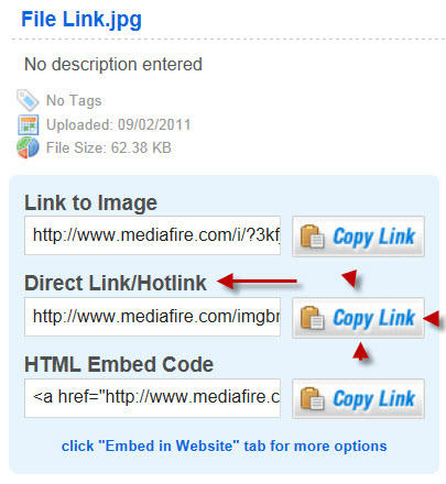

                                          There is another way to attach a photo, use a free file sharing site. I use a site called Mediafire. Once you have posted a file there, copy the link URL by pressing the copy button in Mediafire and then move to the MEW “Post a reply” window and click the image icon at the top (second from the right, like 2 blue hills with a sun above); a window will pop up asking for the URL…You already have it on the clipboard so just right click paste it in and close the window. Done…It will appear in a few seconds.
                                          There are many other free sites. I chose this one because at the time it looked OK, that was about 6 months ago…I still use it. It is also handy for making large files that you cannot email available to friends. Just upload and send them the link to download it. Files are not made public. The only access is via the link, you control who you give it to. (You can also share entire folders of files, great for family photos)
                                          The make their money from the advertising on the pages. Annoying but they have to eat. There is a paid account as well then there is no advertising and you get an even bigger file quota….
                                          There are a lot of sites offering similar services, have a look around the web.
                                          Cheers
                                          See screenshot below use the “direct link” selection.
                                          For those wondering how I grabbed the screenshot and put the red arrows on it? I used “Snagit”…easy to find on Google. I cannot recommend Snagit too highly. It has made copying , snipping and marking up a pleasure instead of a chore.
                                          All you do is press The print screen button on your keyboard, drag a box arount the part you want and click, it will pop up in a window yo can edit with arrows etc, or comments then press save and it is ready as a JPG file. or press copy and you can paste it directly in an email.

                                            #74345
                                            Gary Wooding
                                              @garywooding25363
                                              Is this what you wanted?
                                              #74347
                                              michael howarth 1
                                                @michaelhowarth1
                                                Gary, thanks….it certainly looks like another way of doing the same job, but the jig that Mike Cox describes looks more like the one on the left, in the photo posted by Chris Stephens on 22nd August.
                                                Edited By mick H on 02/09/2011 10:03:27

                                                  Cox’s jig is set at 30 /60 degrees and the tool bit that is to be sharpened is placed with the long corner downwards. The jig is used with the trough pointing downwards at the wheel so that the tool bit is trailing, short corner to long corner. If you get worried that your fingernails are getting close to the wheel, some find a simple screwed down tool bit clamp useful.
                                                  For general purpose use the V jig is superior to the jig in the previous post, which will work best with the the Oz style tool, as it is intended more for cutting in one direction only. As I have said before the striations favour one edge only , but the V one favours both cutting edges, so will also cut equally well on the back cut and when facing.

                                                    Posted by Gary Wooding on 02/09/2011 09:33:22:
                                                    Gary
                                                    Thanks for this. I can now make it and get my tool steel correctly ground
                                                    #74366
                                                    Gary Wooding
                                                      @garywooding25363
                                                      Posted by chris stephens on 02/09/2011 12:16:07:
                                                      With the V-jig the striations are the same for both cutting edges, but, since neither are perpendicular to a cutting edge, both are less than ideal.
                                                      Well, that’s how it seems to me.
                                                      I don’t have an axe to grind about this; I simply worked the angles out for the Oz style jig, which seemed to be rather easier to make than the V one. It certainly seems to work OK.
