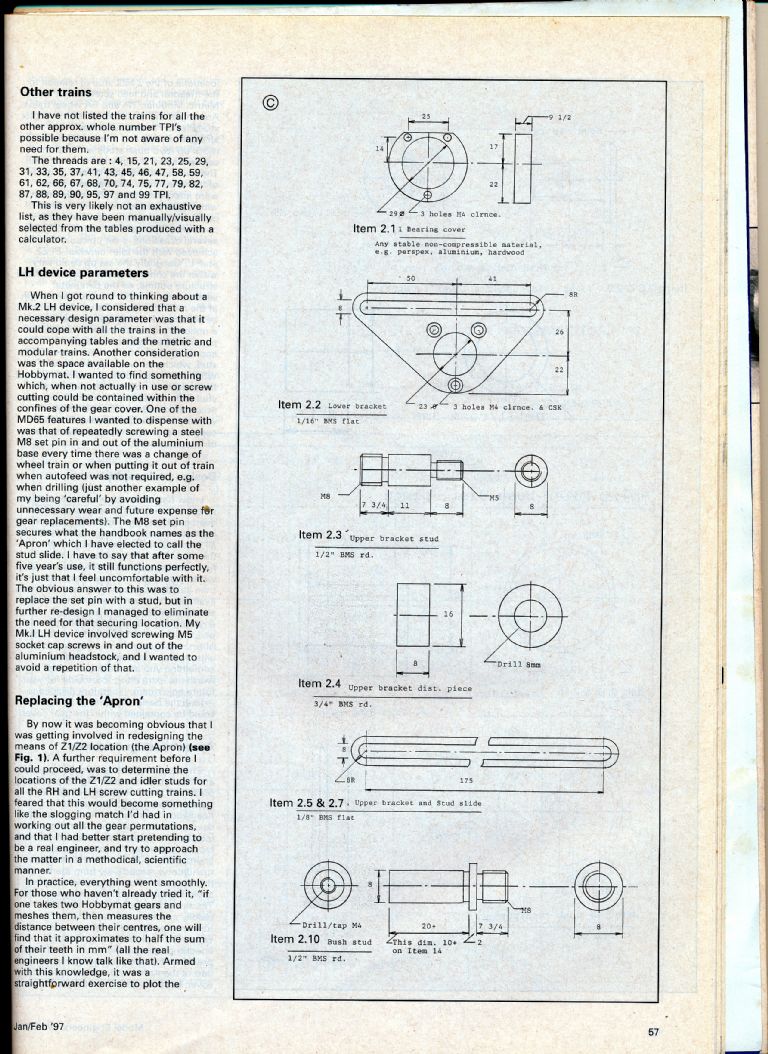

        I came to make this yesterday and discovered that I couldn´t read the dimensions. Some are illegible. I thought I could work them out from mating parts, but they were unfortunately illegible, too.
        Does anyone have a copy from which they could give me some dimensions please ? I´m particularly interested in the slot dimensions and positions.

          Is this what you want?

            Hi Pete, I have it in front of me, what do you need to know ?
              Item 2.2 22 to centre of hole, 26 to centre of slot – total 48. slot 8. 50 to left 41 to right of centre of large hole.    Noel
              Yes ! Thank you very much indeed. I can read this perfectly.
                Edited By noel shelley on 06/03/2021 12:30:46
                Thank you very much. Just what I needed. I was guessing some of them, as they weren´t sharp enough to read on mine.
