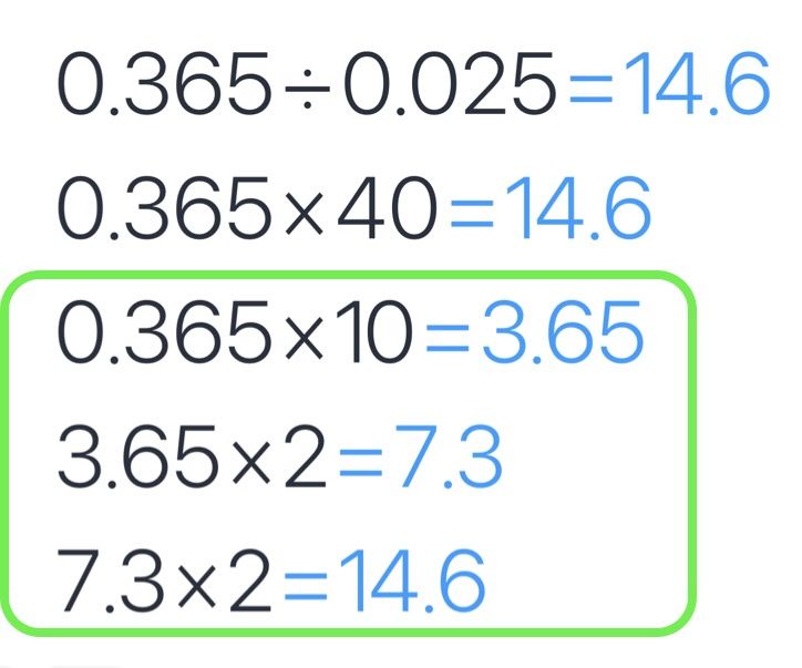

                                Just multiply the 0.73 by 20 (there's no need to halve the 0.73)
                                0.73 x 20 = 14.6
                                If you are doing the x20 in your head then split it into two parts.
                                (A) shift the decimal point to multiply by ten.   (B) double the answer.
                                In your example this would be   0.73 becomes 7.3  (that's the x10 bit)  and double that is 14.6
                                Just to show it works, there's no need to do the next bit.
                                14.6 increments at 0.025 each = 14.6 x 0.025 = 0.365 which is the depth of cut you are looking for to take 0.73 off the diameter.

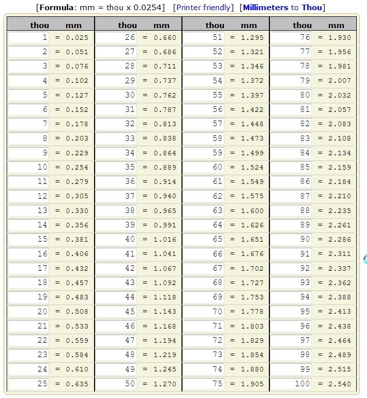

                                        Hi Athur, as mentioned previously
                                        Best option is to fit a DRO and you can read in either imperial or metric. (And remove the problem of calculating for back lash).
                                        A cheaper option is to fit a digital caliper or dial indicator. Lots of examples on Youtube of how to do it.
                                        A high tech, hands free option is to get one of those new  electronic deviices that does everything by voice command and say "Hey Google, what is 0.37mm in inches"
                                        A simple option (if you don't want to use a calculator) is to print a table of converted measurements from inches to mm and keep next to the machine. (like that shown below) Lots more on the internet.
                                        **LINK**
                                        Your example of a conversion for 0.73mm (0.737mm = 29 thou)
                                        Paul
                                        Edited By Paul Lousick on 06/01/2021 04:29:51

                                          #517790
                                            Posted by not done it yet on 06/01/2021 07:03:32:
                                            how do you know quickly how many 0.025's there are in it.
                                            Divide the number by 0.025.
                                            Or, for much simpler mental arithmetic …
                                            [ which was, I think, the essence of the opening question ]
                                            Multiply the number by 40
                                            For example:
                                            … As previously suggested by Steve.
