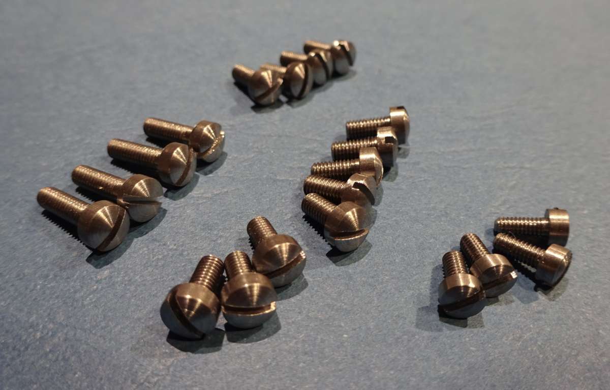

                Which is why I am making almost all the nuts, bolts and studs for my engines:
                2024_03040001
                The most common sizes are 1/4″ BSF and 2BA. The 1/4″ BSF nuts are mostly 1/4″ high. There are a few places where that doesn’t look right, or the standard nuts will not fit. There are also a number of home made M6 fittings for space saving, or to fit with externally supplied parts. In the internals, where they won’t be seen, there are a number of commercial M6 SHCS fittings. There are also some small home made metric screws, down to M2. The few small BA screws (down to 12BA) are mostly commercial. Not worth setting up the repetition lathe for very small quantities.
                My engines are a real mix of threads, as well as the above there are some UNF threads and a lot of the boiler fittings are 3/8″ BSP and 32/40tpi ME threads. No hang ups about metric or imperial, I just use what is appropriate or convenient.

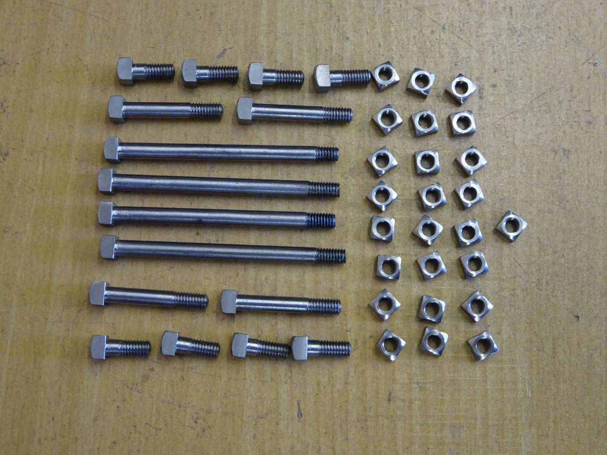

                              I think I would rather get hex head screws/bolts made or make my own. Looking at my usual electrical wholesaler their M3.5 x 25 screws are 17p each add similar for a model nut so lets say 30p each. A hex bolt would be about 20p based on cost of M3 and M4.
                              Add to the fact most switch plate screws are plated you would not be able to silver solder on a nut without problems and the faff of cleaning them up.
                              I expect you can get cheaper m3.5 screws but just like cheap studding the quality of the thread can be suspect.
                              Personally I’m not so bothered about bolts/screws as they make up less than 5% of fixings on a typical model that I make. Of those few bolts the ones mostly used on steam subjects are “fitted” bolts in things like eccentric straps so would not want to use fully threaded shanks anyway. Olber Model IC engines may want Fillister head screws and some of the open crank engines square head so I’d not have much call for using electrical screws.

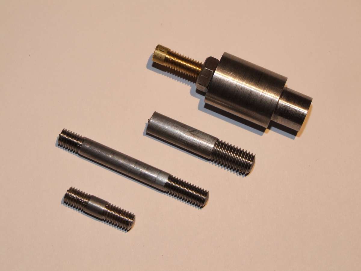

                                    [admission] making proper studs, incorporating an unthreaded section, would remain a challenge.
                                    Not sure why; studs are fairly simple, albeit it needing two operations. First operation is to round the end of rod, thread the top of the stud and part off. Then the embryo stud is screwed into a threaded holder with adjustable back stop and the bottom of the stud is threaded, leaving a plain portion:

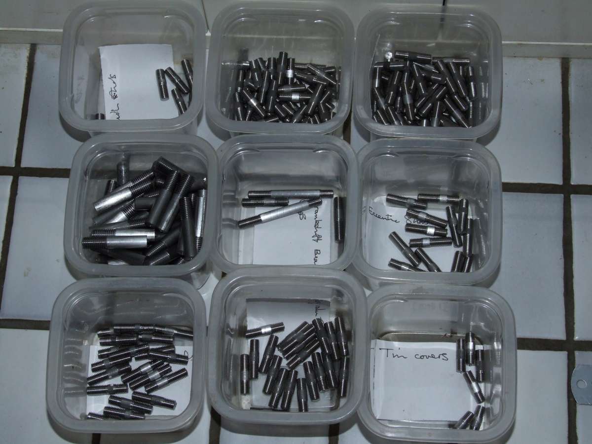

                                    2015_03250011
                                    I am making all the studs for my engines, mostly 5/16″ and 1/4″ BSF, M6 and 2BA:
                                    2015_03250004
                                    The large studs with a plain end are for holding the cylinder down to the boiler. Until the cylinder is fully machined I don’t know exactly how long the plain section needs to be.

                                      All I meant was that my proposed “make-from” source of M3.5 would not provide a particularly simple way of making the studs.
                                      #726505
                                      Nigel Graham 2
                                        @nigelgraham2
                                        Andrew –
                                        That is exactly what I had described – and it’s an old technique!
                                        Duncan –
                                        No, don’t lock the stop-screw, but use one long enough to fit with its own lock-nut. Its should be left free because the action of cutting the second thread, especially with a die, will tighten the stud against the stop-screw, so you need be able to release that if necessary.
                                        I am otherwise assuming removing the finished stud from the holder by the two-nuts method.
                                        It also allows some length adjustment if necessary, including using the same holder for two or three different lengths.
                                        #726536
                                        Anonymous
                                          On Nigel Graham 2 Said:
                                          …should be left free because the action of cutting the second thread, especially with a die, will tighten the stud against the stop-screw, so you need be able to release that if necessary.
                                          I just used a Mole wrench; a close look at the second end threads in the first picture above show some minor marks. But it doesn’t matter a jot as the thread will never be seen once the studs are loctited in place, and the method is fast. My threads were cut with a Coventry diehead. I don’t know if that causes more, or less, tightening than a circular die.
                                          Andrew
                                          #726634
                                          Nigel Graham 2
                                            @nigelgraham2
                                            It may be fast but I’d rather not risk scarring the surface or worse the thread, even if it is hidden.
                                            I do have a Coventry die-head which I have yet to use, and I am not sure if my collection of dies is actually for the head’s size anyway, but any sort of die will impart considerable torque to the stud. It does depend considerably on the material toughness, diameter and thread dimensions of course, but the tool will still try to push the stud round hard against the back-stop.
                                            #726700
                                            Anonymous
                                              Having had a quick look at some of my spare studs any thread damage caused by the Mole wrench is not immediately obvious. Clearly the diehead does tighten the stud against the brass backstop, but it doesn’t take much to release it. I’m lazy and when making dozens of studs I’m not going to mess around using the double nut method. Grin smiley
                                              Andrew
                                              #726732
                                              Nigel Graham 2
                                                @nigelgraham2
                                                I take your point about convenience and speed! Anyway you can always protect the surface with some shim material, e.g. cut from an aluminium drink or fish tin.
