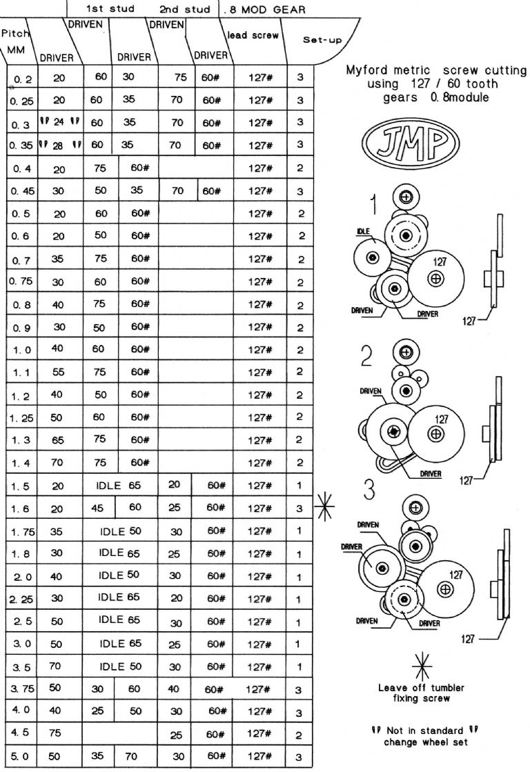

                              The problem when using a 127 gear on a Myford 7 changewheel machine
                              is simply the size of the gear if you have it as 20 DP,the lead screw centre
                              distance to tumbler stud = 3.785" and is equal to the size od a 149
                              tooth gear .As a pair of gears in line maximum that can be fitted in is a
                              20 tooth and 127 tooth .
                              As Michael G pointed out ,One great proponent of the 127 tooth gear was
                              Martin Cleeve … but he, very wisely, used a reduced pitch on his ML7.
                              I have gone down this same route using a 0.8 module 127 and 60 tooth
                              gear with the exceptions of 2 pitches the rest can be done using only
                              the remaining standard changwheel set supplied with the machine
                              using the standard banjo and being able to shut the cover.
                              Here is the screw cutting chart a horizontal version is in the album
                              "gears" as this is easier to print out in nearly A4.

                                                #569760
                                                John P
                                                  @johnp77052
                                                  Posted by Pete Rimmer 02/11/2021 16:36:19
                                                  My lathe uses 16DP gears except for the metric set which utilises 127 tooth.
                                                  They are 32DP. I expect that a Myford 7 would get away with 40DP conversion
                                                  gears but 32DP would do just as well being ever so slightly finer than 0.8MOD.
                                                  The gear chart for the 127/60 gears i find much
                                                  easier to use that the pair of 21 tooth gears that
                                                  i have had for as long as i have had the Myford.
                                                  Since the 60 and 127 gears are always in the same
                                                  places setting up only requires changing perhaps
                                                  one or two gears,for instance to change from
                                                  .075 to 1.00 and1.25 mm pitch only requires
                                                  a change on the tumbler from 30 to 40 and 50 tooth
                                                  and reposition the banjo,i only use a few pitches
                                                  anyway mostly 20 tpi 1 mm and .75 mm and since
                                                  the half nuts have to remain closed for metric cutting
                                                  i use a mandrel handle so it is useful to be able to
                                                  keep the gear change door closed.
                                                  I nearly made a 20 dp 127 gear but realised quite
                                                  early on that fitting and using it may turn out to be
                                                  a real problem ,i doubt if you would be able to do the
                                                  full range of metric pitches using one , if you know different
                                                  i am sure you will let me know.
                                                  Anyway the chart is there for you to use if you wish, it
                                                  would only suit .8 mod or 32 dp .All of the pitches
                                                  have been set up on my machine so they will fit in
                                                  some are a tight squeeze even with .8 mod gears.

                                                      The chart replicates all of the metric pitches in the Myford
                                                      handbook and a few extra , the Myford chart only goes to 3.5 mm.
                                                      I suppose if i had missed any of these out someone else
                                                      would have pointed out that the chart would have been incomplete.
                                                      The 3.75 came out as i had transposed some gears when setting
                                                      up ,as it came up as exactly 3.75 i just left it in the chart.
