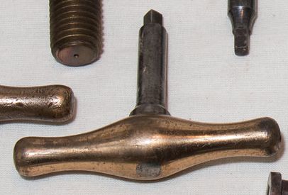

      I have been admiring this chuck key and as I need a couple thought it would make a nice project sometime. Thinking about joining the steel stem to the brass handle I had thought of turning and reaming tapers but seeing the small end at the top of the handle I think from my limited knowledge this would not be particularly efficient at griping, the taper being too steep.
      Bearing in mind its a key so needs to be secure how do you suggest they might have fixed it originally?
      Chris.

          Is it pinned through from the side?

            Thanks Martin, I meant to add that was my thought first but I see no evidence of a pin…

              Total guess, but knurled and driven on?

                Hmm well that might work ok but for something of obvious quality I would expect something more certain to secure.
                Similarly I suppose the end of the shaft could be peined into a countersink and then finished off flush, but again I thin there must be a better engineers solution?

                  The part of of the shaft inside the handle may be square, splined or similar (or even threaded) with small round post at the end that was peened over.
                  An X-ray would reveal a lot, how friendly is your dentist?

                    Tapered, square-section shaft and hole, round shaft end peened over, to hold it in?

                      Whats wrong with using soft solder? I would do a taper fit, tin the steel and wipe with wire wool and sweat the two pieces together.

                        At least one well-known brand of padlock uses a brass pin through the brass body to secure the assembly of its 'innards'. The brass pin is driven in and then filed and linished flush on both flanks of the body. If this is done properly, 'you can't see the join'! (I and my fellow pupils actually had to assemble such a padlock as part of a 'Locksmithing Acquaint Course' several years ago. )
                        You could use the same technique but polish the handle rather than settling for a linished finish.
                        Of course, the shaft of the key would need to be a good fit in the handle and the pin should be the same grade of brass as the handle so that their colours match.

                          The brass crosspin sounds good, but you could also draw the shaft into the handle with a cheesehead screw in a close fitting shallow counterbore and linish down the head flush when tight.
                          Shaft to be keyed, squared, tapered or loctited to taste as well if desired.

                            What's wrong with threading it and using Loctite?

                                    I had in my mind dismissed a brass cross pin as not strong enough but as several of you seem to think that would be ok I think that would be my preferred method. Of course a steel cross pin could look nice too, matching the top of the shaft, but clearly that's not how this particular example was made.
                                    Should the cross pin also be tapered, I don't suppose you can buy imperial brass taper pins..or can you?

                                      We used to make carriage door handles at work by casting the brass around a steel spindle with suitable chunks chewed out of it to provide a positive drive and location. The pattern was "handle plus spindle"; the pattern was removed and a steel spindle carefully positioned and aligned in the mould. Very simple bearings on most older carriage door locks; just a 3/4"BSW thread to provide axial and radial bearing surfaces.

                                          Thanks Nigel B, casting the brass onto the shaft seems like that could well have been the way this key was made, I like it, but won't try that at home!
