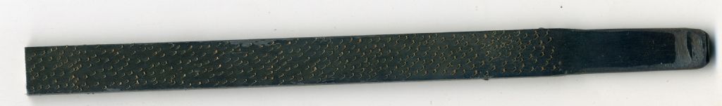

                                                  mark smith 20
                                                    @marksmith20
                                                    If you think some of those files are expensive , try Liogier hand cut rasps which i have a couple .(around 60-150 euros each).
                                                    I have a couple of Auriou as well which also werent cheap, the course teeth ones are good on aluminium). I found them fantastic to use on wood which is what i use them for but the expense led me to make my own small ones ,hand cut with a punch from gauge plate.
                                                    I also have several of the vallorbe /grobet in very fine teeth size for use on sterling silver . Also very good but small teeth gum up extremely quickly on soft metals.
                                                    Corradi(italian machine made files and rasps), is another brand that seem to get good reviews from people i know.
                                                    One of my attempts at rasps:
