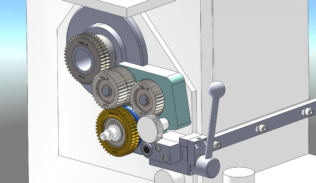

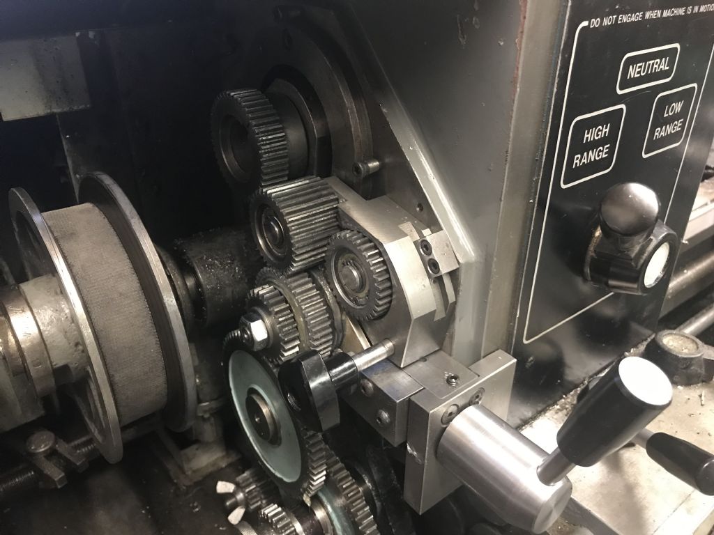

      Finally, after years of drooling over "Sir" Meek's (and others) dog-clutch threading conversions, I have designed one for my Denford 280 lathe.
      I've only spent a couple of weeks to get to this stage, so there are still going to be a couple of bugs to iron out, but overall I'm happy. Happy enough to have ordered the materials, in fact, plus a missing 20DP involute gear cutter that I needed, used off flea-bay.
      The gearing and clutch bits that you see are reasonably well sorted, and I'm OK with the design. The actuation system that is moved by the saddle still needs the detail finalising. And I need one more check to make sure that the gear rotations are in the right direction to match the actuator lever !!!!
      So, wish me luck ….. if anyone is interested, I will post a few notes on my progress as I start to machine. I promise not to post the rude words when I find the errors smiley
      Cheers – Will

            Thanks for the reply Gray – and appreciate the offer of advice.
            So here we go smiley …… On the adjustable bar that the saddle hits to flip the clutch from engaged to neutral, I'm thinking around 10mm movement of the bar would feel about right. So 10mm either side of the neutral position.
            The clutch "dogs" have 1mm per side clearance before engagement, so 2mm in total.
            Obviously since the threading will hopefully be happening a LOT faster than previously, there is a chance of overrun if there is not enough clearance and the saddle goes too fast, but perhaps at practical speeds the leadscrew stops almost instantly, in which case I need not worry.
            Do these numbers sound about right to you ??

            #475362
            Graham Meek
              @grahammeek88282
              Hi Will,
              The travel to trip the clutch at the carriage, on the Myford, and the Hardinge I worked for some time was about 15 to 16 mm, from memory. The travel at the S7 and ML7 clutch units is 2.5 mm, the clearances need be no more than 0.25 mm. The Operating lever stops moving as soon as the Dogs disengage, and the ball bearing detent wants to be close to the neutral position, so that the Operating lever will snap into neutral.
              Once set the carriage will repeatedly stop in exactly the same position and start in the same position. The only time these settings alter is when you set at a lower speed and then for some reason increase the spindle speed. As you rightly assume it is to do with Moments of Inertia, but once the settings have been reset at the higher speed the carriage will carry on as before.

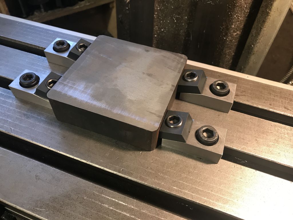

                  Have not got very far as I type this – I got distracted and made 4 low profile clamps over the weekend to hold the lump of cast iron block for the main body, on the mill. And then work got in the way sad
                  I wanted to face both sides of the block as a first operation, which I could have done easily on the lathe. Instead, I finally decided to make some low profile clamps, which I had wanted to make for ages.
                  They follow the principle of some (expensive) proprietry ones I have seen, and they work amazingly well – I was quite surprised actually, not too hard to make and the cam screws worked first time. The Jaws are hardened and tempered tool steel; grooved on one side to bite into rough work, and smooth on the other.
                  Couple more photos in my album – if anyone would like me to add the rough 2D drawings, just ask.

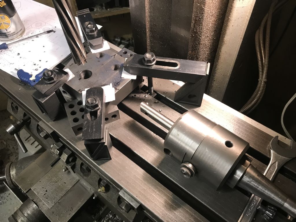

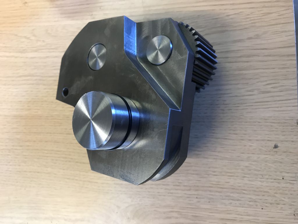

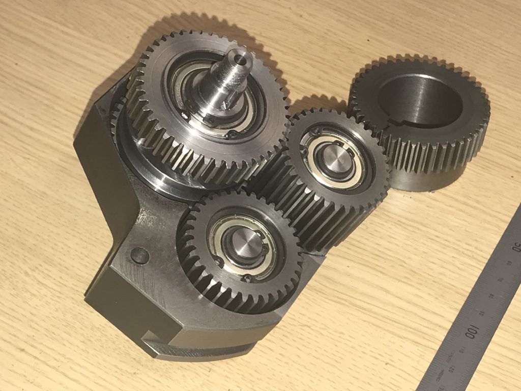

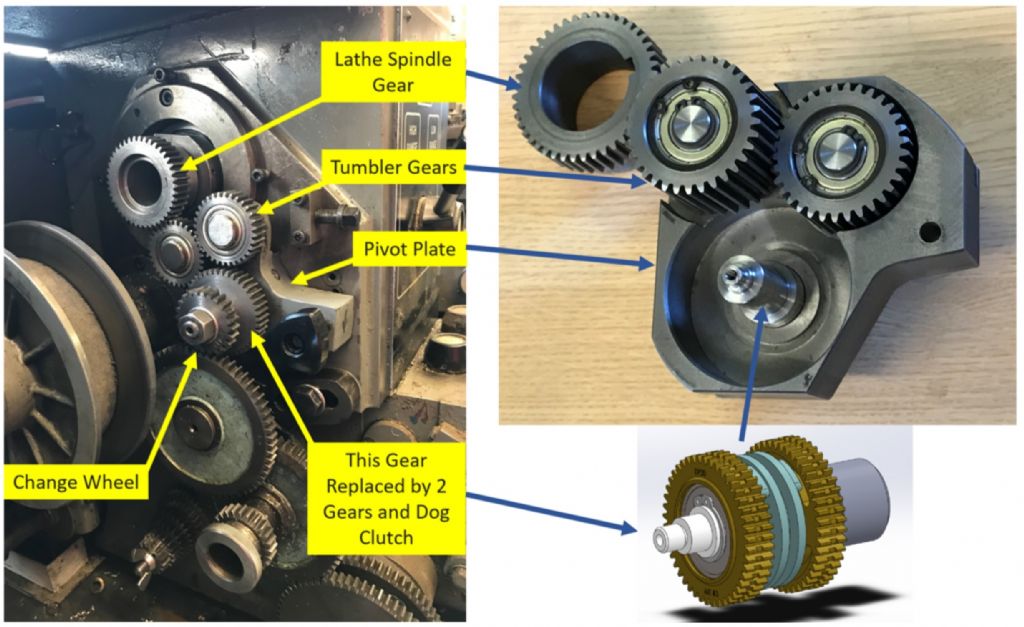

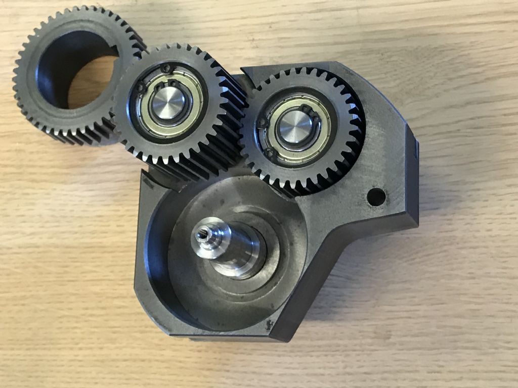

                    I’ve managed to get some evenings in the workshop last couple of weeks, even though the temperature has been a bit on the warm side recently, so I thought an update was in order.
                    img_2169.jpgSo, I’ve machined the pivot plate that holds all the gears together and replaces the original. This was done by boring then reaming the 3 holes for the gear shafts in one setting using the DRO on the mill, These need to be spot on. I then machined the rest of it, which is not critical, on several set-ups on the rotary table.
                    I’ve also managed to machine 3 of the 5 gears, along with a few stub shafts. So good progress.
                    The Pivot Plate and the gears shown are cast iron, which made a mess of the machines but is easy to machine, but the dog clutch gears will be steel.

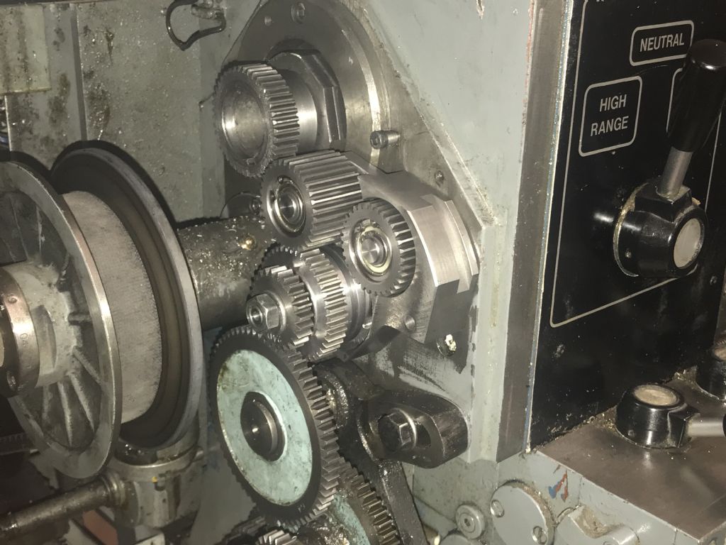

                    The picture below shows the original gears, and how they will be replaced with the new one.
                    I will probably get a start on the clutch parts this weekend, so a bit more gear cutting and rotary table work ….. but now off to fire up the bbq smiley

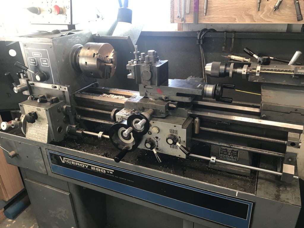

                        The clutch and clutch gears have been completed along with the associated rotating sleeve components. So the gear assembly is all but finished for this stage – still a couple of holes to machine in situ once I know the position of other parts, and a locking pin to make.
                        As shown below, I've temporarily tried it in position on the lathe with a change wheel fitted. It fits a treat and the gears all turn as hoped. Result !!!. The gear on the main spindle is still the original one, but because it's a tight fit on the shaft, I will not remove it again until I'm ready to make the change.
                        Next challenge is to make the clutch actuator arm and the mechanism that moves it.
                        Cheers Will

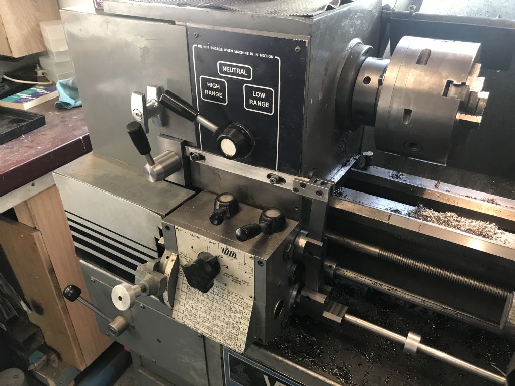

                          Hi All – It's been a couple of months, so I thought I'd update progress …..
                          Well, I'm happy with it so far. All the gear and clutch stuff is working well in manual mode, and I've given it some welly without anything dropping off or seizing. Noise is OK, not silent, but no noisier than it was before I attacked it, and it can be disengaged when not needed. The only thing I need to re-do is to swap the detent spring for the lever position – it needs to be stronger to give a more positive location.
                          I still need to make the auto-release mechanism that connects the clutch mechanism with the saddle position, but the lever arm that it will attach to is in place (under the cover, so not visible).
                          I have cut the aperture in the gear door, but it needs tidying up. Also the door lock position needs to be moved up, which will need some welding and painting to do it justice. When I'm ready.
                          Even in manual mode, screw cutting metric, which is 99% of the threading I do, has been transformed. No more stopping and reversing the motor between passes !!

                            Hi All
                            Final update ……
                            I retired at Christmas, so my job is now playing in the workshop !!
                            So I’ve blitzed the dog clutch that I started 19 months ago, and finally finished the complete system, with the saddle auto actuation being the last bit. But that’s it, done, and it works a treat !!
                            The lever system is a bit convoluted, but the saddle feed disengages the threading quite accurately, with a nice satisfying snapping action and a repeatability of few thou at low feed rate, which is great.
                            Screw threading at 500 rpm is less repeatable, but still reliably around 0.2mm, which is usable, but not sure I fully trust it yet at that speed.
                            Worked out a way that didn’t need any welding of the door, just an aperture cut out.
                            Only compromise is that the saddle has lost 50mm of travel at the Chuck end. I can’t say I ever remember needing to move the saddle that close to the headstock, but if required, I’d have to take off the lever. Not the end of the world.
