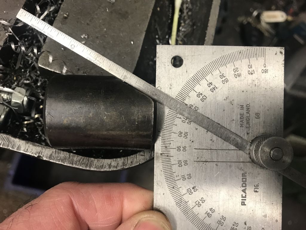

            Bob, I have measured my Meddings, it is 60 deg.

                I had done a drawing, in 'real time' full measurements and worked out an angle of 64 deg, but your actual piece from the m/c is better and makes it correct.

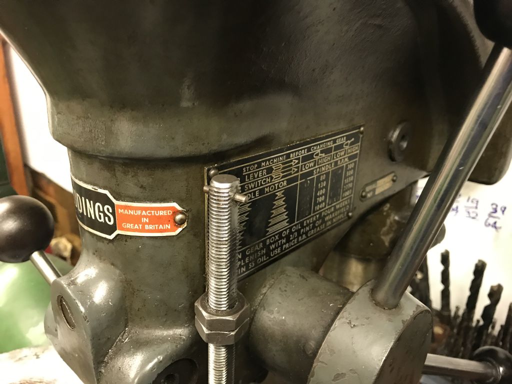

                Perhaps you could comment on the rod that pulls the two pieces together, which I understand is 3/8" BSF. thread.
                I looks to me that this size of rod will come very close to the pillar and I am looking to reduce it to 5/16 BSF (Found some in a drawer ! )

                      5/16 will work fine and allow a little room for a release spring.
                      From what i've seen normal British practice was to make the bolt pretty much as large as would fit in the space and not use a release spring. Common to need a quick donk to release. Especially if the last guy to lock it was channeling their inner gorilla!
                      The angle on the end determines the force distribution. Following Alains' photo steeper angles push more force outwards to the main casting and shallower ones put more force along the clamp thread. With steeper angles you really don't want to do things up any tighter than needed as the outward force rapidly becomes enough to jam everything up solid.
                      It is said that shallower angles aren't as effective.
                      But I've never seen any sensible engineering explanation.
                      I imagine its like everything else in engineering. So long as the basic concept is workable the effectiveness in practice is down to how well the details have been handled. Careful engineering oif a theoretically not so good concept beats slap dash implementation of a theoretically better way every time. Good enuf is good enuf.

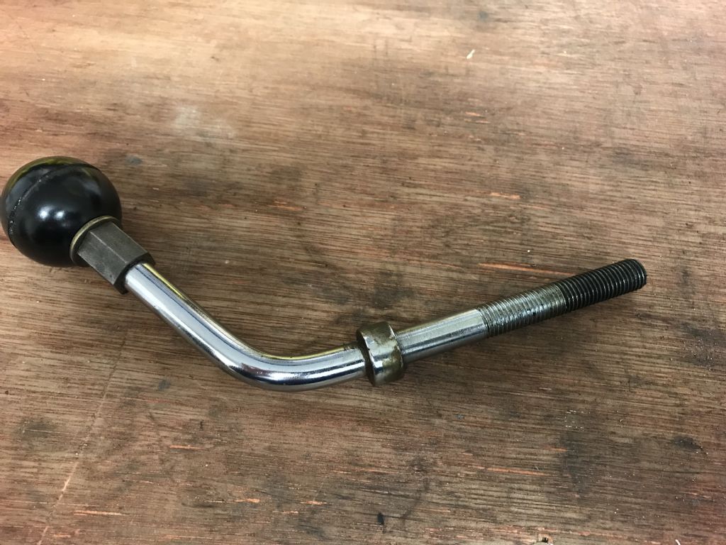

                          img_4634[1].jpgHello Bob I confirm that on my drill it is 3/8" BSF see pictures.
