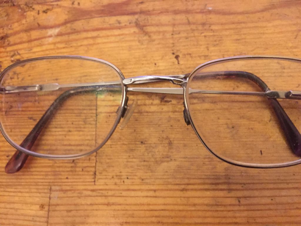

        For reasons too tedious to go into I am trying to keep a pair of wire-framed specs functional for another month or so by soft soldering the fragile join between the bridge and the lens frame. Initially I used standard 60/40, which didn't work well – about 4 days MTBF. Then I found a reel of lead-free (95.5 Sn, 4.0 Ag, 0.5 Cu) in my soldering drawer, tried with that, and it's held up a treat.

                            Thanks for replies.
                            On the specs front, I am quite pleased with my repair:
                            as was my optician. He hadn't noticed it when he measured the optical properties of the lenses – he obviously needs better glasses! I suppose I could put a bar across the top, aviator style – seems a bit 70's, but it perhaps the style will come back, as styles do. And I'll be a trend setter.
                            It turns out that frames of this type are silver soldered, so had I gone along that route for the repair the specs might have fallen apart completely. I wonder what Roy's frames were made from? Aluminium?

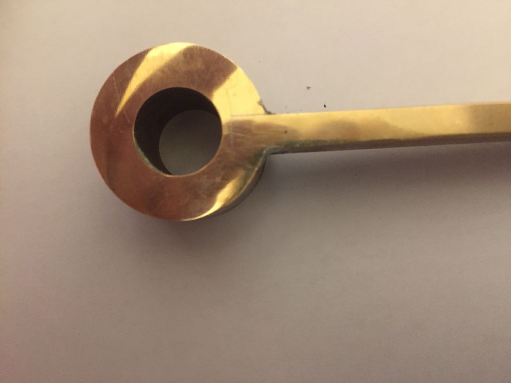

                            Returning to my main question, I made a test join using the Sn/Ag/Cu alloy:
                            You can see the solder line, which would probably be invisible with Ag/Cu, but it's livable with. That's a 3/16" (4.76mm) 'tenon' in a 5mm 'mortice'. So about 0.12mm gap. Maybe it should be tighter. Anyhow, after destructive testing I'm now sure the joins will hold up. I still don't know what the silver does though!
