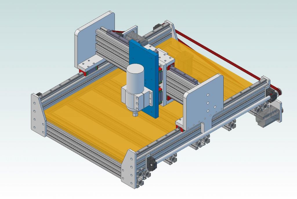

                  #493955
                  Journeyman
                    @journeyman
                    A useful source of info on the small gantry routers is MYCNCUK worth a look, you could be tempted to go for a home build such as this:-
                    All the aluminium extrusions and parts readily available and could be much more rigid (and flat) than the el-cheapo oriental ones. There are some designs on there for gantry machines that would probably be more robust than a Bridgeport!
