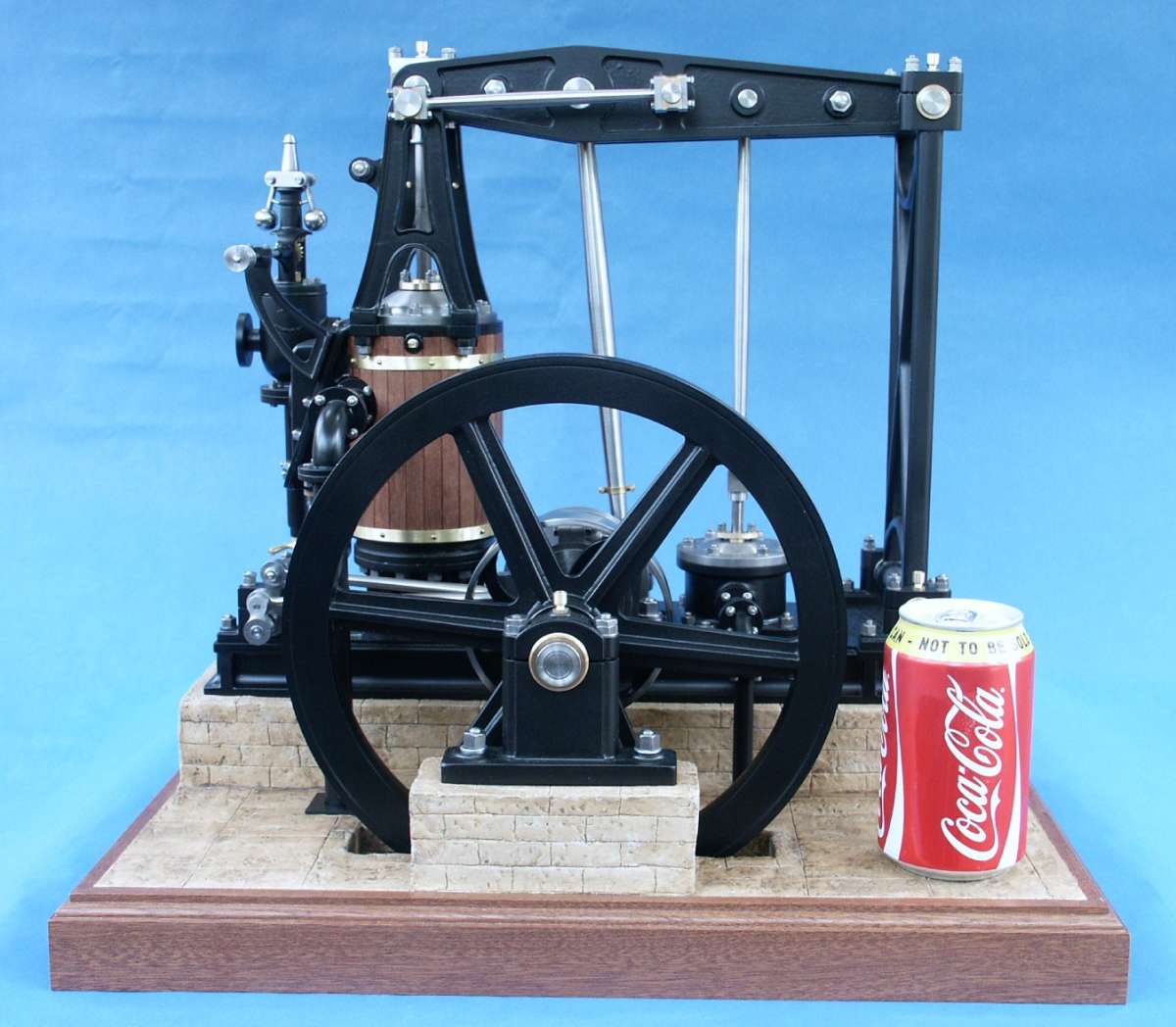

        I’ve seen the beam fabricated from flat aluminium plate and sheet and glued together with epoxy etc. It is awkward to mill from a solid piece of aluminium because the narrow sides of the beam are a large radius curve hard to replicate without CNC. Or you can compromise and make the beam straight sided between the central pivot boss and the end bosses. Any mill can then do it. Never looks right to me though without the classic rounded shape.
        #801780
          Yes the beam could certainly be fabricated. I’d probably go with a sandwich of three layers for the central “plate” which would make it easier to form the recessed teardrop shapes. Then a strip with a slot along its length can be bent to fit top and bottom. After that bore the ends and fit round bosses as well as the other bosses. I’d probably go with steel and solder it together
          Straight sides is acceptable if the original was hat shape such as sevearl engines made by Easton & Anderson
          E&A
          No castings used in this one of mine.

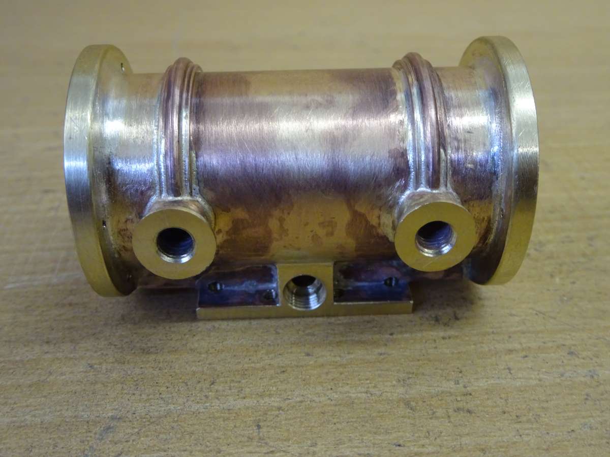

          Likewise the cylinder can be fabricated either by JB Weld holding cast iron together or silver soldered up from brass and bronze.
