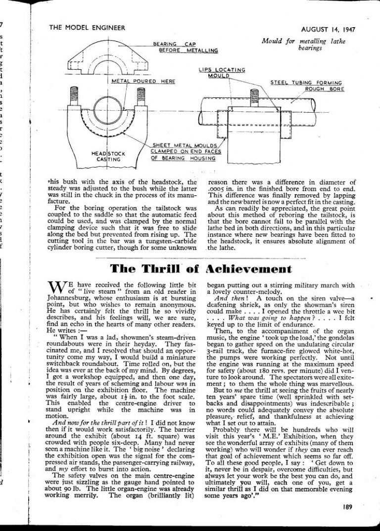

              White metal bearings?
              They can even be poured in situ, there was a ME article about it around the 1920s or 30s
              They used white metal bearings in locomotives btw, it's a proven system
              metalling
