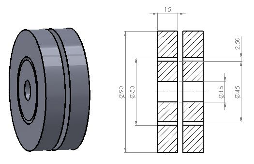

      I need 2 spacers, 9cm outside diam 1.5cm thick with a 5cm diam centre hole, and 2spacers 4.5cm od, 1.5cm thick with a 1.5cm centre hole. I have a piece of round steel bar 10cm od and 4.0cm thick. Can I use this one piece of steel to make all four spacers and if so,how ? or do I need to get some more steel. I have a 9" South Bend. Thankyou

          look up "trepanning".
          #197471
            Followed by "parting off"
            As that is likely to give more trouble than boring/trepanning out the hole at 100mm dia
            Edited By JasonB on 21/07/2015 13:00:41

              I would just make the smaller bore ones first parting the 2 off and then the larger ones finally parting each off. I don't think I would bother trepaning the 45mm out just turn the 100mm to the right size for a distance a bit over twice the spacer thickness plus twice the parting off tool thickness. After all it is a southbend, it wont take long to get down to 45mm dia from 100.
              Making and parting off the smaller ones first means that the depth of hole drilled and bored wont matter.

                Roger only has 4 cm (Length.) of the bar so he could only get two 1.5 cm slices from it.. I do not think it is possible to trepan through 1.5 cm to give a hole of 5 cm dia. and to leave the cut out 4.5 cm dia. Even without allowing any clearance the tool would only be 0.25mm thick.

                  0.25cm surely ie 2.5mm? Even so, barely enough.
                  You should just get some length of 2" round and be done for the smaller ones. There's 5mm length left for facing off and parting the bigger ones. 2 cm parting depth required, so as John says, don't mess about – go big or go home! Use coolant if you can.

                        Two things occur to me the thickness of the spacers will probably preclude getting enough safe grip to part off the second spacer. Mathematically you can get 2 out of his 40mm length, but in reality this is unlikely. So the answer to the original questions are…… NO, and you need a longer single length of steel, or 2 longer lengths of different diameter.
                        The second thing is I am stunned at the reluctance to simply suggest parting off the spacers after drilling or boring the centre hole. The wall thicknesses are not great. Hole saws?Trepanning? Utter nonsense. The overhang on the parting tool will only be 20mm and 15mm.

                                      It is possible to make the 4 spacers from a piece of steel only 40mm thick but would need a special tool to cut the 2.5mm groove. A hole saw as suggested, could be used (if you have one for this diameter) but would leave a rough surface which would have to be cleaned up.
                                      It would be much easier to buy some more steel. Possibly hollow bar for the large spacer. Or have it profile cut from plate and machine to finished size. Should not be too expensive and much easier to make the spacers.

                                            I think it could be done, first take the OD down to 90 mm, then split the bar in half, and face to 15 mm thick, then here's the tricky bit, trepane the centre out by going in half way then turning the disc around, then going in the other half. Sometimes I try these ideas out, sorry not with this one.

                                                You could part off in the middle and trepan from both sides or part of to 4.5cm diameter and then trepan in to part off large washer then finish off small washer. You could also turn round in chuck and hold on small diameter to make second large washer.
