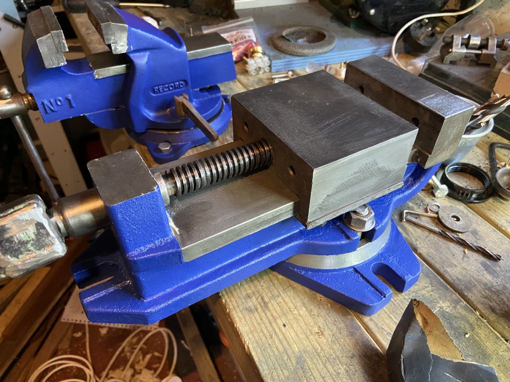

      I recently got myself a Dore Westbury mill, with no vise, so I got one from eBay, only to realise that it has no jaws. No problem, nice first project I reckon, so I am planning to get some mild steel bar and make some,
      but what size are vise jaws supposed to be, compared to the vise body? Looks like the space for the jaws is 4 1/4 “ x 1 3/8”. Does this mean I should be aiming for 4.5 inch by 1.5 inch? Would make sense but I’d be interested to hear the view of someone who knows.

          Sounds about right but really up to you. I always make vice jaws out of gauge plate, saves grinding them and usually about 3/8 inch thick.

            Hi Steve welcome to the forum. The sizes that you are suggesting seem to be about right, perhaps 3/8 thick, but personally I would use guage plate instead of mild steel as mild steel will easily be dented by swarf and when holding small pieces they may dent the softer steel. Also it comes ground flat which will help with holding jobs square and flat.

                    Hi Steve, it's unlikely you will get gauge plate cut exactly as you need it. As above gauge plate is ground on both sides plus tougher than mild steel, it's not difficult to machine if you know what you are doing.

                          I'd say mild-steel is suitable for a first attempt, in fact a decent beginner challenge. I fitted plain mild-steel jaws to my Record Vice №4 in preference to its hardened originals because they tended to mark the sort of work I do. I also made aluminium faces for more delicate work, but buying a pair of fibre jaws was a waste of money: not used them yet.
                          I consider my mild-steel jaws to be disposable, because they do slowly ding up as David George describes. How long it takes to knacker a set of jaws depends on the volume of work done and how brutal it is. If mild-steel isn't good enough, you could case-harden it, or switch to gauge plate, or one of the tough steels; beware – tough steels can be a pain to machine, which is why gauge plate exists. The other big advantage of gauge plate is it is ground flat and parallel, important on a machine vice. Bright Mild Steel isn't so accurate, but my experience of of bits cut from the same rolling has been good enough for most purposes.
                          As to the sizes, jaws are usually slightly wider than the vice and deep enough to close without putting the screw to end-of-travel. What you suggest sounds right. One trick is to knock up some jaws in wood or cardboard and test them for fit, opening and closure before spending time and money on a potential misfit in steel. Once confident the template is the right size, then make the real one.
                          Provided they are parallel there's a fair amount of latitude in jaw making so don't worry too much. Might even be an advantage make your own – fit taller jaws or cut Vs in them to holding round stock.
                          I take it the vice was second-hand? If so don't be afraid to scrap it if it's poor condition: missing jaws may be the tip of an iceberg because vices are often badly abused. Get rid if it doesn't grip properly: jaws lifting badly or not parallel; twisted frame; rocking; worn screw / nut, or other obvious defects. Perfection isn't essential – quite often lifting can be fixed by tapping the work down with a mallet – but a machine vice that allows work to move or won't grip straight is a pain in the proverbial.

                              Well, I’ve ordered some gauge plate, turned out 3/8 wasn’t enough so I’ve gone for 5/8. It cost more than the vise! More fool me. Never mind, it the journey, not the destination. I should have enough left over to make a vise stop and more bits to boot.
                              Vise seems parallel, I’ve checked with some gauge blocks. I stripped it down completely, refurbed and repainted it, Seems very solid.
                              in the past I’ve had great success buying vintage woodworking tools and refurbishing them, I’m beginning to think machine tools might be more tricky!Milling vise

                                    So my gauge plate should be arriving today, Would someone be kind enough to explain the basic process for making vise jaws from gauge plate for an idiot with a vise with no jaws.

                                        Cut jaws to length/drill/countersink and fit to vice. Fit vise to mill table and the mill top and sides of jaws to suit. Make sure vise is parrallel to table with an indicator. Plenty of YT videos on the subject. Just do a search.

                                          Rather than "Drill and Countersink", if possible I would drill and tap the jaws so that the retaining bolts are outside the area used for clamping.
                                          This is how the jaws are secured to the Vertex K Series Vices.
                                          To ensure that everything stays square, it might be worth clocking the vice so that it is aligned correctly, along the table, before fitting the jaws.
                                          The take just a light skim with an End Mill so that the new gauge plate jaws sit on accurately aligned face, when is finally fitted.
                                          Why "Finally fitted"? because once there is an accurately aligned face, it can be used as a datum to mill the new jaws to size, before fitting. You might have to be very gentle milling the ends of the jaws when they are clamped vertical, because of the flexibility of the metal protruding from the vice.
                                          It is worth having the ends and top of the jaws truly horizontal and vertical, so that they can be used as a datum plane for setting later work. .
                                          The top and bottom of the jaws will be easier, since they can be secured to the vice body for machining..
                                          If you wanted to add a little complication, you mill a Vee slot (Horizontal and / or Vertical ) in the fixed jaw as an aid to gripping round work.
                                          For this you might need to make up a temporary fixed jaw from mild steel for these operations.
